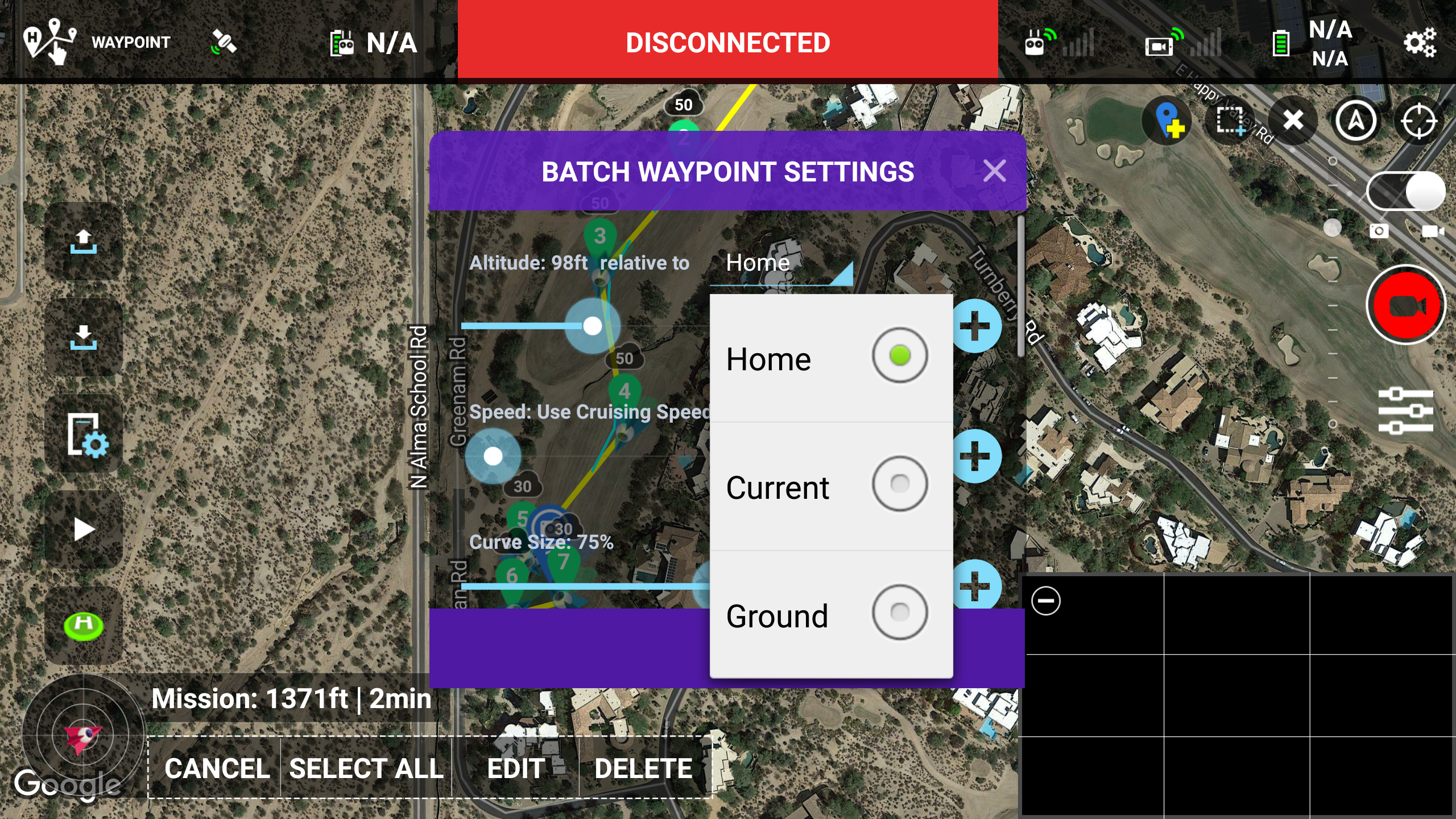

The latest version of Litchi app on iOS does have the relative to ground feature in the bulk edit of waypoints. Please be sure to have enough waypoints so your AC isn't surprised by abrupt changes in terrain elevation. Maybe it helps to think of each waypoint like a utility pole carrying a wire (ignore the catenary (sag)). If you have two waypoints very far apart, elevation rises in a straight line between the two. If the ground rises in between the two, the flight path does not rise along with it. Unless you stick waypoints (poles) along the way. Esp on the bumps in terrain.
That bulk edit you speak of, is that the little wrench that turns into a box? If so, I only get that on my monitor version of Litchi, not on Litchi hub. I;m thinking, after reading your post, i may have to update Litchi to get it on the hub,eh?
If i recall, after you load your Litchi mission, that last summary page comes up showing all waypoints as you show above, but, i don't get the 3 choices, at least i'm pretty sure i don't get the "ground" option i see on your post
Unfortunately it's not available on hub. That batch edit is only in the app

I have problems smoothly flying a path I set with the batch edit. When filming golf holes I want to overfly the tee box at 20' above the tee's ground level, roughly fly 40-50'the fairway.climb to 40-50 feet Above the ground level (AGL) along the fairway then drop to overfly the green at 20' Above the fairway's elevation then drop back down to 20' above the green's elevation. I use the batch edits to set all the waypoint to 20' above the waypoint's elevation then manually add 20-30' to the waypoints along the fairway. Instead of gradually changing altitudes between each waypoint both my P3P and P4P slow down while climbing or descending at each waypoint. This does not produce quality video footage. Can anyone tell me if this is a setting I need to change or do I need to find other software. I recall DJI Go does what I want but it will more than triples my time onsite to pre-fly each hole to set waypoints?
Do you have the mission set to use “curved turns”? Without curved turns I think it stops at each waypoint.
I did not know that about straight turns. Thanks. I recall setting one of the missions set to straight turns but the other golf hole missions were set to curved turns. Both the P4P and P3P pause at the same waypoints but not others.
