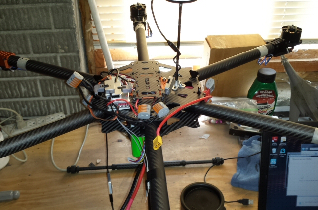

Probably won't get to it today - trying for tomorrow if the weather holds. Here is an interim picture with wires not stowed or nicely arranged and all my labels still on. All that space on top is for the battery. To get the space back, I had to fashion a battery holder for underneath - but that will be temporary. I stacked most of the basic components on the corner but if I add a gimbal, controller, GS, and FPV, there isn't any room left. Right now, the IMU is buried in the center underneath that CF battery hold in the middle. You can see the spaces between the arms but that is not for use - the arms fold into those spaces when you break it down. Like all things, it is a tradeoff - I grabbed the space underneath but I will have to give it up when I get the cross rails in. Will then have to figure out how to mount the battery near the CG without hogging all the space on top. Essentially, on a 550, you have two decks and a much smaller battery. On this, you have one larger deck but a big-*** battery that hogs it.

Finally got the Futaba rx bound to the tx and hooked up a kludge to calibrate the ESCs without using the A2 processor. Did all 6 (they didn't do quite what the manual says they would do but it was close - specifically, the beeping tones for minimum throttle were downright confusing and it took almost a minute for them to program). First time through, three motors were obviously out of cal (they would stop at mid-throttle). Second and third time through got it down to one motor. Twice more and that motor started acting normal. Did a motor bump using the administrator and they would bump at mid-position.
As a result, I think I can say they are better calibrated than when I started but I'm sure they aren't perfect.
Having blown an afternoon on this, I'm behind my desired schedule but progressing.
Something I forgot to add. The battery underneath puts the CG almost dead on the location of the IMU (which is in the center hole of the 810). Only CG setting I had to modify was the GPS which is 6 cm aft.
