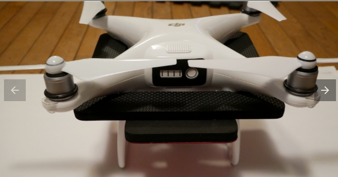

After loosing a phantom in the water , you come to realize quickly that having a back up plan is critical.
If your going to fly from the boat , there our circumstances that our going to challenge you that you cannot possibly for see..
Trying to rely on other people that our not really familiar with your drone can prove to be a disaster.
Once you know that your phantom will float , your less likely to PANIC which is the cause for most boating incidents with your drone.
Recommend you get the Phantom Rescue Ring, and take that stress away, you will be able to make much better decisions because of it.
If your wondering how it flys, you can check this video out.
