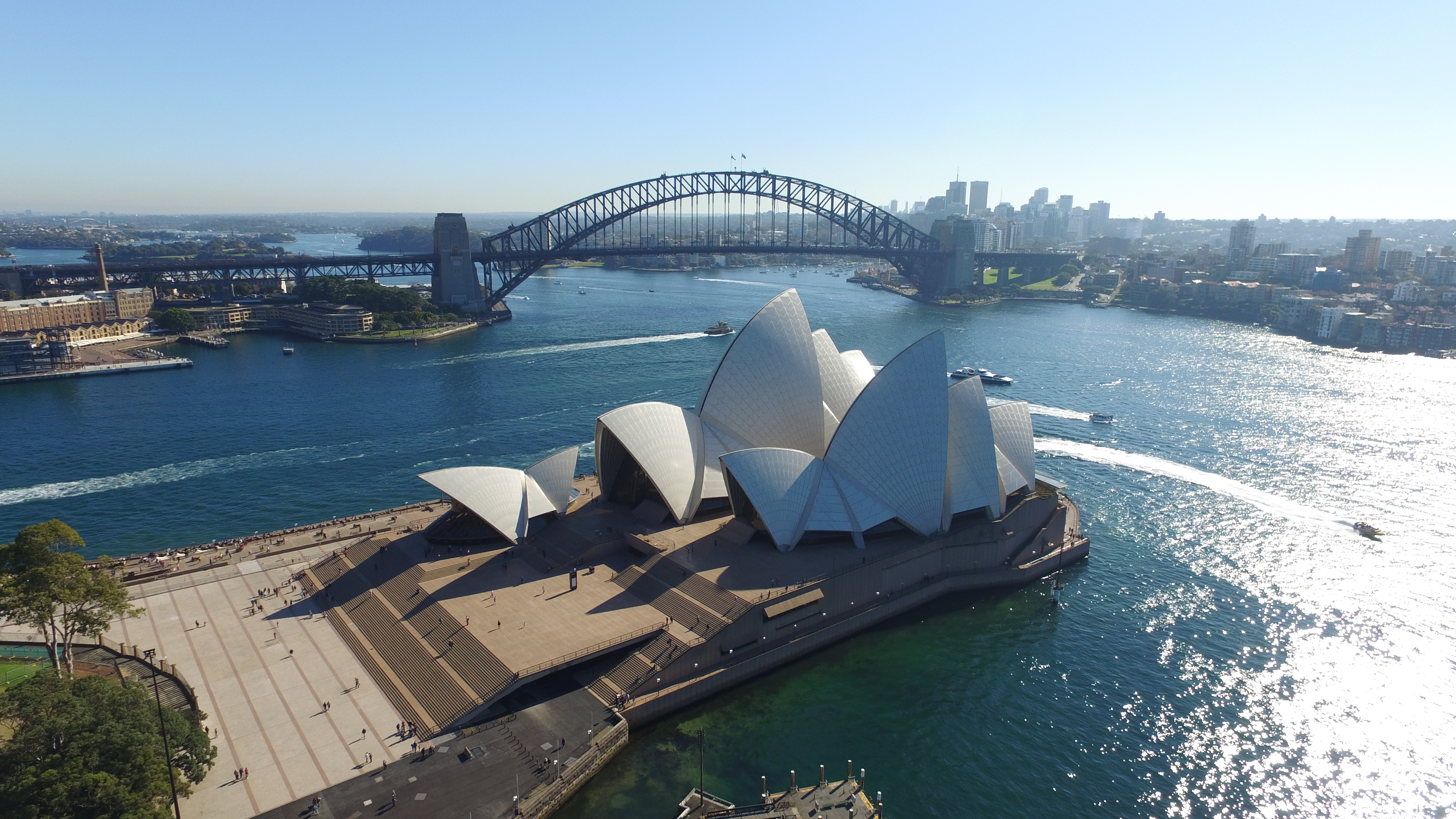

Hi Guys,
What filter would u think would work best in this pic?
I had trouble getting a good balance between the sky and the ground.
(And before anyone make a comment about how this pic was taken? It was over the water all the time and never flew close to any buildings / People. ) :)
Thxs Chris

Nd/cp would do fine I think... Srp has them but they cost a lot more than the taco rc... But you get the highest quality filters in the market.

I think you are talking about the graduated ND filter. We are planning to produce one.
