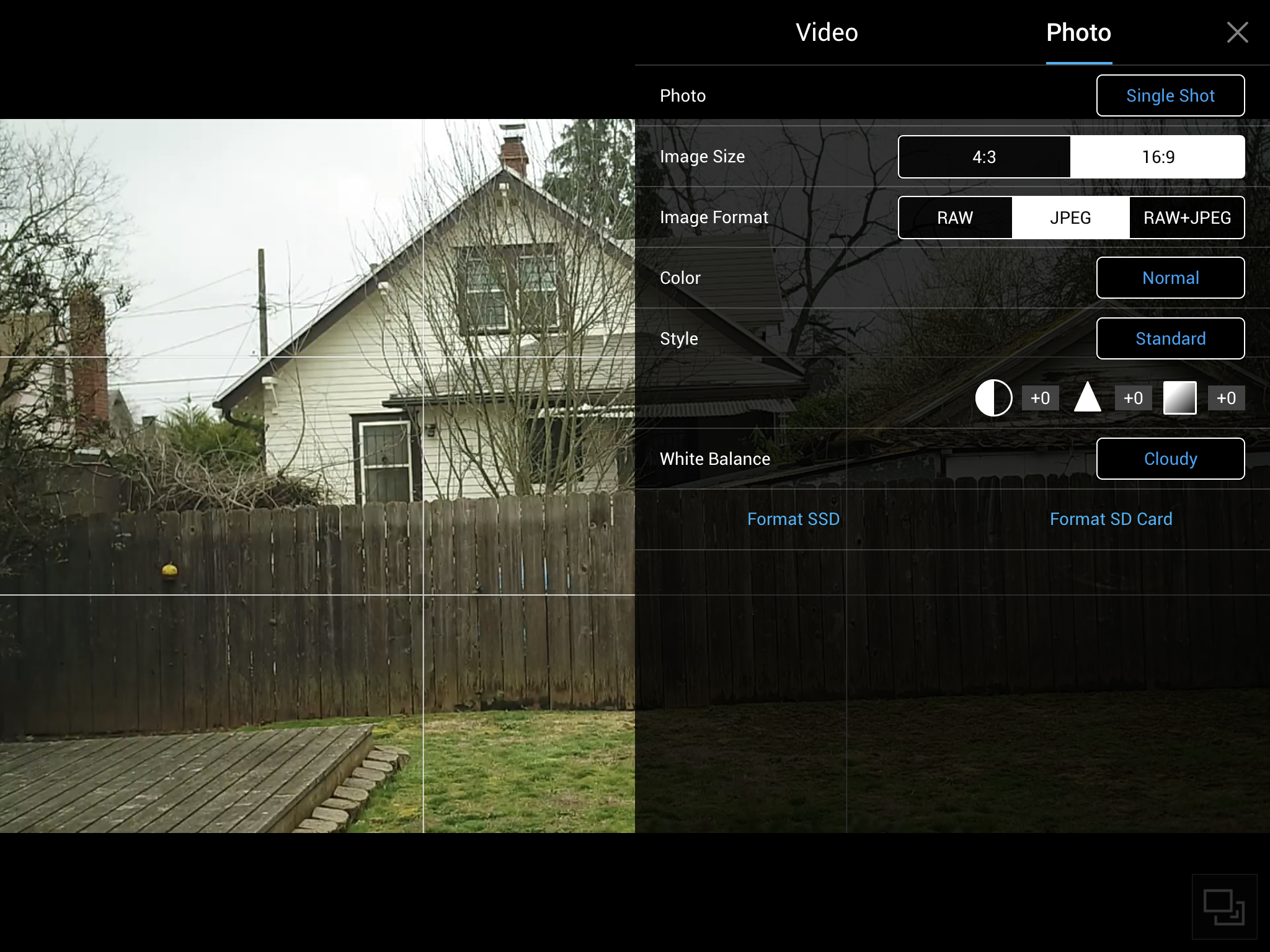

My screens may look slightly different than yours, but it should be pretty close. Since I'm not sure what your skill level is, I went through all the steps.
There are lots of ways to set up to shot photos, but here's one to try if you'd like.
First set up your camera this way and using JPEG, Color=Normal, Style=Standard. For White Balance, keep it simple. If it's sunny out then choose Sunny. If it's cloudy then choose Cloudy.

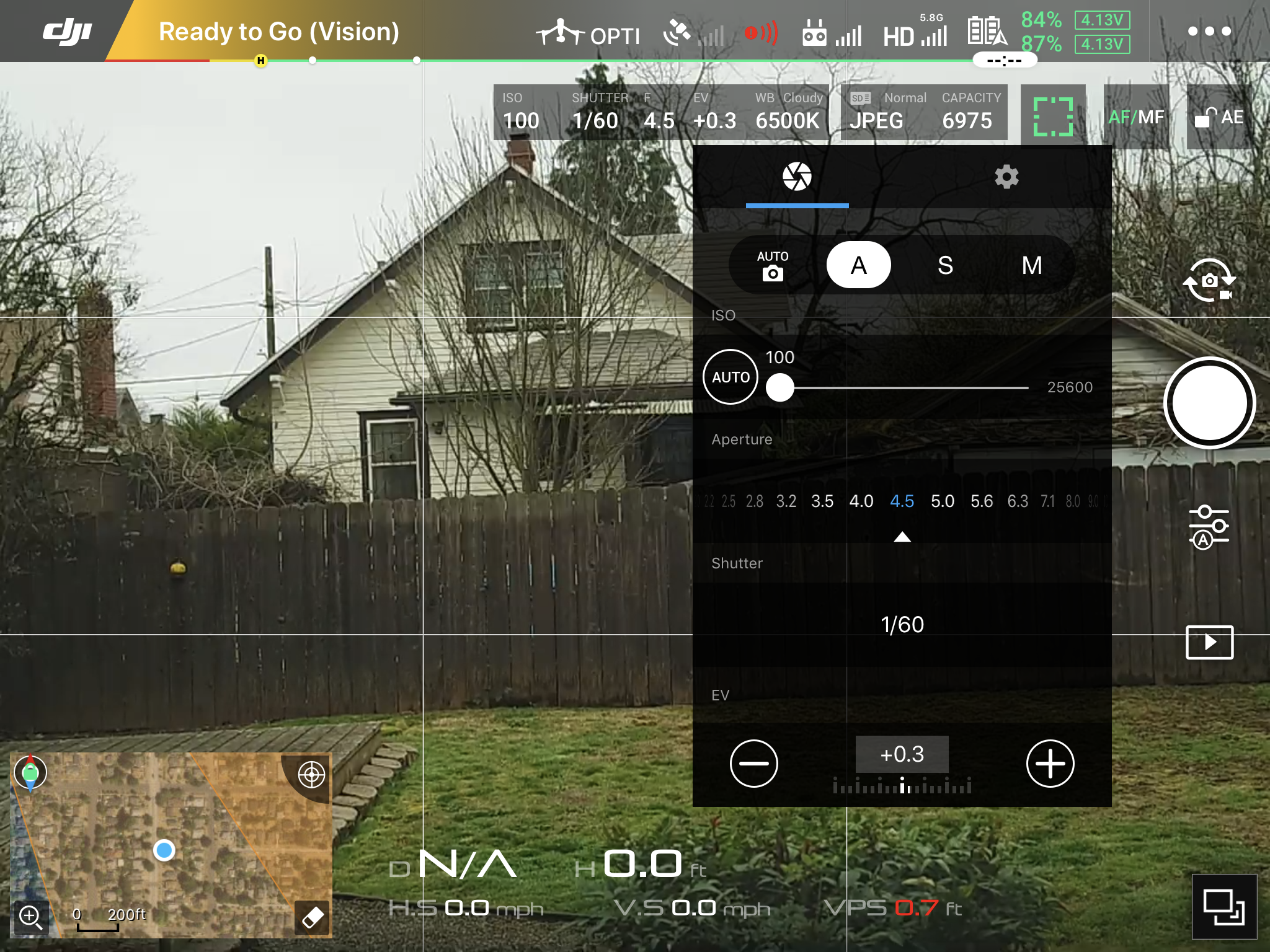

Now in the Camera window, select the A (aperture priority). This means you'll change the aperture and the camera will change the shutter speed to match whatever you've set the EV to. In this case, I've set the EV to +0.3, which is slightly overexposed. In your case, set the EV to 0. You change the EV by clicking on the + or -. Now that you've set the EV, you can slide the aperture back and forth until you get a shutter speed you want. I typically keep my shutter speed above 1/30 and keep my aperture between f/2.8 and f/6.3. And again here is someplace for you to explore. The other place you can adjust is ISO. By setting a higher ISO, it will increase the shutter speed. Remember that the higher the ISO, the more noise you'll have in your photograph.
109920
Next, make sure you have the focus mode set to AF and click on the screen where you want the focus to be. Now take your picture.

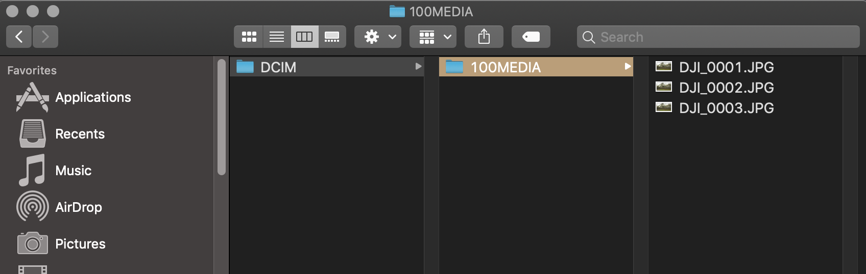

Now you'll want to take the MicroSD card out of the drone and put it in your computer's card reader. It'll look like this.
109922
This is where you'll find your JPEGS. I'm on a Mac so if you're on Windows, it may look different. I'm also sending you links in conversation that I think will help you as well. I hope this helps get you started and let me know how it goes!
