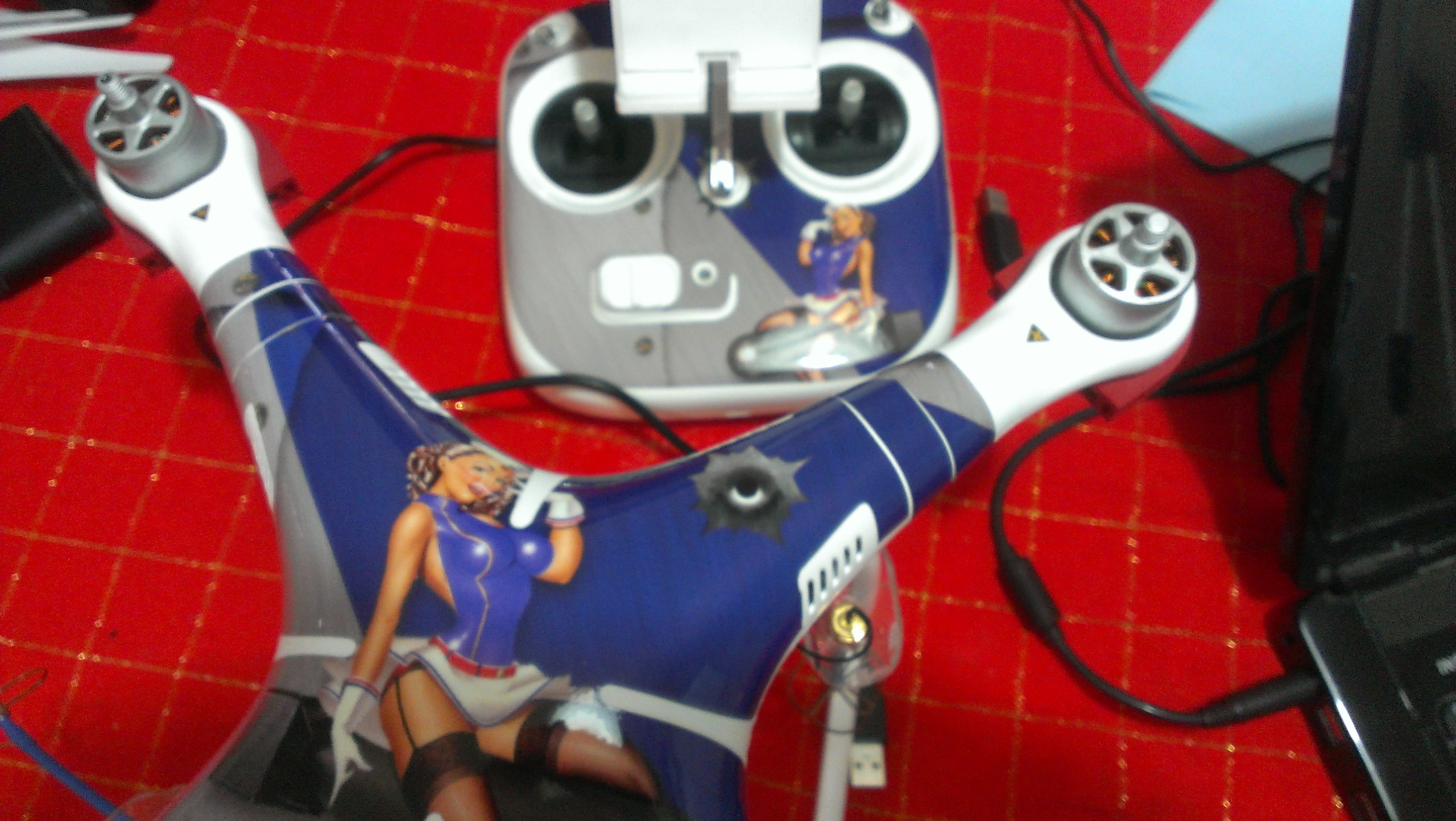

Ive been draining my funds and time for XMAS, BUT, I did add some cool graphics. This decal really isn't for the Phantom Standard 3 but I think it still looks cool.Next up will be to move the 2.4 ghz antennas over to the new/latest RC and test. Merry Christmas to all you Christians out there and to everyone else have a good extended weekend.
