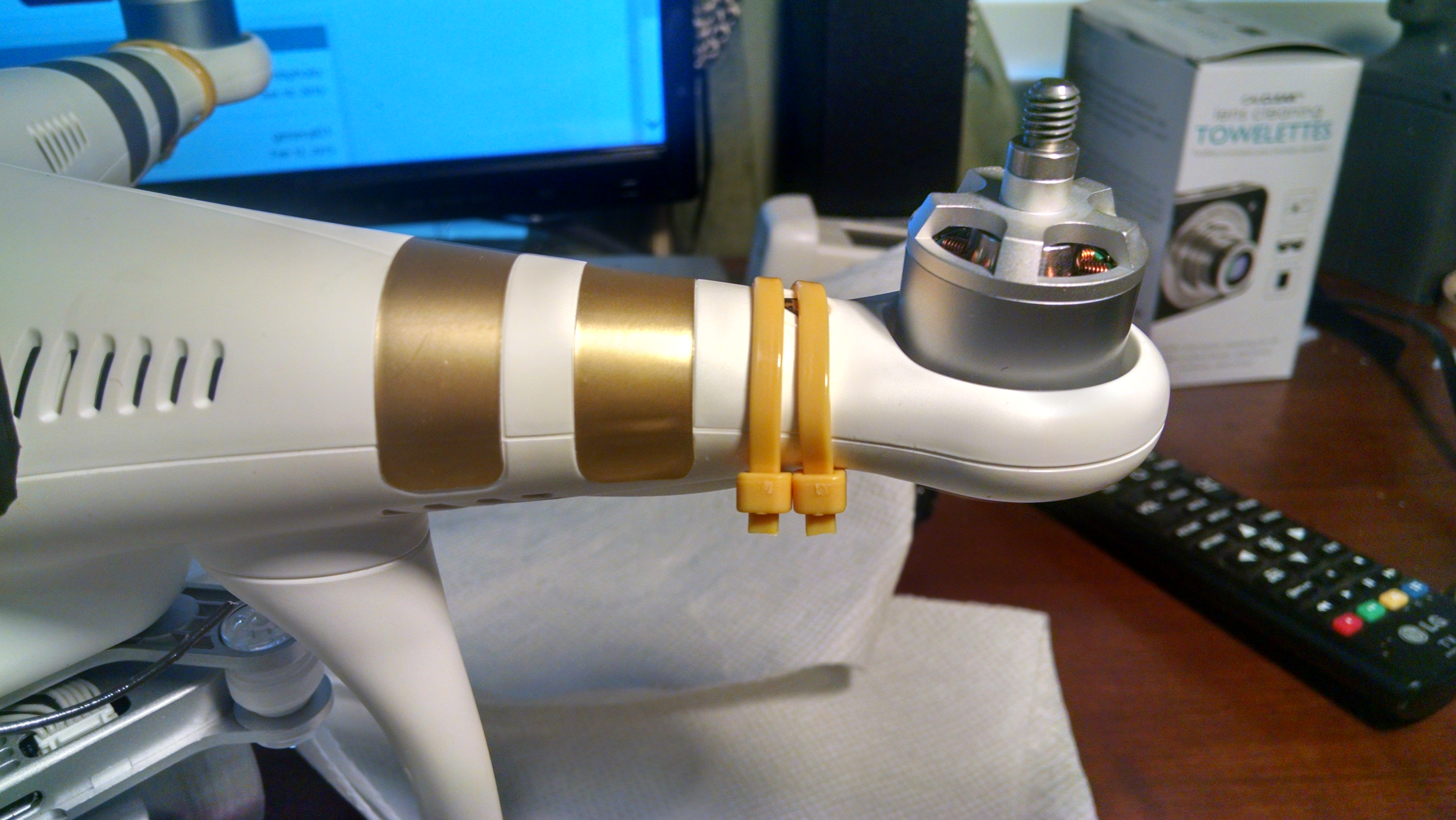

I like your use of felt below the zip tie. I didn't.View attachment 24865
I put the felt there to try to avoid marking up the shell when I cut off the zip ties. I don't have any cracks yet but when they do come (or I sell it) I want to send it to DJI without any marks. You'll be fine without the felt though, just need to go slower cutting the ties off.

I like your dual gold tie method, it really "ties" the whole phantom together. We should get a sticky started showing off custom zip tie applications. Custom zip tie paint jobs, etc. ;)

No need to cut zip ties. Just lift the small tab with a knife or small screw driver.

Adding a zip tie is no different than adding a gimbal guard. It's just something to protect your investment so you can keep flying. No need to send your unit in for repair unless you just don't like looking at those cracks :)
