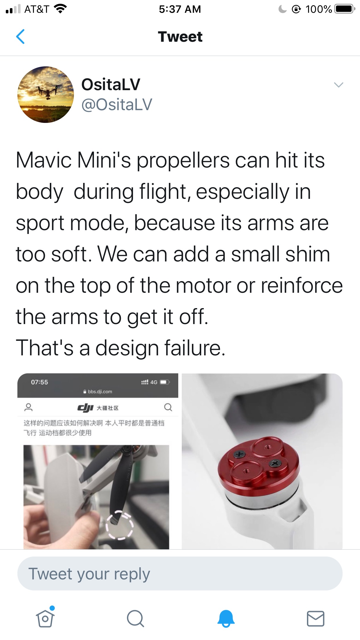

This just come on emails..

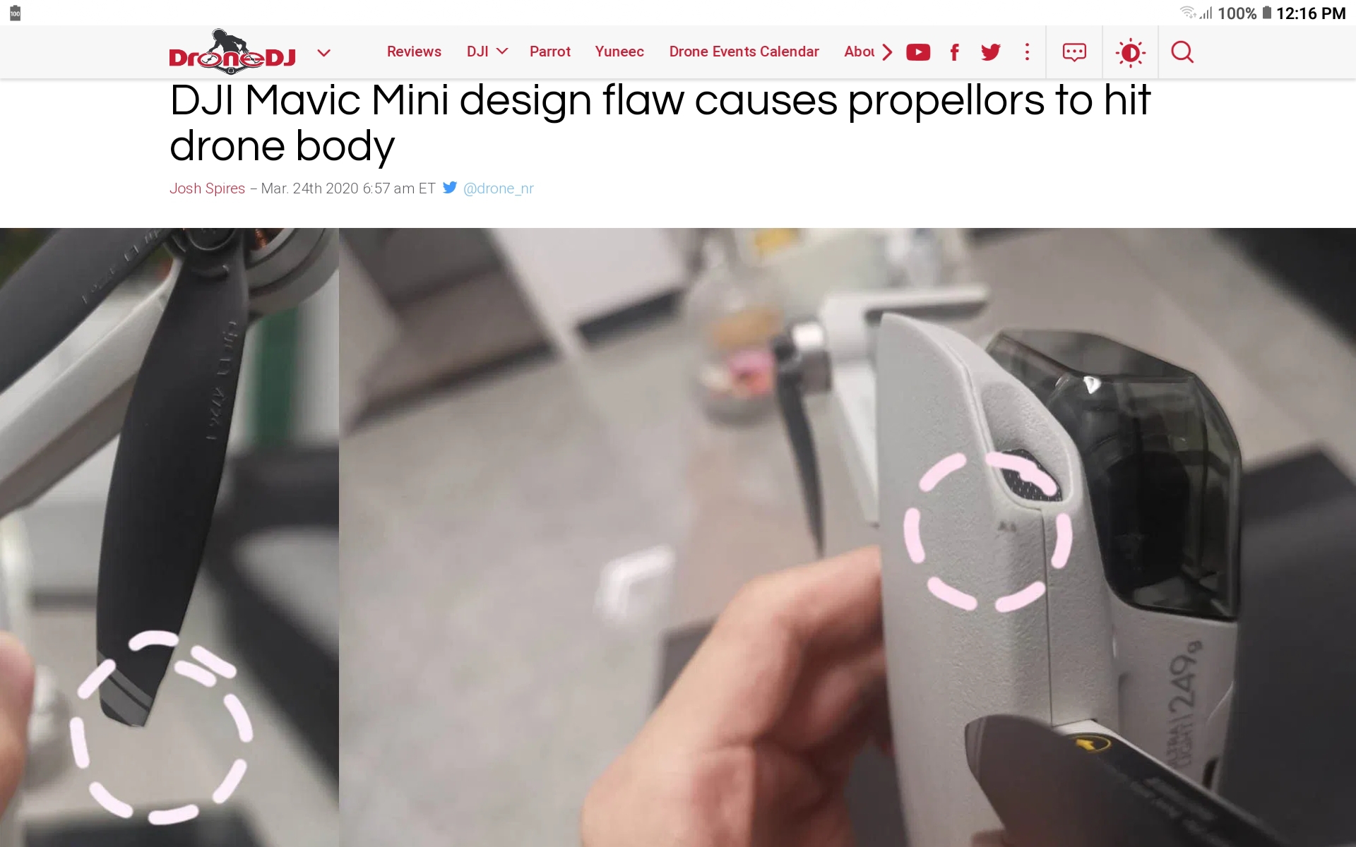

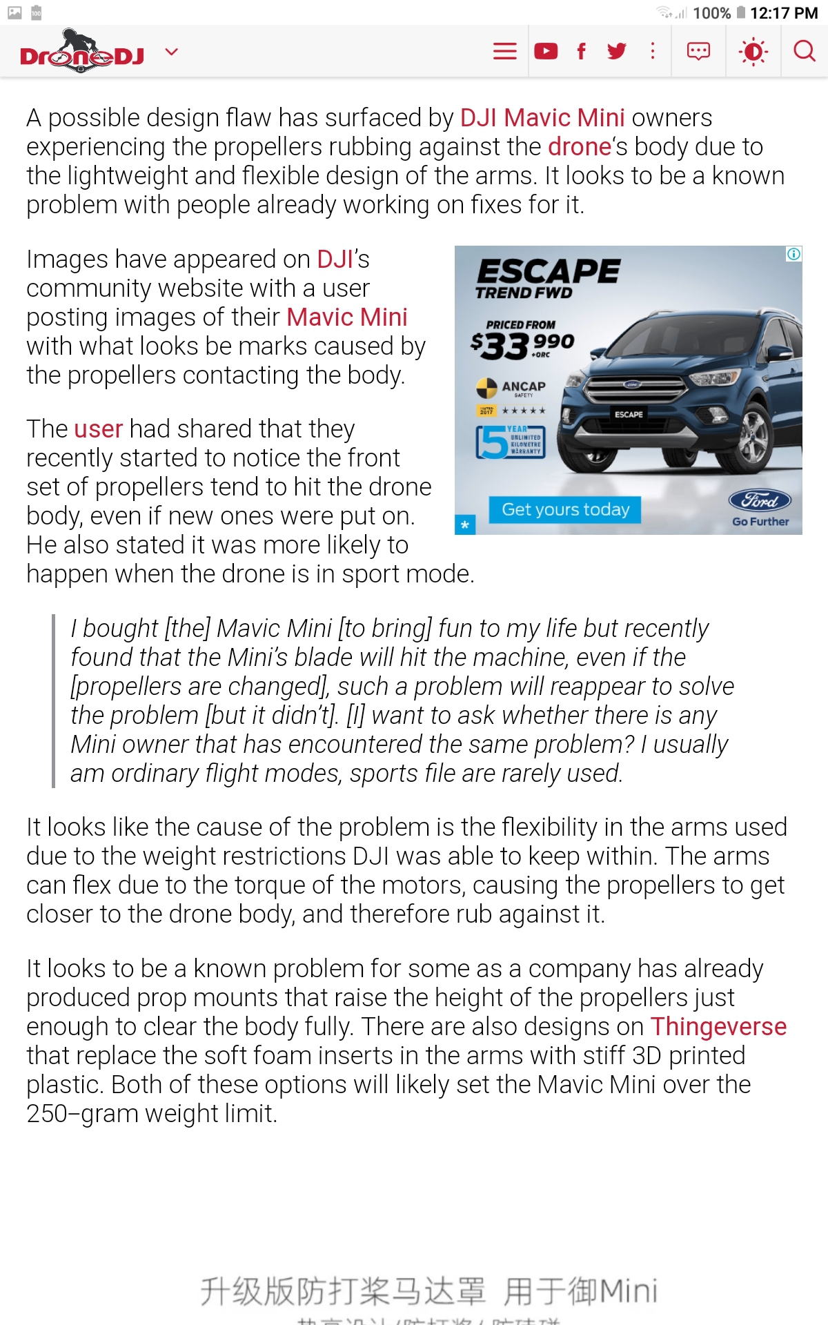

This has been discussed at length in mavic and some are
doing mods to firm up the arms,some have added a cap
between the motors and props on that to raise them and some like Starz have sent them back. I have not had that
issue with mine yet but not saying I won’t .
From reading as much as I do it seems I see owners that
use sport mode have this more than others. Might not be the case but just what I have observed.
Biggest issue I see with it is new flyers getting them and
not understanding it just dont take wind very well.
They go out to far and get a headwind coming back and
it will really slow down and then the battery gets low
then panic and they lose the bird.
Is nonstop threads with it. I did get a tweet from this guy I follow yesterday about it but we already knew it.
I think a better fix rather than adding shims would be to release stiffer props, or maybe check out master airscrew and see if they have any better props for the mini.

Props are not the problem the arms are.

That's not the only problem with the mini but it is a biggie. Also the bottom sensors have a hard time when flying low over water, snow, sand. Can cause uncommanded descent. Also has some other weird glitches (lack of power to the rear motors) have also caused uncommanded descents that have been covered under warranty. Still working out the bugs. I bought 'Care Refresh' anyhow.

My mavic air did the same thing when I first flew it. These smaller drones with the foldy-arm things seem to have this problem. I bought a new set of props and it hasn't done it since.
