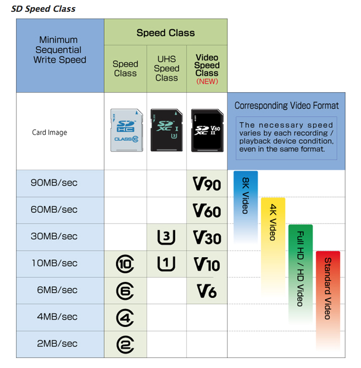

It may work OK on older drones, the newest seems to require a fast U3 card.Excellent info and thanks for sharing.
een using one of these shooting 4k and seems to work fine.
If you poke around that site I linked you will find an SD card tool that is a free download. I use it for all my SD cards. Lots of good info on that site.OUTSTANDING INFO! I have been buying my cards based on the number in the circle and never looked at the U number. Thanks!

Can you get more than 5mins of 4K (100mb/s) video on that card? That’s all you would get at 100MB/s.... It’s bits, not bytes. No question.The Mavic Air writes 4K video at 100MB/S...your card needs to be greater than that.. I am using the new Amplin 32GB SDHC UHS-11 U3 V30 Class 10 1900X 285MB/S..look at the picture and read the chart...View attachment 103882 View attachment 103882 View attachment 103883
That's correct.Can you get more than 5mins of 4K (100mb/s) video on that card? That’s all you would get at 100MB/s.... It’s bits, not bytes. No question.
Simple question was- can you get more than 5mins of 100mb/s if video on that card?Capital MB/s=bytes....not bits...Google the definition of MB/s...fact check your opinion as other people may think you know what you are talking about and promote incorrect information..Thank you for you input
With respect sir, you are the latest of many who have been confused by the terminology.Capital MB/s=bytes....not bits...Google the definition of MB/s...fact check your opinion as other people may think you know what you are talking about and promote incorrect information..Thank you for you input
Careful.... You might become another promoter of false facts....With respect sir, you are the latest of many who have been confused by the terminology.
Most are also confused between read speed and write speed, though it appears you understand that aspect.

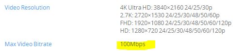

Of course, the truth is that a Mavic Air has a max birtate of 100 Mb/s. That equals 12 MB/s.
Your welcome- knew you would get there.... That was my intent in giving you a practical example. Let you perform your own fact check so to speak absent attitude and unnecessary agro.WOW...I am totally wrong...Mavic Air = Max Video Bitrate100Mbps..that is bits not bytes..Thank you all for taking me to school..I am now less IGNORANT>>>
