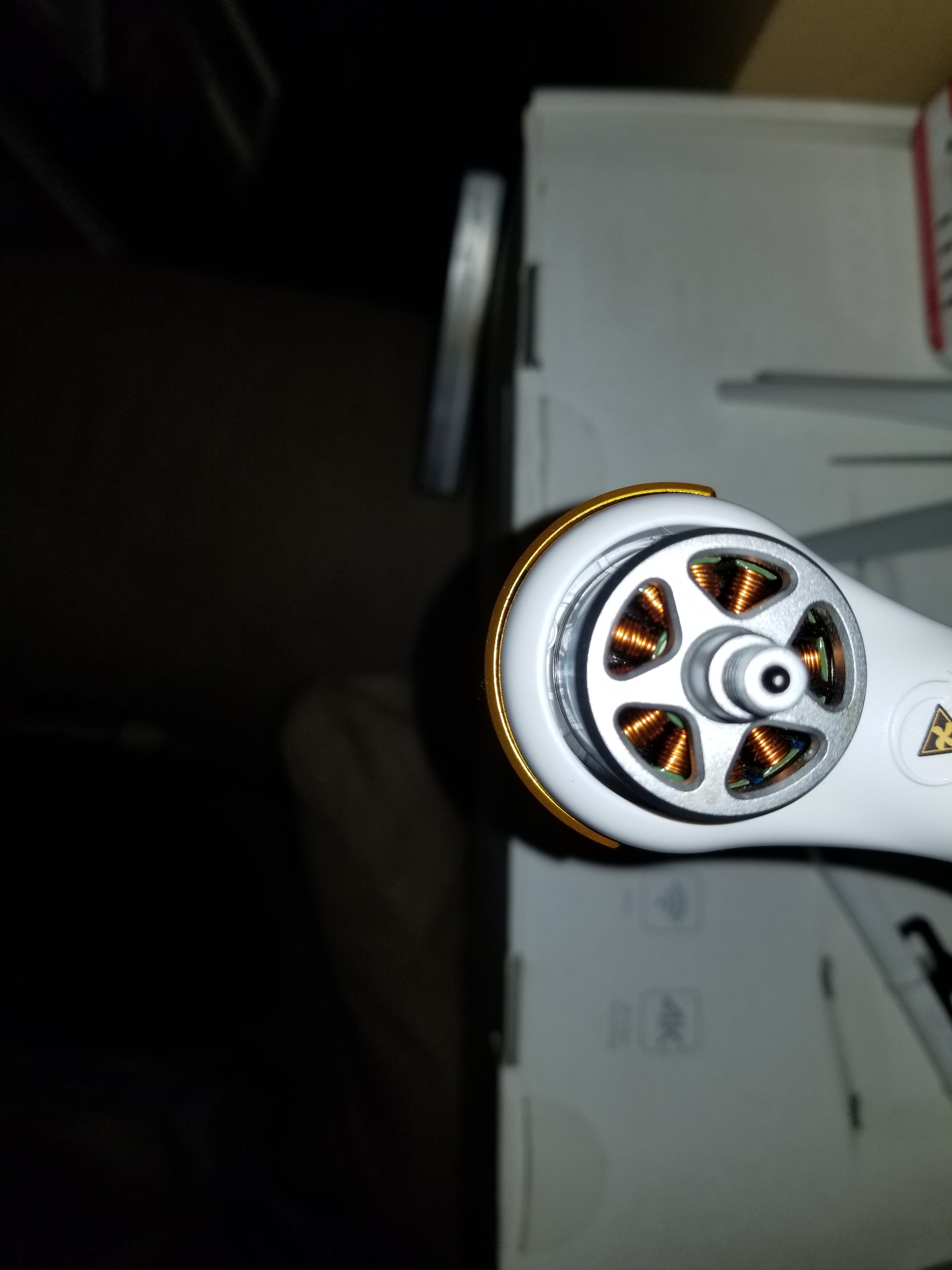

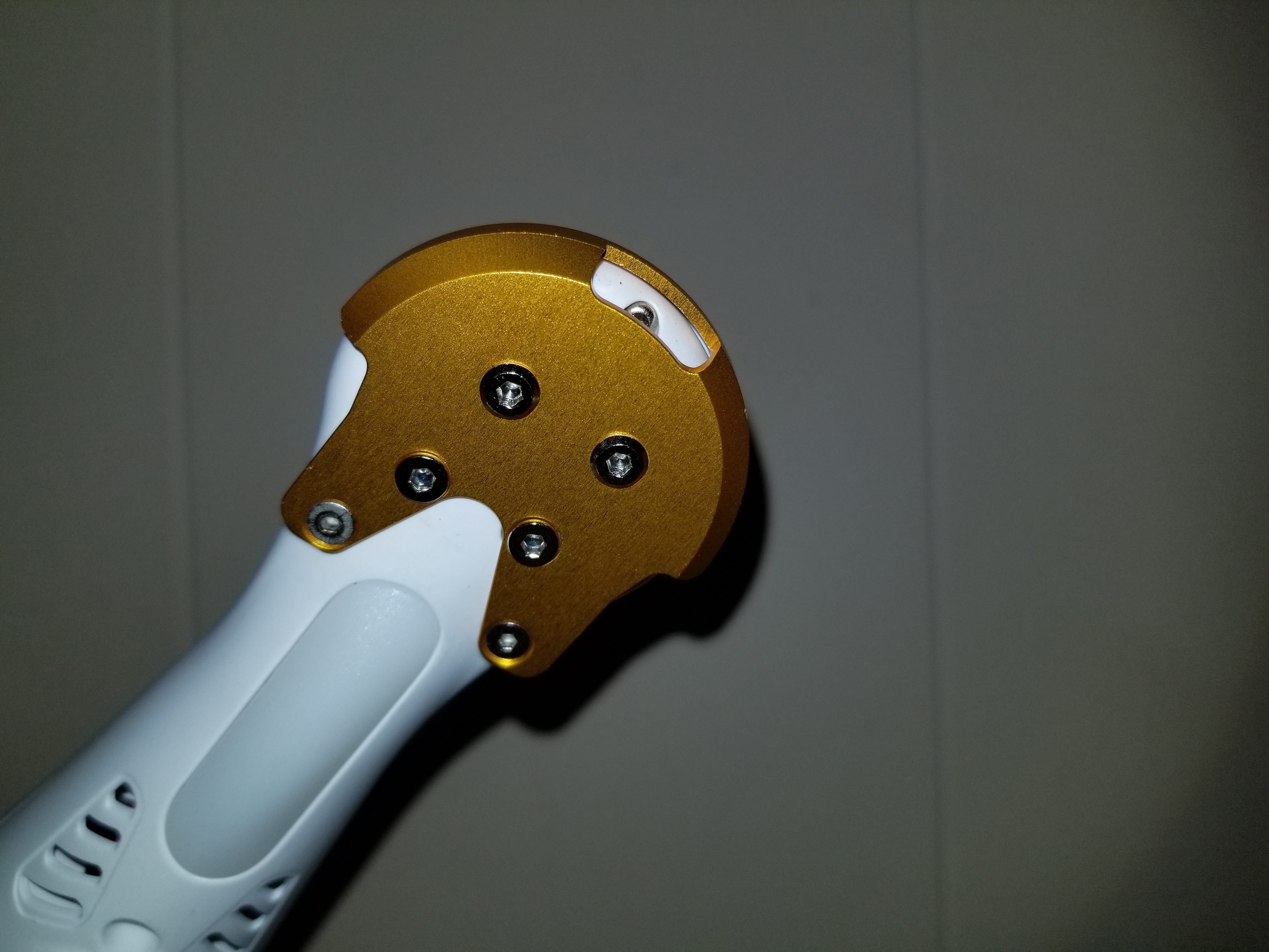

found a crack in my p3s less then a month of ownership used a tiny jeweler file in triangle shape files a V groove along the crack repaired with epoxy and sanded smooth installed these plates in and rechecked a month later no new cracks and existing crack still holding. with some Loctite products its not recommended for plastic 425 is what I use and is said to be plastic safe. My buddy used gasket sealer on his and they are holding very well with that product. I have in the past used nail polish but that can also be a problem with plastics the trick is to wait till it skins over and install the screw. one of the problems with these products is the mentality that more is better that's a false hope. There is no need to glob any of these products on the threads. a tiny drop then shake off the excess so its level with the threads is all you need.
let me explain what's happening for those who don't know. A screw has peaks and valleys a Nut also has them the screws peaks fit into the nuts valleys there is a tiny amount of space for fitment purposes between these peaks and valleys as they mesh together. when a product like Loctite is used it gets squeezed in the space between the peak and valley and it tries to squeeze out but cant so it takes the path of least resistance which it up the threads of the screw, so as an example a tiny drop on 4 threads will work its way up to cover 8 threads by the time the screw is tight.
here are the brackets I use the seller has them in bare aluminum also and in spite of some of the reviews the screws I got with mine were perfect length .https://www.amazon.com/gp/product/B071LFF4LL/ref=oh_aui_detailpage_o09_s00?ie=UTF8&psc=1

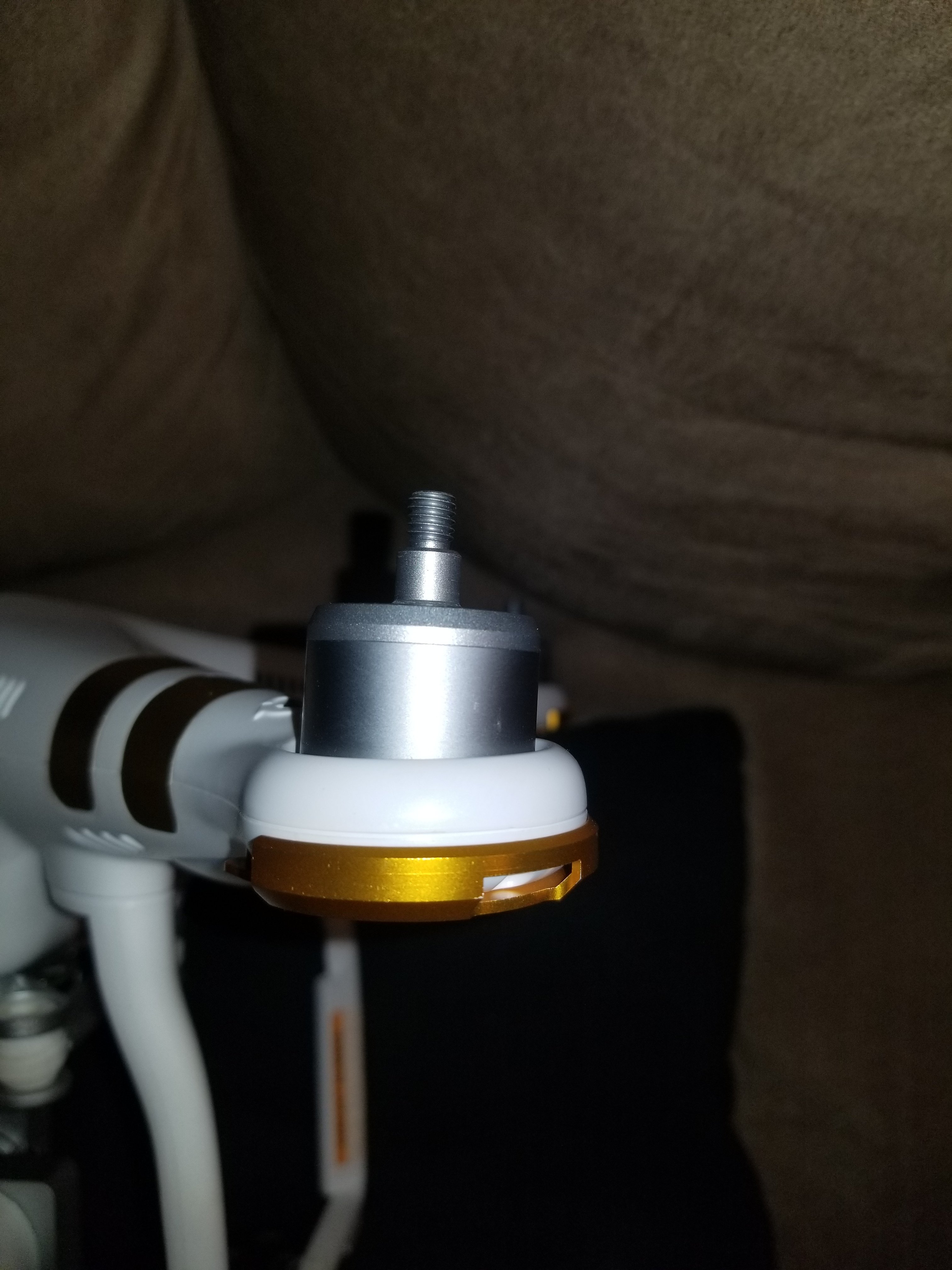

here they are installed on my p34k so you can see they don't take up hardly any room maybe a couple MM's
