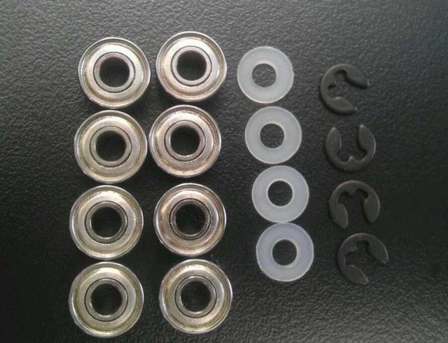

    I use this KIT, check around if you can get in UK. They are great and not standar chinese:
    http://www.ebay.com/itm/DJI-Phantom-hybrid-ceramic-bearings-extreme-high-speed-highest-quality-available-/261258097528?pt=Radio_Control_Vehicles&hash=item3cd4323378
    [​IMG]

    That is not a bad price for a ceramic bearing kit, and it already includes the nice thrust washer, and beefier e-clip.

    Just a warning, when replacing the trust washers with your new bearings.
    I had to sand down two thrust washers because they were too tight to get the e clips easily into the slot. This is a quality control issue as I noticed the originals had different thickens small brass washers. So I had one fly apart because I had not seated the e clip properly, luckily only three metres up when I gave it full power. I have had two bearing get noisy after about 4 hours, one has been replaced the other will soon follow. I bought them from the States but will not name the supplier yet as I have asked for replacements. They failed with fewer hours than the originals. Warned!!
