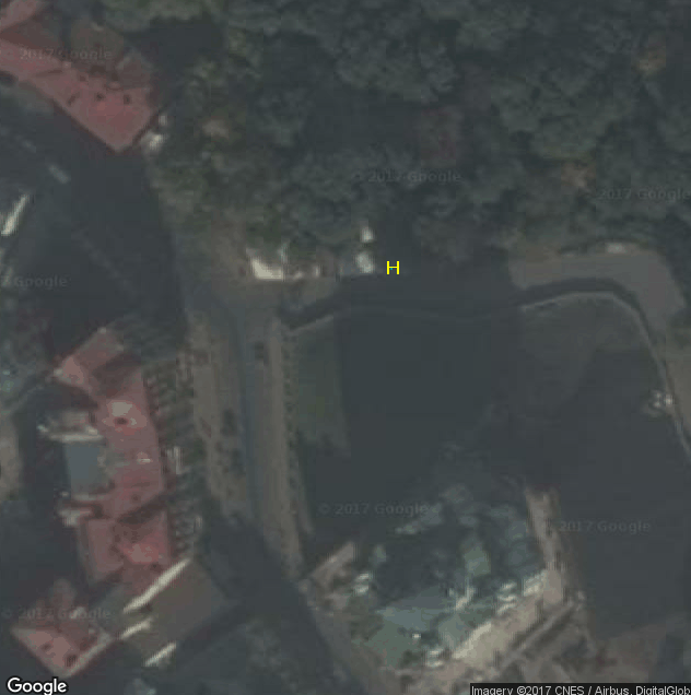

The Home point was set. It's here
The reason setting the Home point wasn't announced in the .txt is that it had already been set when the .txt started recording.

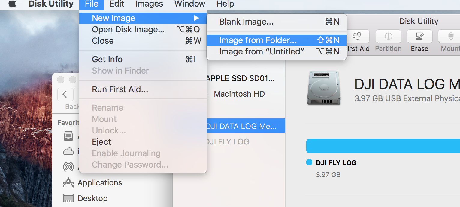

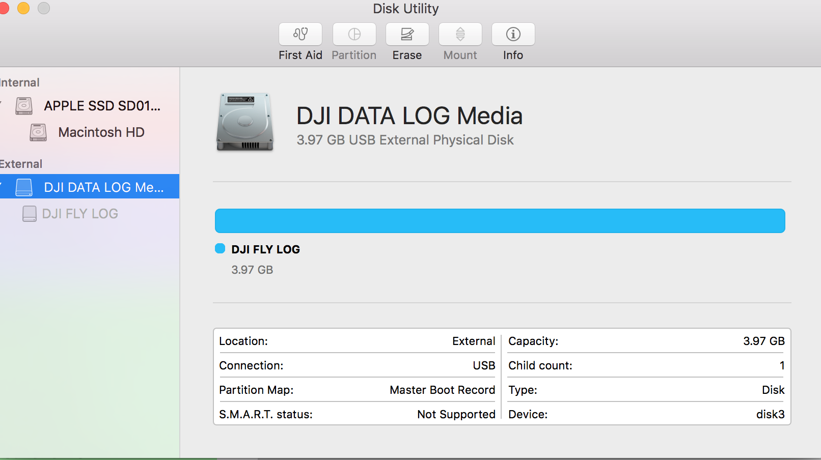

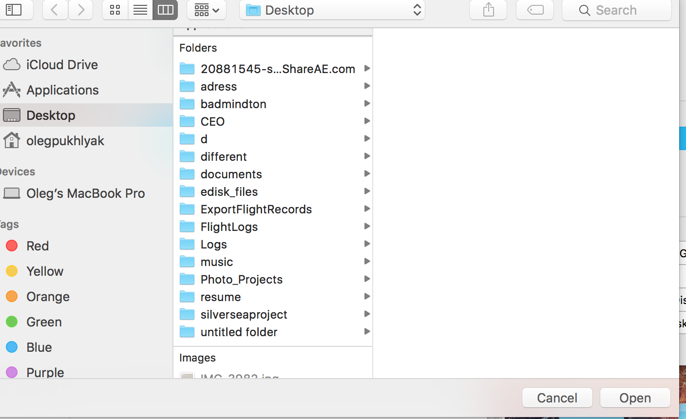

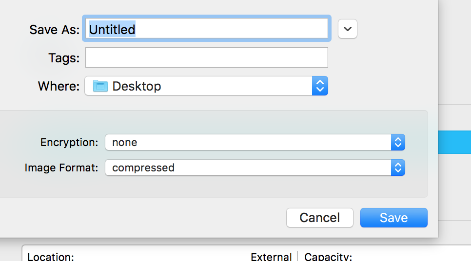

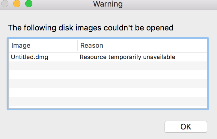

@BudWalker Thank you for advise thus I have difficulties to do so, can't understand what I do wrong, everything goes okay until this step
"Using Disk Utility, select the SD card and create a Disk Image of the entire Phantom SD card saving it to the hard drive. To do this, select the SD Card, then File>New Image>Image from Folder. Save the file to desktop.
After it has completed open the Disk Image as any other folder and save the enclosed .DAT files to a new folder for viewing."
1. I open Disk Utility Screen Shot 2017-11-24 at 8.42.48 PM.png and select DJI DATA
2. Then as said in instruction File>New Image>Image from Folder Screen Shot 2017-11-24 at 8.44.39 PM.png
5. Uploading image and its throws warning Screen Shot 2017-11-24 at 8.53.14 PM.png
please help if you still have patience with me.
