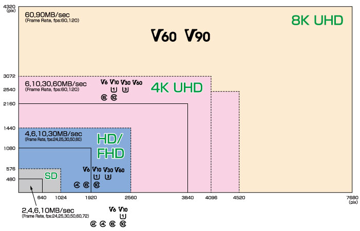

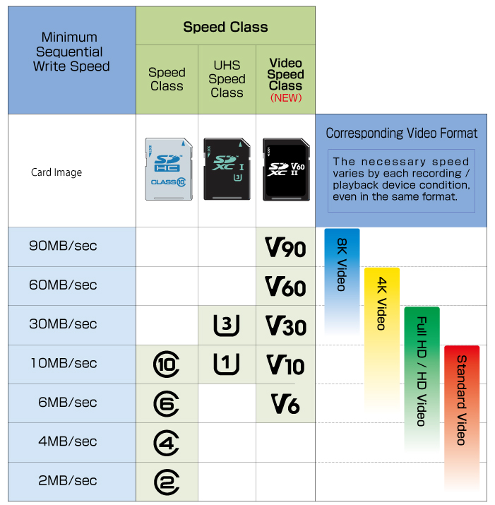

Source of figures:
Speed Class Standards for Video Recording - SD Association
The fact is, that with P3SE the UHS-1 card with measured 27MBs write speed has many frame drops.
UHS-3 card with measured 40MBs write speed is a lot better, but if camera turns, or fly on low altitude recording has frame drops as well.
(These are the scenarios, where the picture change dinamically, and data compression become less effective)
Of course cache can hide this changes as long it is not full. But when it is full the effect is really annoying, parts are deleted from cache, picture has big jumps.
Based on recorded file sizes it's clear, that DJI's claim is wrong. If you do the matematic (one minute has 60 secons ;) )
even the average data speed is over 60Mbit/sec.
Based on my experience my promise to other P3SE owners is to buy sd card with capablity to 60MByte/s write speed, if they want to record good quality 4K videos.

According to your chart posted UHS 1 class 10 is adequate and for many (me included) no issues are experienced. I don’t do 4K at 60fps so perhaps that might reveal an issue. The caveat might be cards that only just qualify as UHS 1 might struggle (as you claim happened with the Kingston). I very much doubt the P3 SE exceeds 60 Mbits max data rate- DJI would say if it did. More is better.
