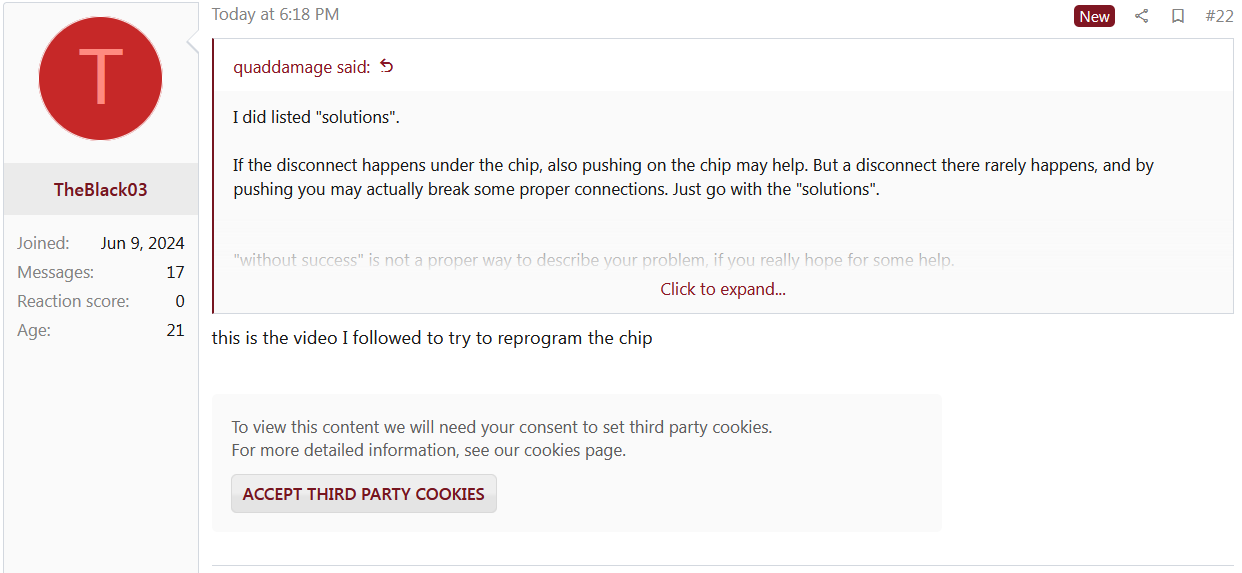

this is the video I followed to try to reprogram the chip
I can't see the link:
It's your video, I recognize your voice haha I added an h to the url so you can see it hhttps://www.youtube.com/watch?v=WGHUZOMq2w0
It's your video
