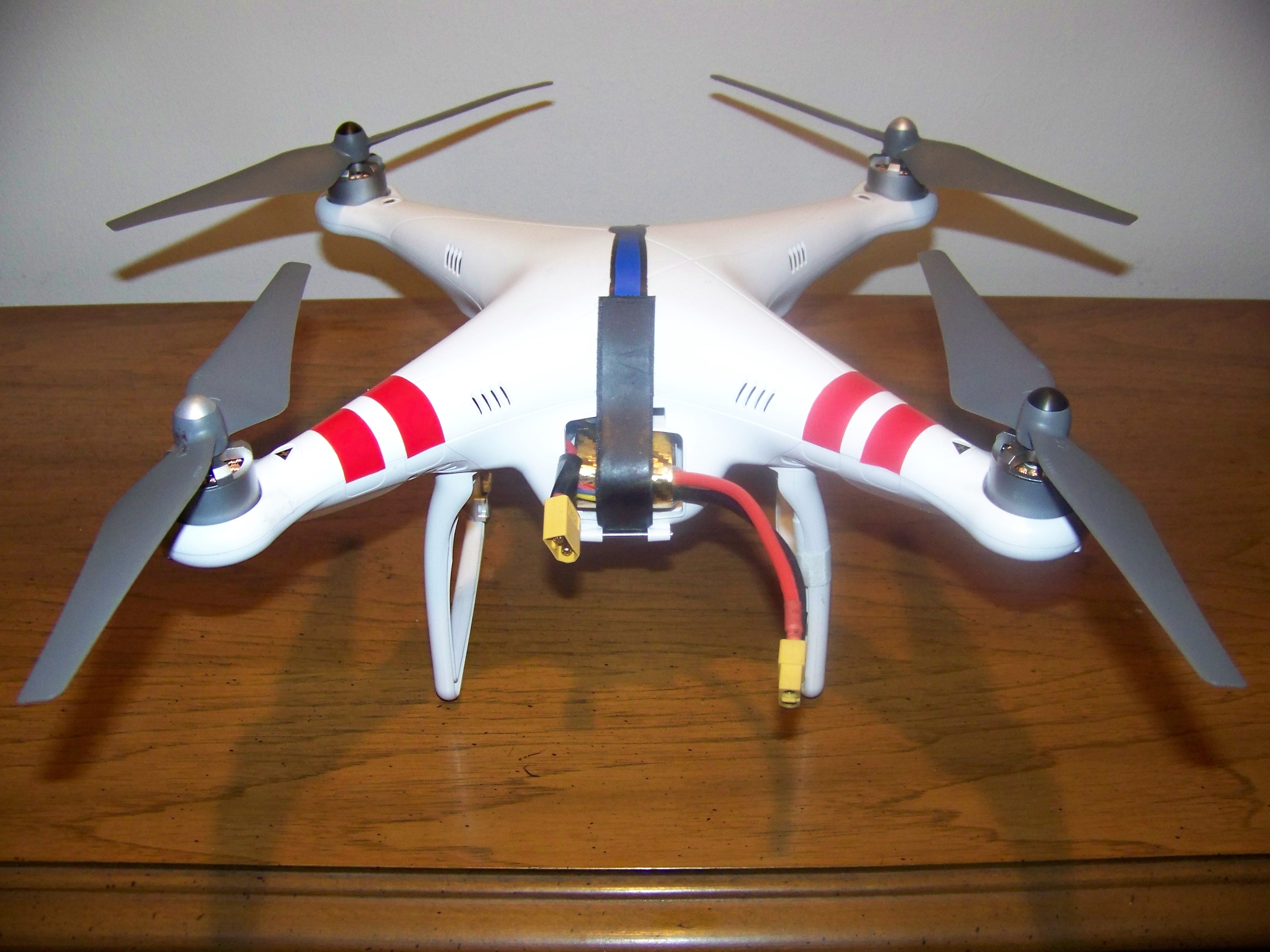

Instead of trimming the battery door I just removed it and use velcro to secure the battery. I prefer this to trimming the door and shell, it takes alot of stress of the cables and connectors.
Instead of trimming the battery door I just removed it and use velcro to secure the battery. I prefer this to trimming the door and shell, it takes alot of stress of the cables and connectors. View attachment 18866
