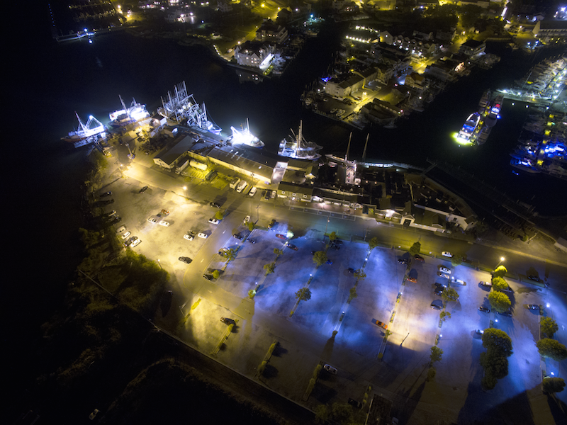

    You can definitely get interesting photos. I usually set the ISO to the lowest and the shutter to 3" seconds or so. Only works well when there's little wind.

    Cool shot. I am a big fan & participant in night photography. Planning some DSLR star scapes in the AZ desert in a few weeks.

  16. Great picture az116!!!
    Good idea as well to switch ISO down. Will wait for a mild breeze;-)
