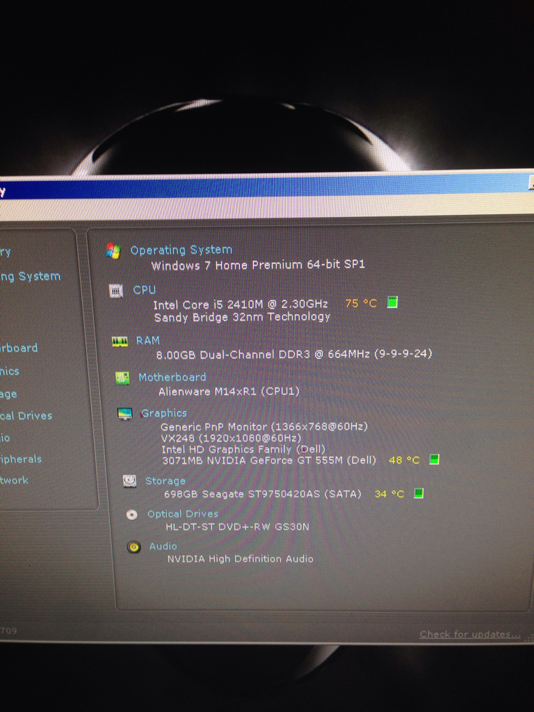

Something like this?

I just did a factory reset. Then installed all updates and drives. Also set it to best performance option.
8Gb is fine on my machine - something is hogging your RAM!!!
When I open task manager it says 20% cpu usage and under 10% ram usage. I'm going to try and uninstall and reinstall the drivers

Is your system using the intel video or nvidia video....go to nvidia.com and download the drivers for your nvidia card.
Your system is more than capable for playing 4k video as I have a laptop with similar specs that plays the 4k videos perfectly. Right click anywhere on the desktop and click on the Nvidia Control Panel. Go to Manage 3D settings and under "Preferred graphics processor" select High-Performance Nvidia processor. That way applications will be forced to use the Nvidia GPU and not the integrated Intel one. Try and see if that helps.
