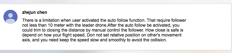

Update: Have been speaking with the owner and one of the developers here is what I have learned.
As of now this IOS MAC related software you need the Ipad or the Iphone :{ No Crystal - No plus controller will work
The Minimum follow distance is 33 ft however once activated you can adjust the position closer using the controller .

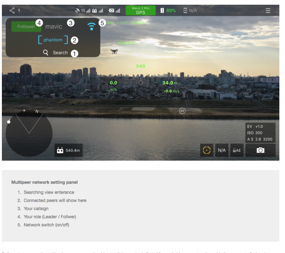

After you install on both drones you activate the wifi icon as the follower and click search which looks for the leader as the other drone., than the Auto Follow Function button pop up.
If anyone has a video , please post it, meanwhile I have to go buy an Ipad.
