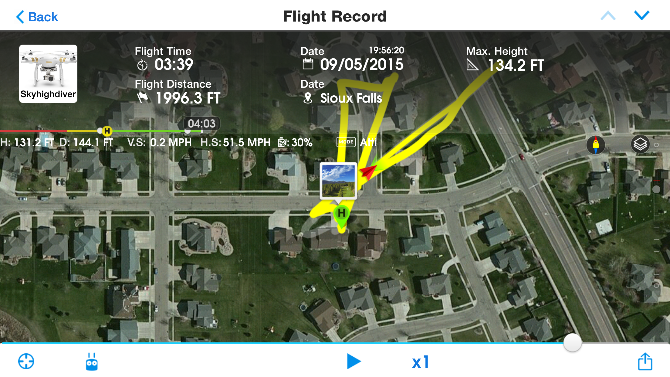

I'm a member at inspire pilots and have been thinking about getting the p3, and joined the forum specifically to ask if the phantom supported flight record in the user section of the app. This pretty much answers my question but just to be sure, you can play that recorded video, right?
