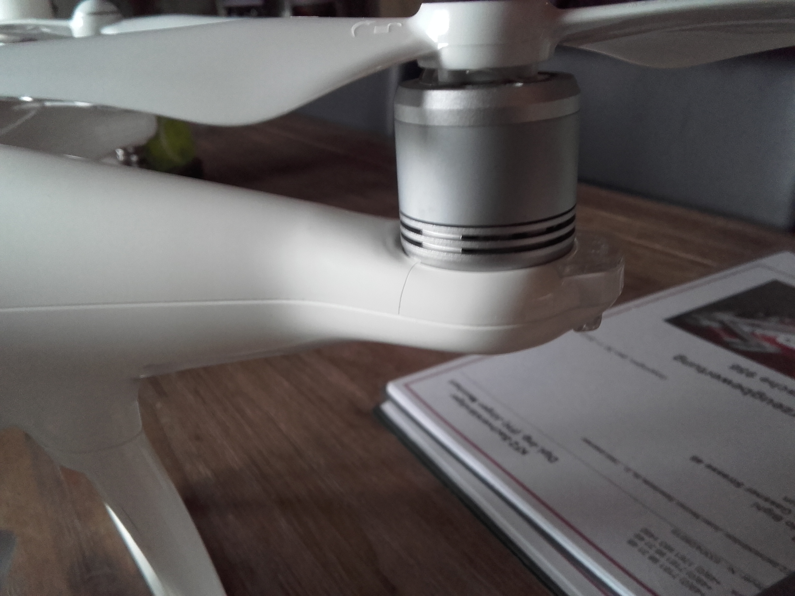

So, after putting my P4 under nice light I'm wondering if this is a crack? It looks like it but the surface feels smooth? I've flown it 2 times with kit gloves.
I also have this line under my right front propellor, I've checked it with the dji reseller in my country, and every phantom 4 he have is with this "crack", so it most be mold

From what I gather at this point the picture I posted is that of a mold mark. Some others have reported having the same marking as well.
Some news folks. I sent the cracked P4 to DJI in Europe and it should be shipped back to me in a couple of days. Completely free of charge. That's the good news. The bad news is that I've been flying a brand new spare P4 and just an hour ago DJI go said updates required. It was for the controller. After the required restart the controller got bricked. So I guess I'll have to send that in as well. While I do have a spare controller, it's four hours away at my other apartment. Sucks. But anyway, DJI is covering these shells as well.
View attachment 55851 Here it is folks. My first phantom 4 stress crack. It did manage just over 120 flights which is a lot more than I ever did on any previous generation phantom before this happened. Lucky for me I bought a spare which until today I thought I would never need. Looks like I need it. Lucky for me it happened in one of only two days I will be home for the next month or maybe two. While I slowly built up a lot of trust in the phantom 4 shell, I still ordered a spare phantom 4 out of habit. Oh well. I have to admit, 120 high and far flights is a lot more than I managed on any prior phantom before a crack showed up. But yeah, they still crack. At least now I know where.
you dont have to fly with that crack, It is harmfull. please take anew one
Thank god I found this post. I have exactly the same its on both front arms. Shine a bright light through you can see it clearly. It don't look like a stress crack. I've never crashed. And never landed hard. Looks like a moulding mark to me too.
Why is this thread still going? The P4 I have has the exact same thing as the original pic. It's a mold line, or possibly a wire.
I happen to believe it to be a wire against the plastic inside. You can trace it through the vent. It's not a crack.
I didn't notice the 'lines' at the end if the arms before. Hoping they too are mold marks. Mold marks also circled before the light/closer to the body on the front 2 arms. The surface still feels smooth over it. Anyone else see these at the end of the arms?
And the fact you can light penetrates the 'mold mark' so clearly makes me wonder if it will lead to issues down the road.
