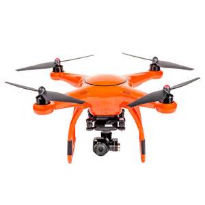

Whats flying a P4 have to do with your question Holt? We are talking about the qualities of product which eventuality reverts to inferior products priduced mass market by the Chinese - as always
The relevance is that how can you say that the Autel is stronger if he hasn't been able to compare in person?
