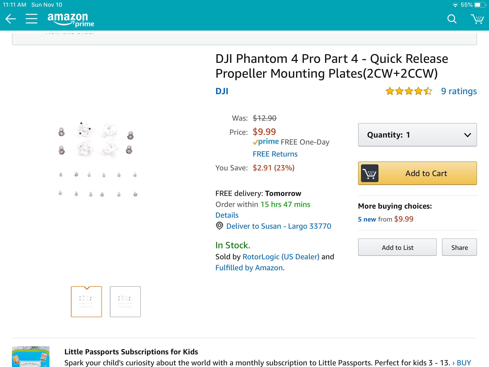

Does it also do that little shake at take off? First thing to try is changing props. Do not use low noise props unless you have changed out to the P4Pro prop mounts. It would be a good idea to change to them anyhow for about $12. They are far superior and may solve your problem. All of my P4’s have the new mounts. The originals have springs that wear out.
DJI Phantom 4 Pro Part 4 - Quick Release Propeller Mounting Plates(2CW+2CCW) https://www.amazon.com/dp/B0764P6H1G/ref=cm_sw_r_cp_tai_4tdYDb4F6CYH7
Can’t get the link to work
I didn't notice it on take off. I have a new set of props. I will try that first. I will post if that helps. Thanks
Be sure to check the old springs under your props. They may have to be tuned by lifting them to put more pressure against the props. Not necessary with P4Pro mounts. Good luck fly safe.
