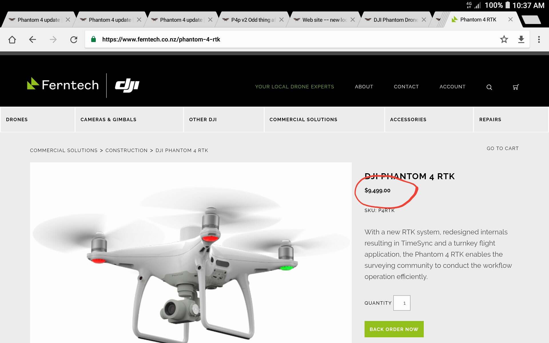

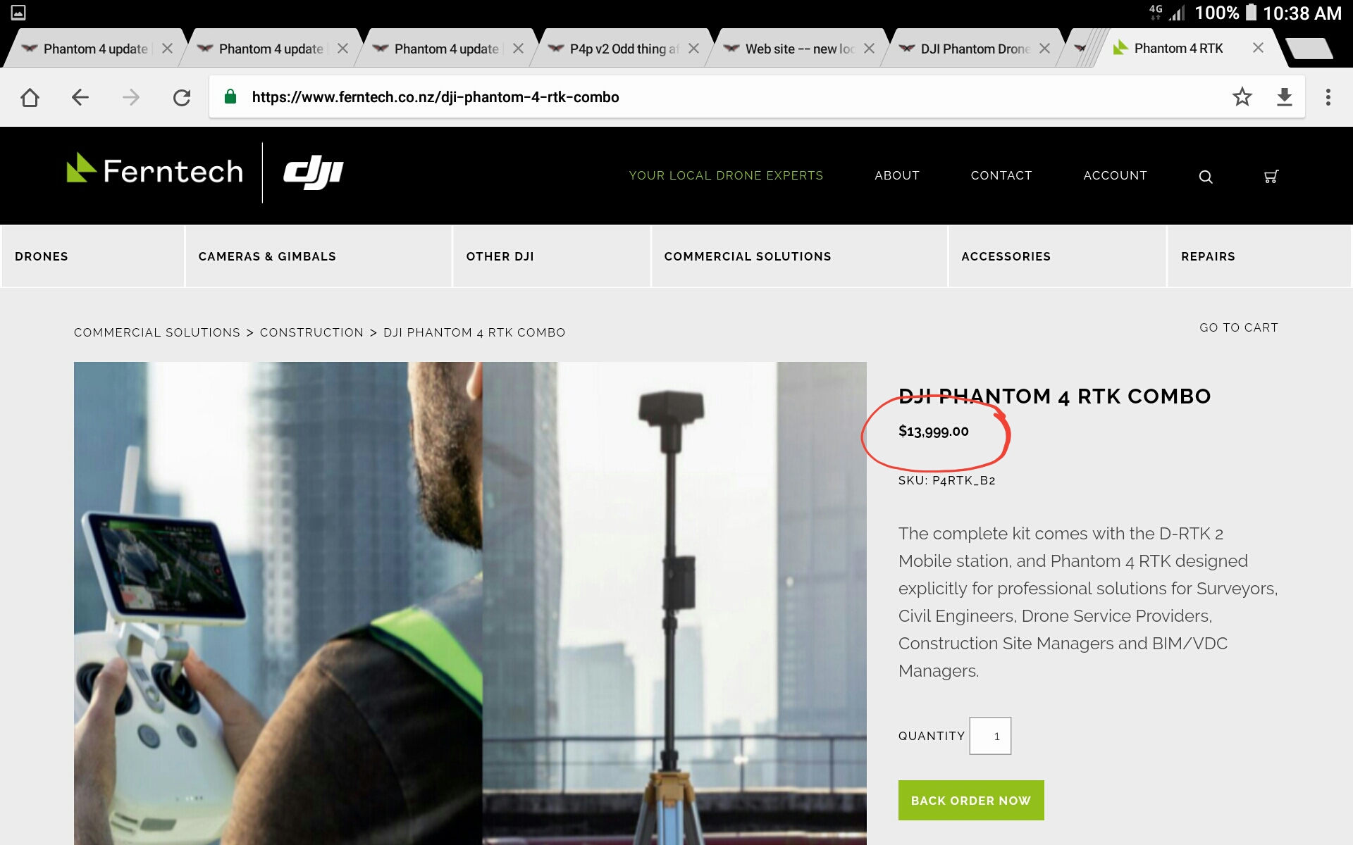

$7500 is the cheapest,check out these other prices,I wonder who prices these things
Relative to the high-end commercial offerings, such as the Matrice 200 RTK, these are very inexpensive, especially if they do what you need without the additional capabilities.
