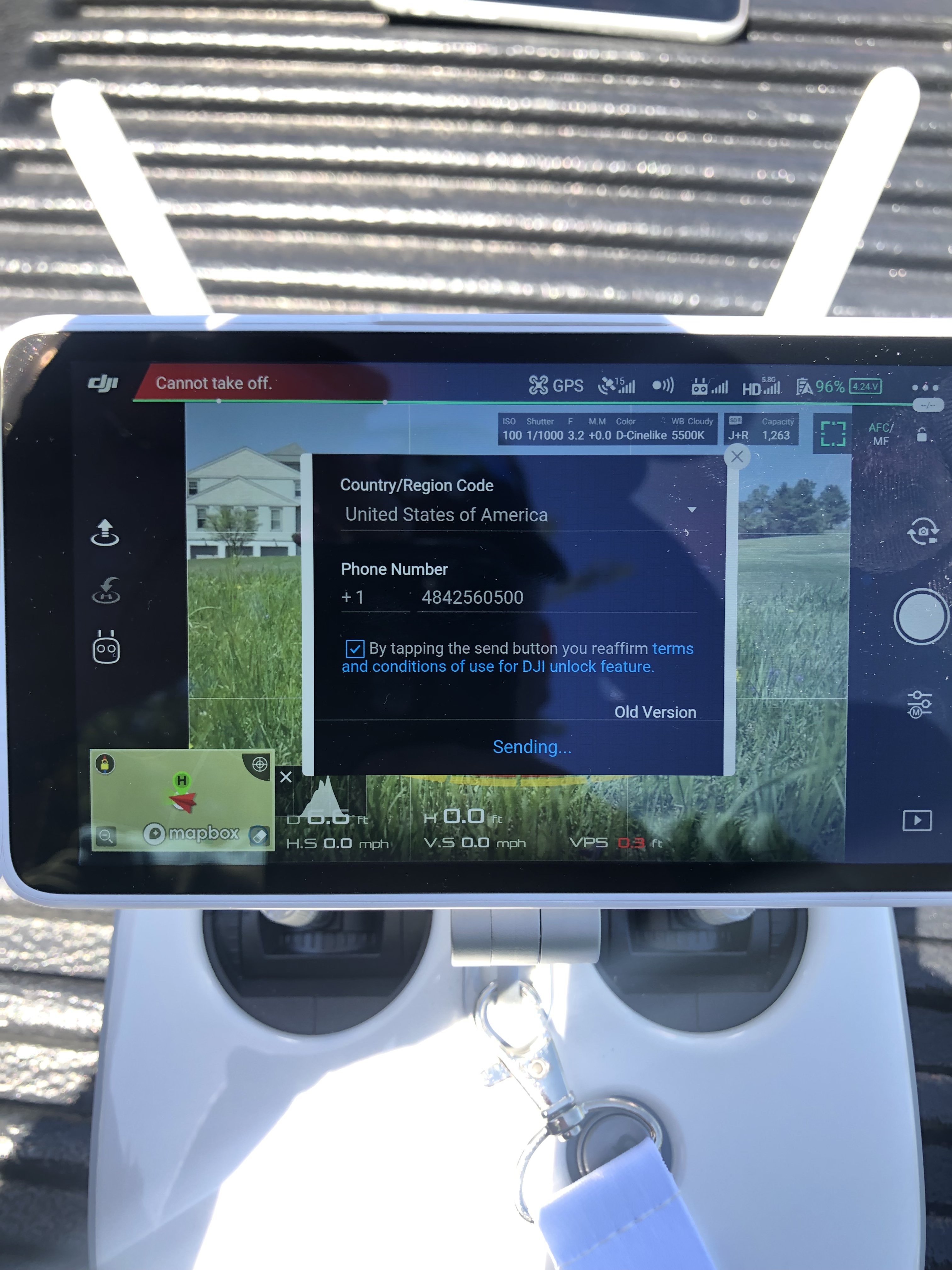

Haven’t figured mine out because today I flew without any issues, we’ll besides being in a no fly zone and needing to get DJI permission to even launch

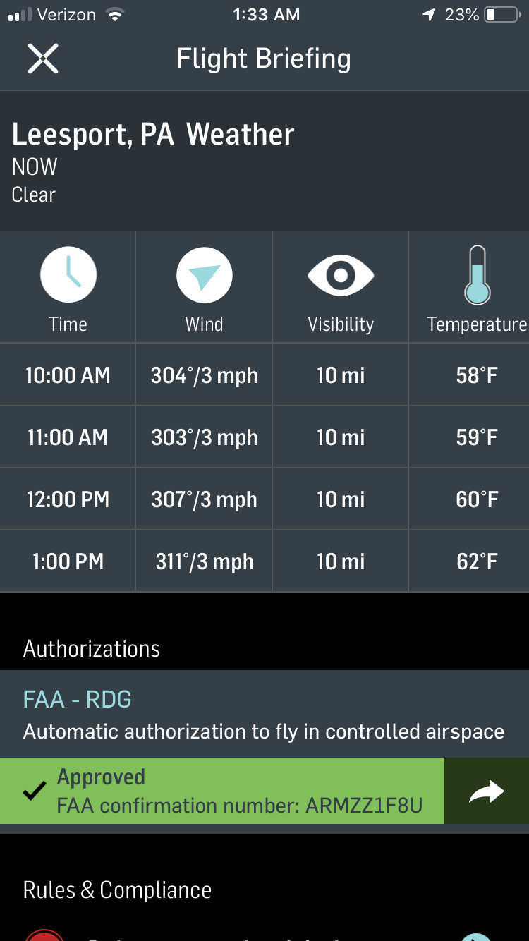

FAA approval
