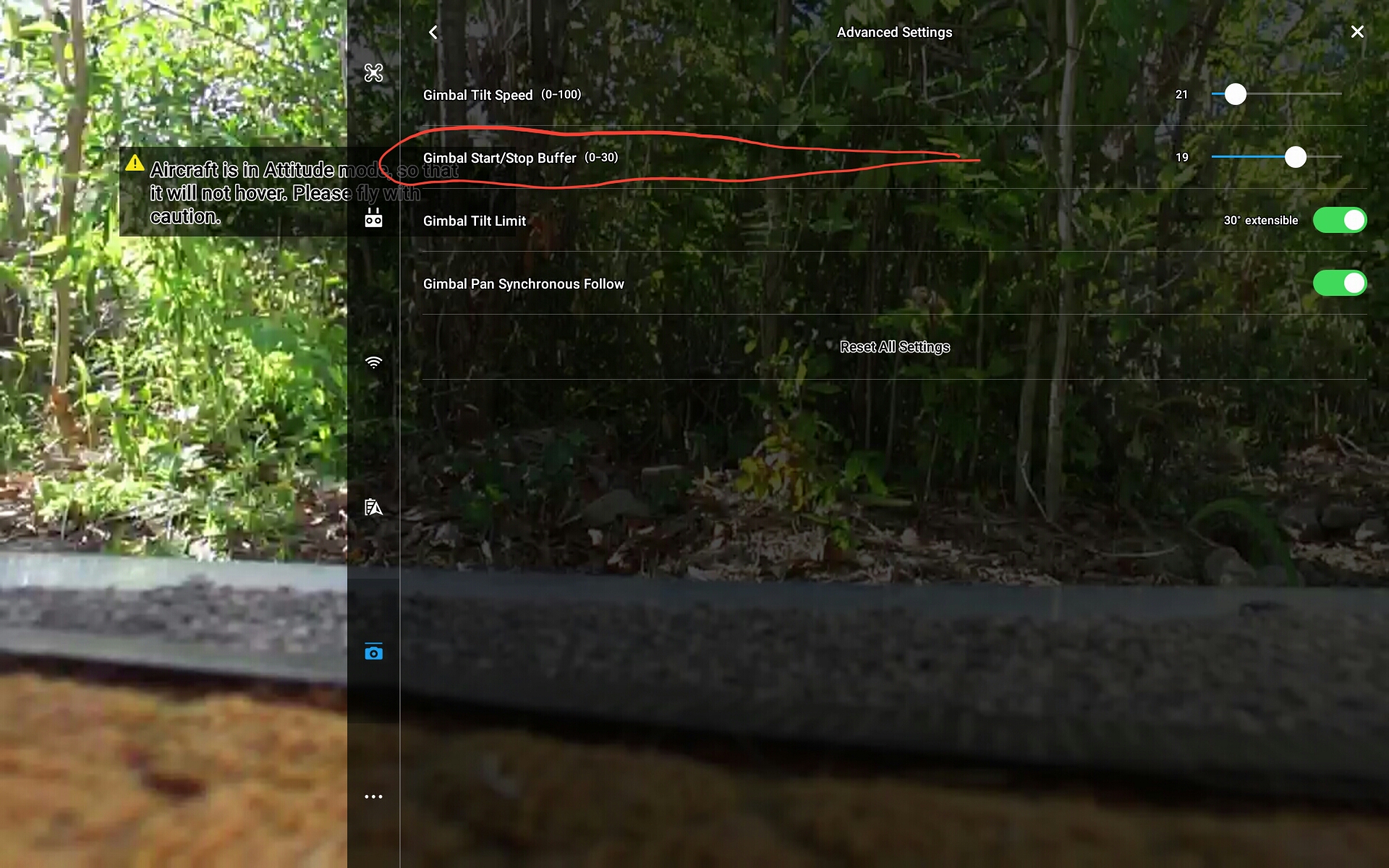

Nice views big cliffs,me not mind props , what I can suggest like at end when you pan down to beach,there's a setting in advanced cam settings to allow start and stop of up and down,I think it called ""buffer start stop or close to that,,it makes cam pan down nice and slow or fast where ever you set it so no jerky Ness when gimble wheel pressed,can even set c1 or c2 to do it for you once set to what ever speed,does make a difference if you experiment with it,,,anyway loved the clip,,,this pic from p3 but p4 have similar setting,this control speed when gimble wheel used

thanks chief
