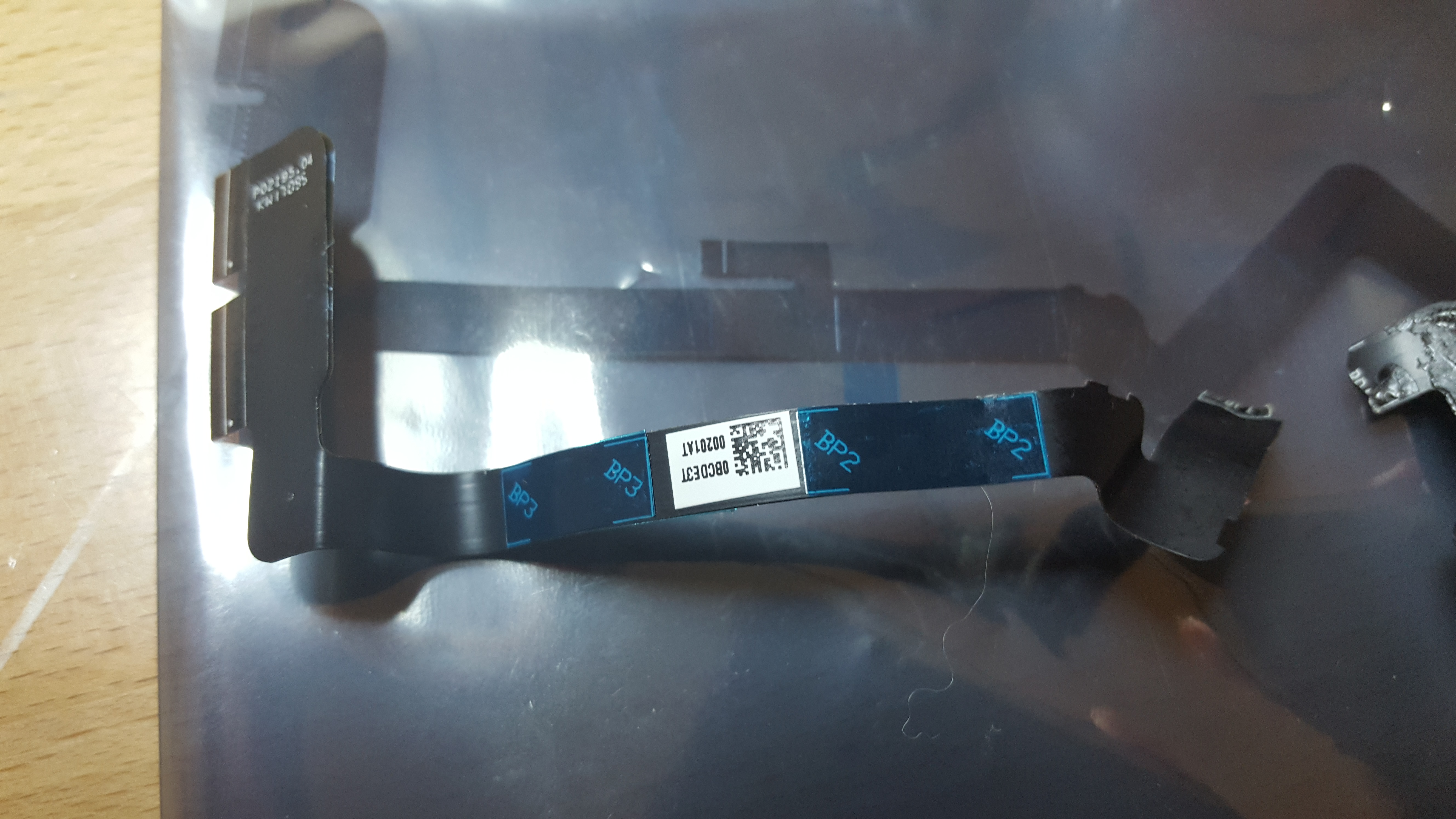

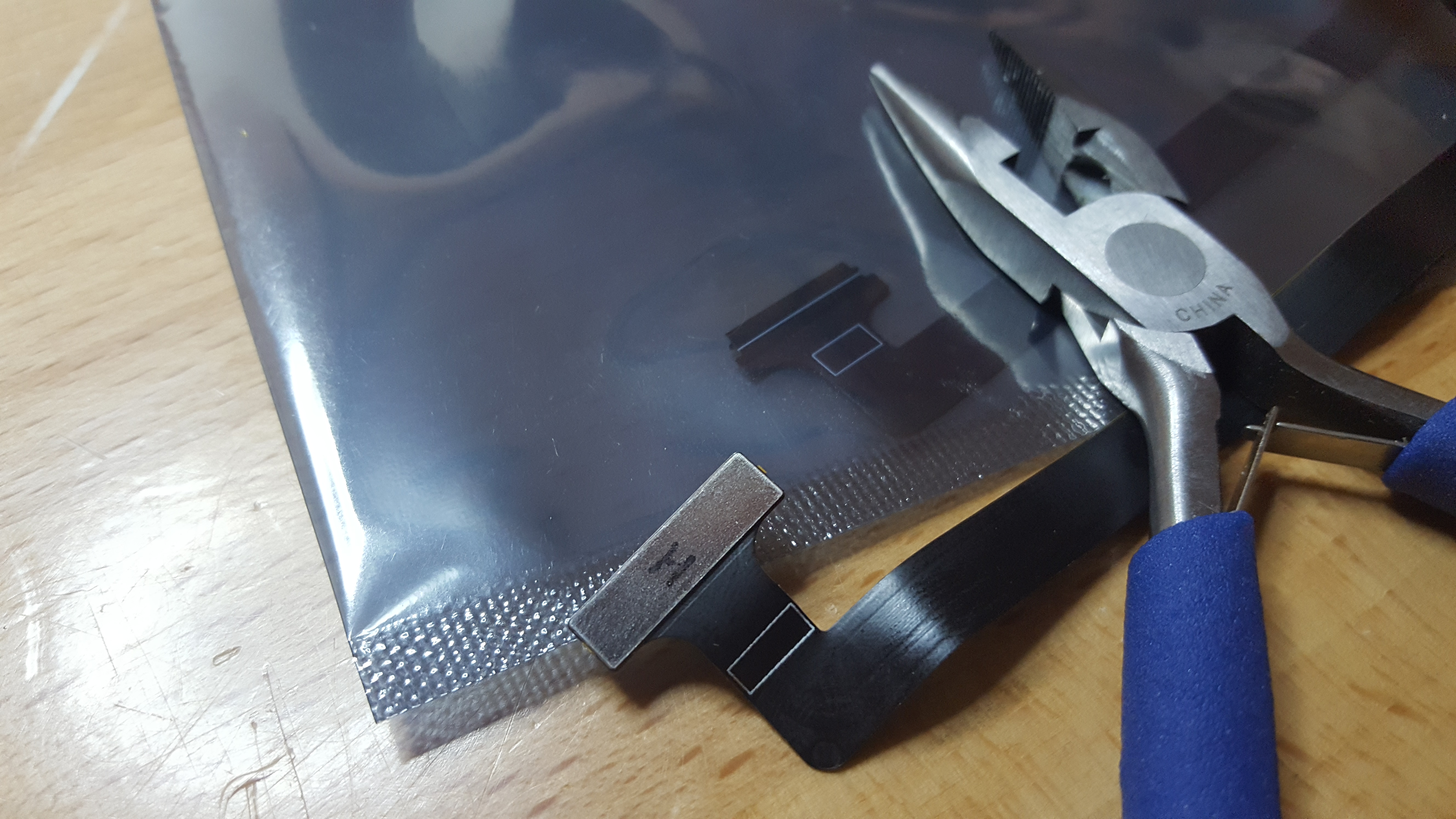

First time poster - thanks for letting me join your forum. Unfortunately I crashed my 3 day old P4 Adv drone. The yaw arm on the gimble was broken and the camera flex cable was severed. I found and ordered the replacement parts on Amazon. I received the parts today and the arm is correct but the cable is not. They sent me the flat cable part # 36 which is not correct. My cable has a different connector on the camera end and does not have the small piece that jets out near the yaw motor. I found a part number of 0BCDE3T00201AT but cannot find this cable anywhere. I just finished a on-line discussion with DJI and they were not helpful at all. The guy told me to check cable stores because they only sell Part #36. Have anyone come across a different cable assembly and can provide a replacement model #? I'm thinking they must have switched manufactures for the gimble assembly or did some sort of up date to it. Any help would be great! I've inserted a few pictures of the differences between my cable and the Part #36 one .

I'm the original poster and no I still have not found a replacement cable. I did find out however the gimble was revised in April of 2017 so if your bird was manufactured after that date you will have this updated cable and the yaw arm is different too.
