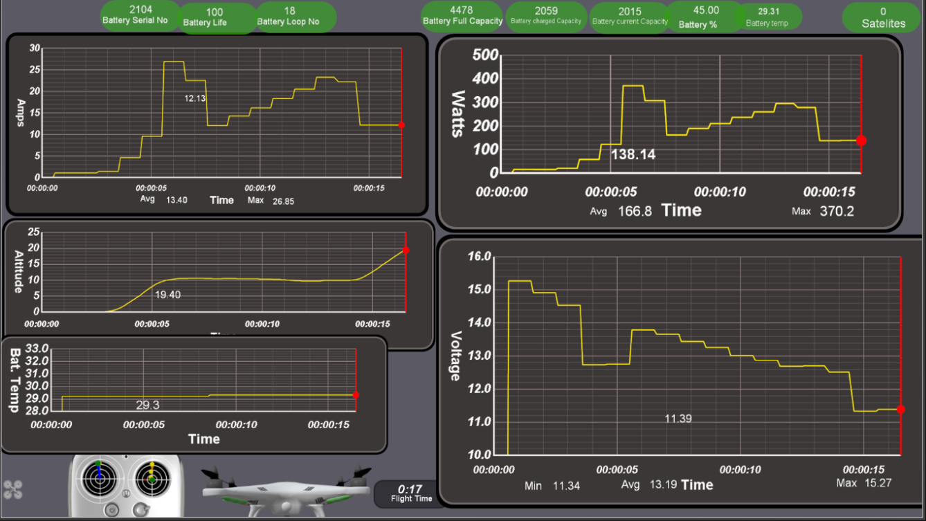

But here is a screen shot of the txt taken in Dashware.
Did you take off with no satellites? Seems like you flew 14 seconds before crashing?
Battery current capacity indicates 2015mAh at end of flight or 45% remaining capacity. No way this is correct (if your P3 has not got a faulty motor or something else - again could check this in dat file) as voltage is below 3v/cell! Your battery is fully depleted. From the moment voltage reaches 14v it should do an auto landing- i.e. 4 seconds after motor switched on - but as per chart - it reacts to your full throttle and gains altitude.

You should definitely post the dat file per above post as txt does not have as much data.
