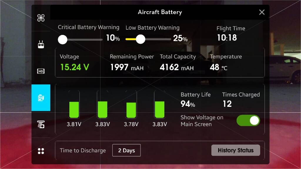

This is my flight test after recharging the battery and ending flight at 50% mark:
Cell number 3 seems to be the one degrading first with a 0.6 ~ 0.8 difference mark the rest of cells were too close 0.1 ~ 0.2 difference and sometimes equal, i suppose that i should keep on flying for 10min only for a while in hopes to get it back in balance. This picture was taken after i landed directly, it shows a 0.5 difference on the third cell, but when im flight in increases to 0.8 max.... Should explain everything. Open for suggestions and help maintain the battery health for longer thx

You missed a zero in the voltage difference, I think you meant 0.08v.
This is exactly what I would do if I were you. With any luck, you may get that cell's IR to drop, allowing it to stay more balanced with the rest. However, I don't expect it to last as long as a battery that has never been in an unhealthy state.
