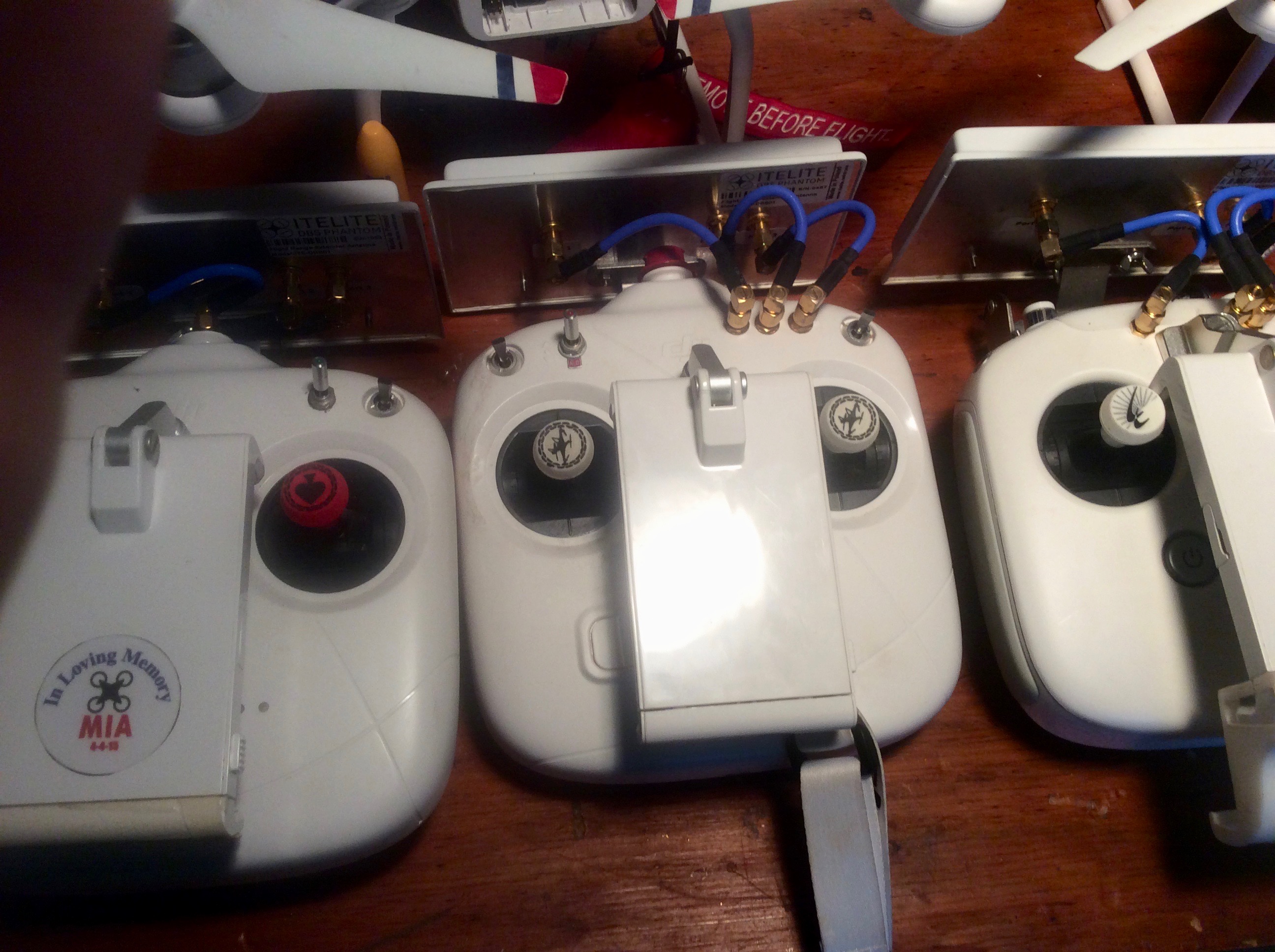

This is going OT and sorry but going to say this. When we were doing range test with all the antennas on the Standard i had been trying for awhile with the P2V. Now there are many threads in this section way back on this and we were getting at the time really good distances with several antennas. Some amped them but i never did. It's more than just the antenna that gets you distance than what antenna you use but the manner in how you aim.
The farther away you get the more critical any movement of you TX is.
Don't have time at the moment to go deep in it but it is all in here if you search.I will show you what i think worked best from all i learned from other members and my test with these pictures.
P2V-V3,Stantard and P3 4K- all modded with Inspire tablet holders as i used a Mini then
instead of a phone.
Now i went even further than just modding the TX i did the bird also.
instead of a phone.

Wow, these are some impressive antenna conversions you devised. Once the antenna connections are brought out of the controller housing, a whole spectrum of antenna alternatives become possible via those RP-SMA connectors.
I just got done testing out the flat panels that came with the ArgTek antenna conversion kit, and the difference in reception between the flat panels, and the long whip antennae on the incoming 2.4GHz video, was night and day.
Right out of the box, I initially installed only the ArgTek whip antenna on the dual 2.4GHz connectors for the incoming video signal, while affixing the third longer-than-stock Argtek whip antenna on the outgoing 5.8GHz connector, meaning I used NONE of the supplied ArgTek flat panel antennae.
I noticed some decent range gains over stock, by going with the whip antenna for all three Argtek antennae connections, and so it was only today that I finally got around to range-testing those ArgTek flat-panel antennae for the first time on both 2.4GHz connectors, only to obtain abysmal range in comparison to the whip antenna, which I have now re-installed.
Based on this simple range test, therefore, the ArgTek whip antenna produces way better range figures that are possible with the supplied ArgTek flat panel antenna, for the Phantom 3 Standard. While the flat panel antennae may well work well for other drones, they certainly don't make the grade for the Phantom 3 Standard controller, for which they yielded even shorter signal range than is possible with the bone-stock RC controller.
