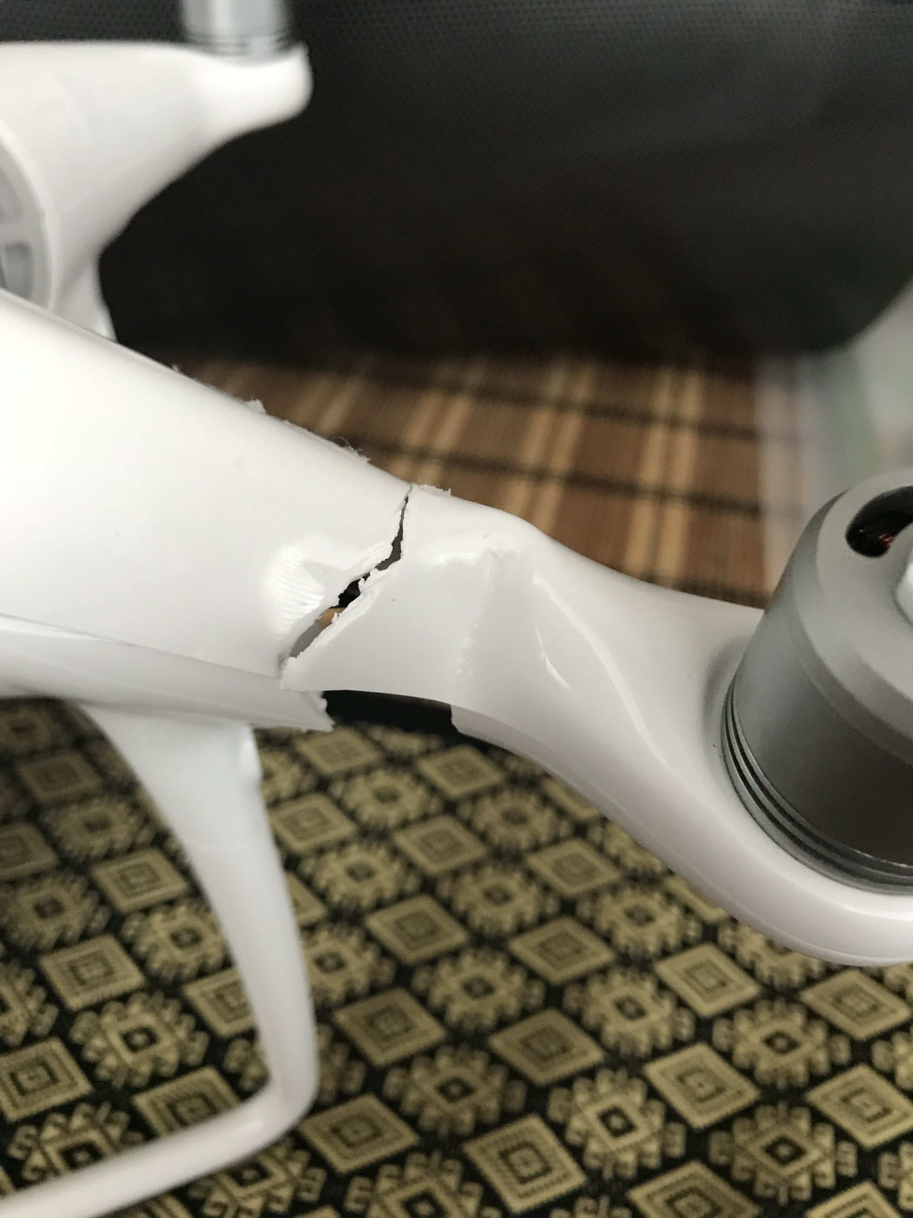

First time post for me as I need some advice please. My beloved P4P is 7 months old. No issues until today. Was bringing it back after a short flight in sport mode (plenty of battery left) just bringing it to a hover around 26 feet/8 metres high and it just started tumbling out of the sky before my eyes and crashed onto a wooden deck then bounced into a bush.
Flight log is here
Some pics of the damage: IMG_6548.JPG IMG_6549.JPG IMG_6550.JPG IMG_6551 (1).JPG IMG_6552.JPG
Camera/gimbal seem OK and all 4 motors still seem to run ok (not that I've taken off) but rear left arm is broken.

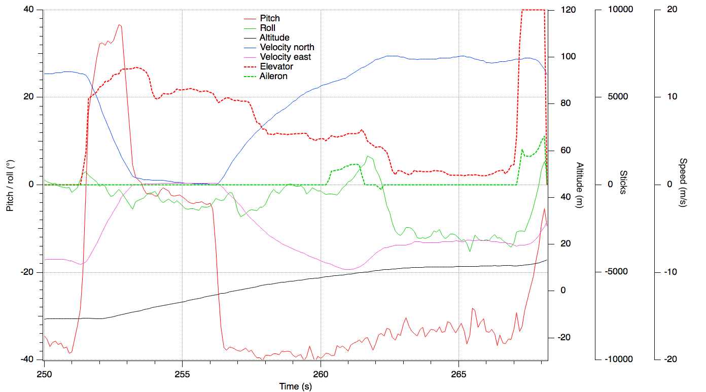

I concur with @Meta4. This was caused by sudden power loss at the end of the flight, and is the latest in a rash of such incidents with P4Ps. The flight data shows that just before the end of the record at 267.3 seconds you applied full forward elevator, and then recentered the sticks 0.8 seconds later. 0.1 seconds after that the record stops. My primary suspicion would be that the battery was dislodged during that maneuver, shutting down the aircraft.

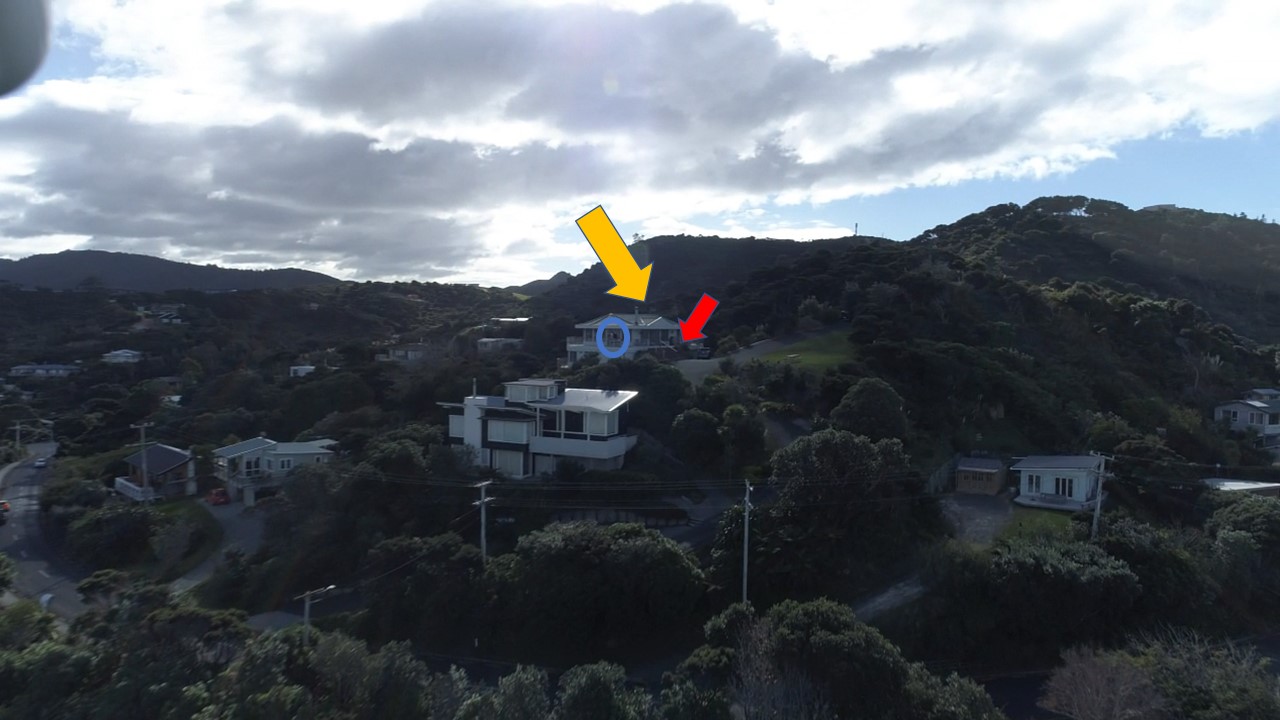

Also attached is the last frame of the video that wrote to the card. I thought I was going to have some epic crash footage but alas, no!!
Assume it takes time to write the image to the card. (the date of the folder of this last video file was 01JAN16. Don't know if that helps)
  1. Blue circle was where I was.
  2. Yellow arrow is my guess at where it lost power
  3. Red arrow is where it came to rest
Cheers

OK - this shows the final second of the motor voltage data, with the expected collapse to around 7 V in around 100 ms, at which point the FC shuts down due to low voltage. That confirms that it was power loss. Since it still powers up, that strongly suggests that the battery disconnected.
