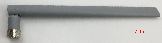

5dBi Rubber Ducky Type Antenna (RP-SMA of course, see link below) to date my tests have shown them to be at least on par
with the stock antenna (current testing out to 10k/ft), caveat.. the Grey, 7dBi (dual band, dipole blah...blah) antenna some are
using 'Are Not' a good choice, again the Plain Jane 5dBi Rubber Ducky made by dozens of mfg will work just fine in town and in
remote areas.. and what I mean by work just fine is they will also take you out further than your batteries can bring you back.. if
on the other hand you'd rather add your name to the list of 1-way trip distance leaders.. then by all means buy an aux powered
panel type antenna...
