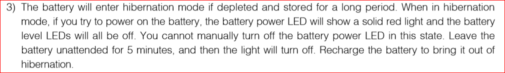

The manual says how to bring em out of hibernation
In your link is nothing of how to revive a battery. Only safety and normal use instructions.
Thank you for all your help... Will check on "Hibernation Mode".. And see if I can bring them back up.. Started to panic, as the "Boss" was wondering why and I had no answers.. Batteries are REALLY expensive.. LOL
Got it. Not working for me. Battery shows last bar solid green, one above is flashing and the 2 above are dark. When charger is plugged in the battery nothing happens, no charging.
