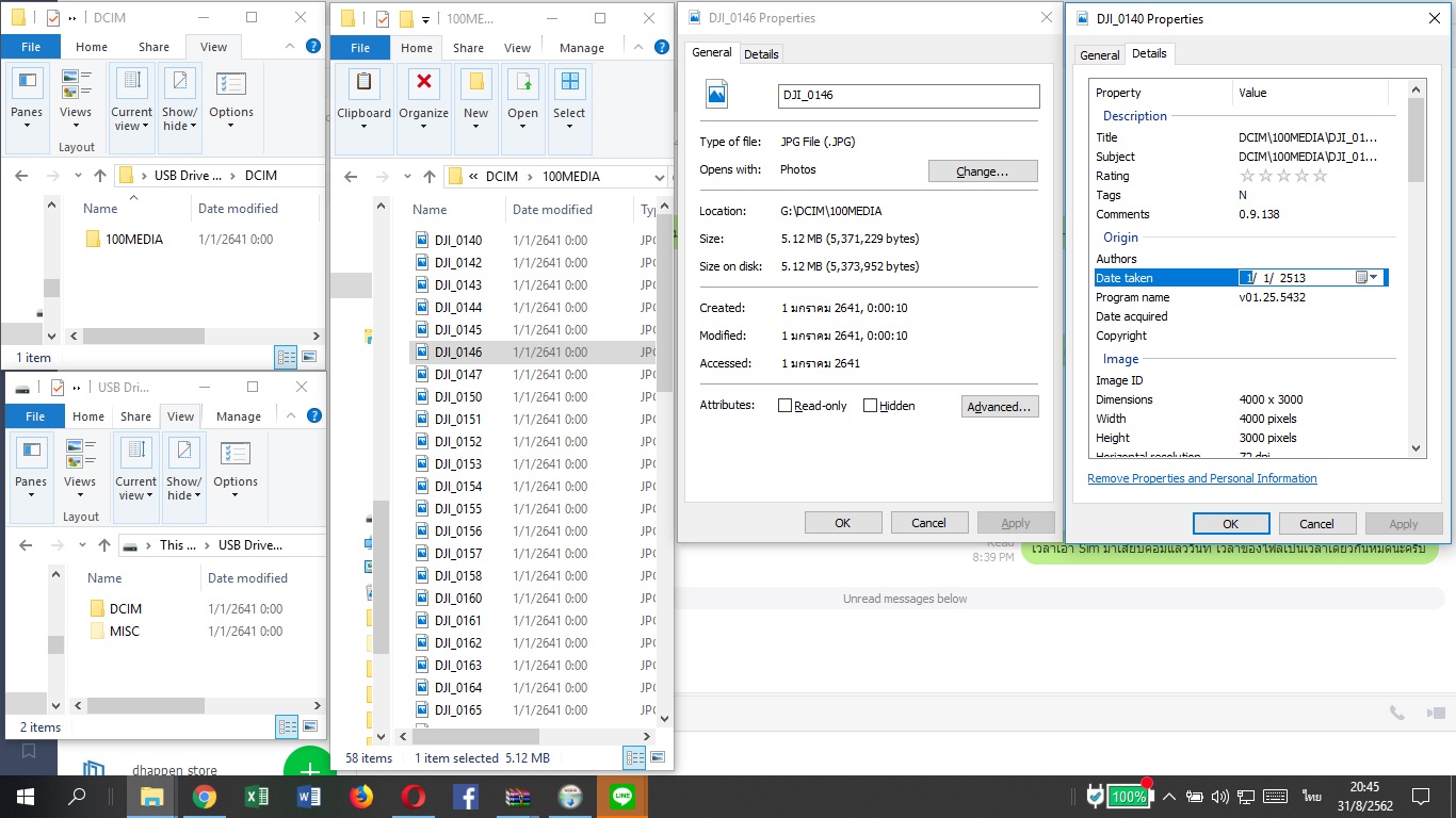

I do have same problem. Please have a look at what really happen to the files. Does anyone here have the solution yet?
I can't say I understand how this is really a problem. Are these dates used by some software?
Anyway, camera gets its date from some kind of packet; DAT flight logs should expose the packets which have bad date, and source component.
