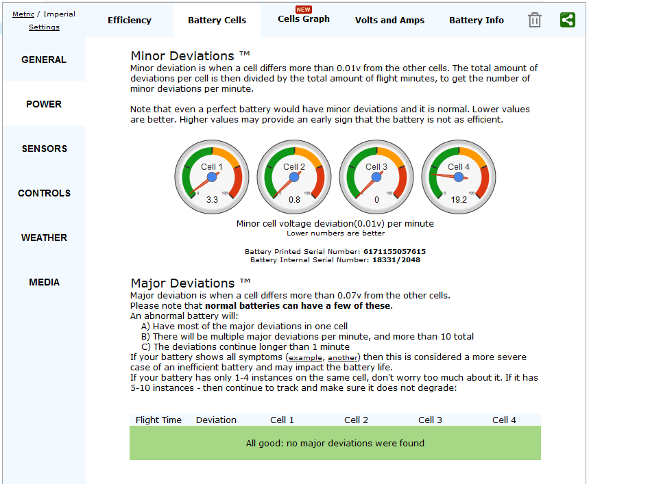

personally I use Airdata and for the laat few years it shows usually 1 cell lower than the rest see clip Airdata says it's still ok to use, I've never had any problems with my batteries, if Airdata shows a problem with the cells then that's when I'll get another
