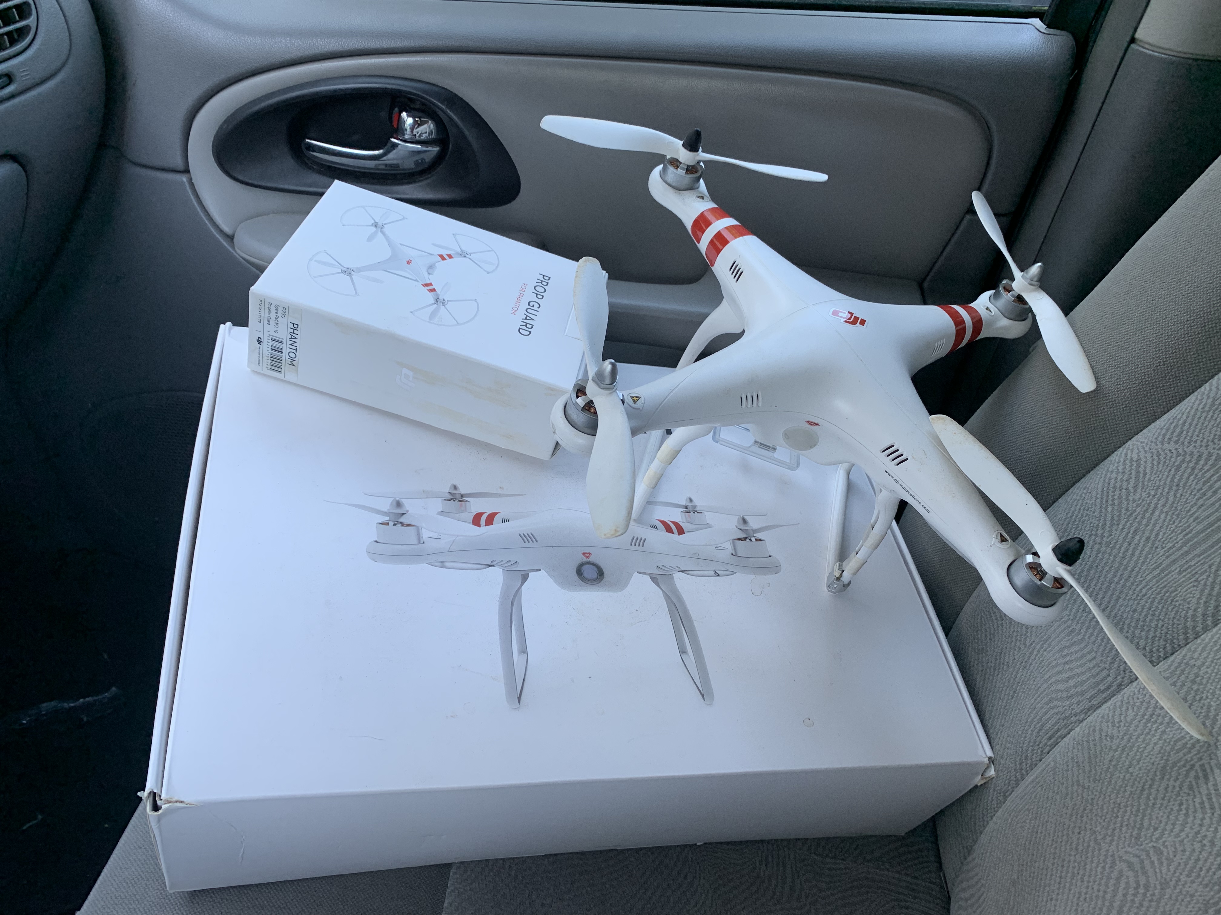

I have rebinded the controller with the drone but it still will not start the motors. It just the fast green light blink and that’s it. I have tried connect it to old software and it just says connect controller. Is there anyway to completely reset the craft and the controller to factory settings to see if that fixes problem? Also is there anything I’m missing maybe . It’s a model p330 and the controller is a sr6
Thanks
I was having this issue with mine. And I went to DJI and downloaded the driver and Naza-m assistant and upgraded the software in mine and it worked great.
