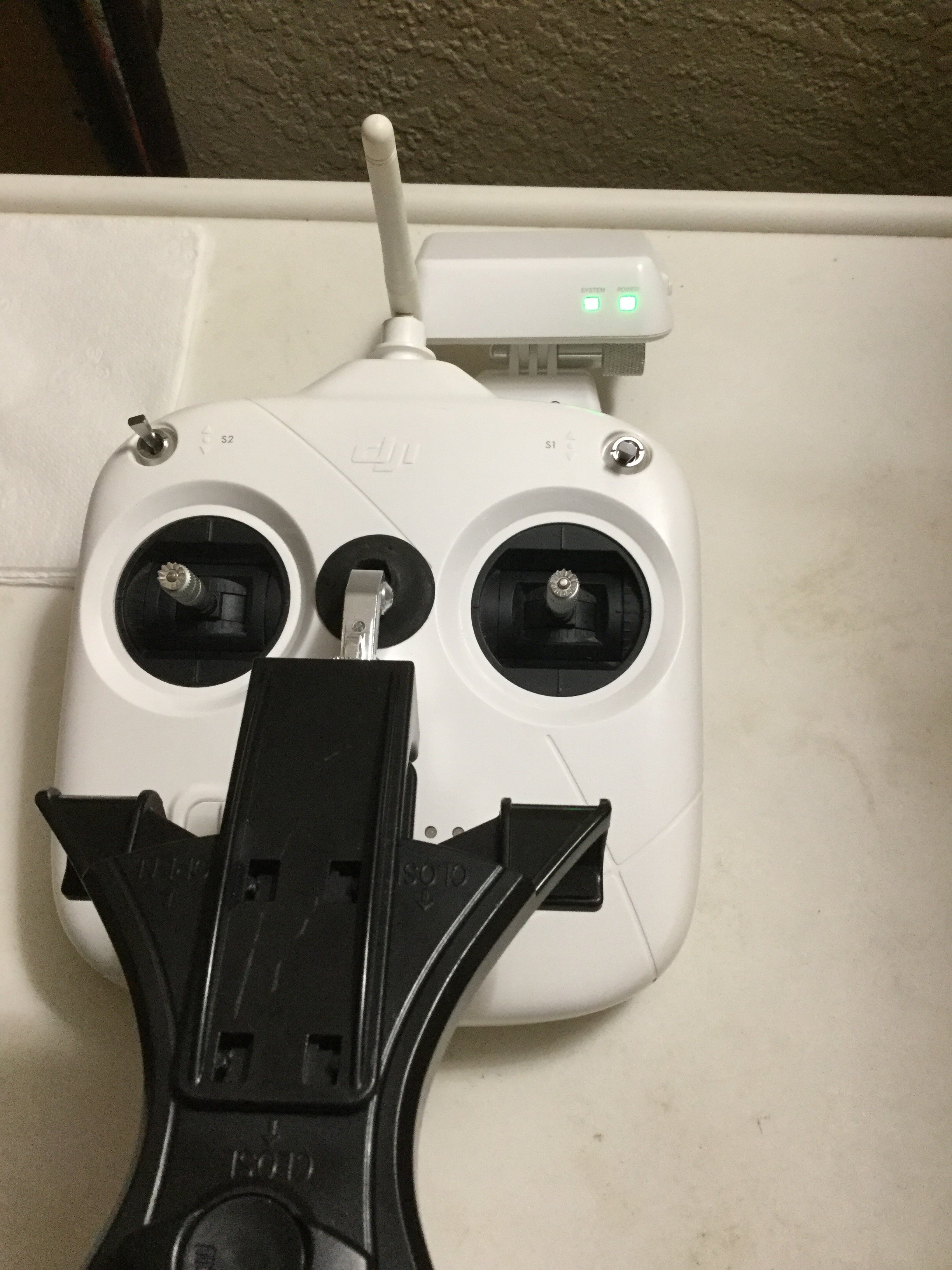

Most likely the batteries that don’t light up are shot. Others might help you try to bring them back to life. YouTube videos are going to be your best bet starting out. You have a lot to learn. And I’m sure other help is on the way here. Is the weird extender thing fastened to the handle underneath? If it is, it’s supposed to hold your phone. A picture would help. Have fun fly safe.

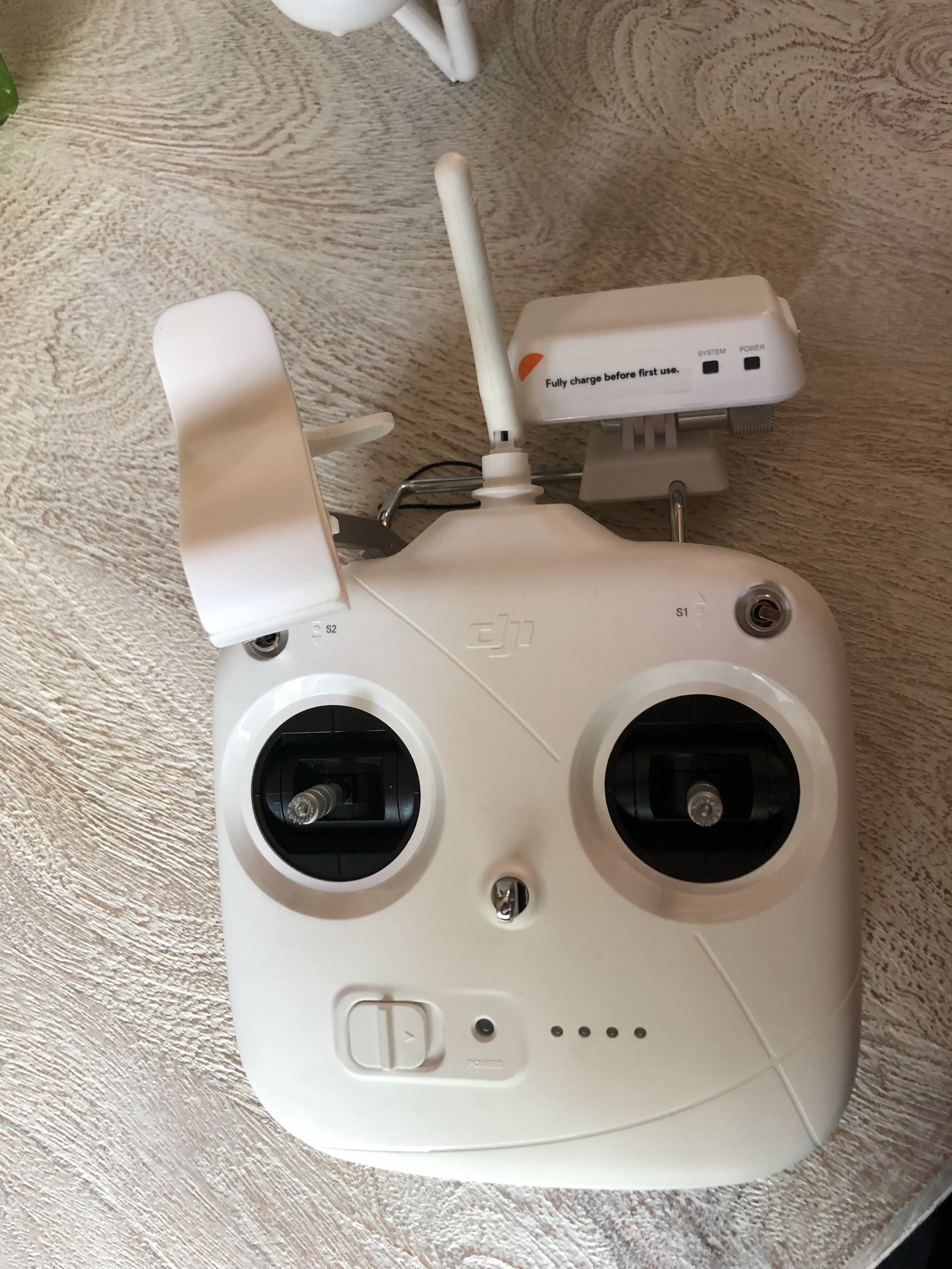

I have the same Wi-Fi extender but have no idea how to use it. Can’t find a name on it and found nothing like it online. Mine mounts entirely different and looks like it replaces the original stick antenna. It’s tubular in shape, with no wires. The extender itself is identical to the one above.Any ideas on where to look would be helpful.

Capt KO can you post a picture I've never seen a different one but others here most likely will know the maker of it
Reactions: Capt KO
Thank you, I was able to figure it out from the picture. Glad somebody did that so I know what I have. My mount is the same.
