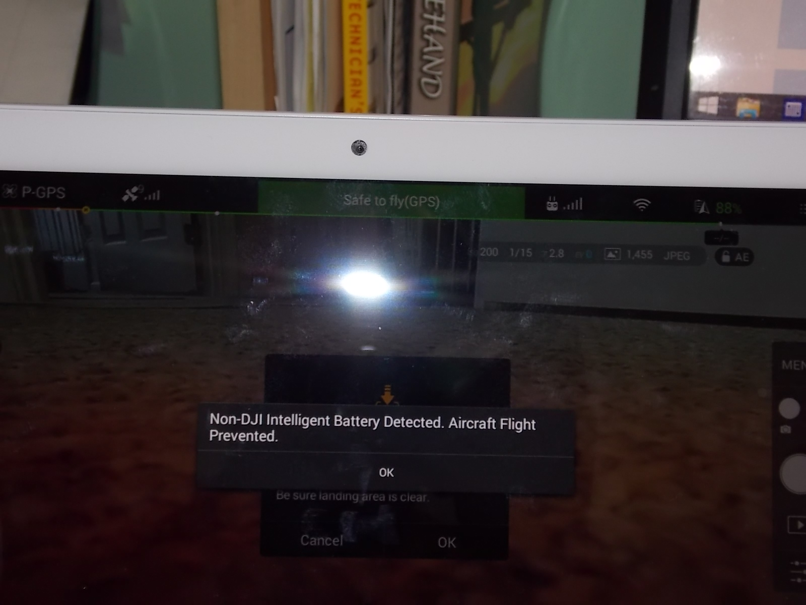

Non DJI Intelligent Battery Detected. Flight prohibited
Is it android tablet? If yes - extract zip file to your chosen folder, go to the folder and run "dji.pilot.apk" file and install the apk. Then copy "dji.pilot" folder (it is located in your extracted place) to your device`s Android\obb\ folder. Run the program. Use file explorer for these operations.
I'm not very computer savvy...
Yes, the tablet is from the recommended DJI list, an Acer Iconia 10. How do I "extract" the zip file? I click the file icon and a pop up says "Unsupported File Type".
I have no clue how to "copy" or what an Android/obb/folder, is. Though I do appreciate your trying to explain it. :cool:
Try this from a different way, on my tablet I have a "Downloads" App, when I go there the DJ-Go.apk was there from the original install. I just clicked it. and it did my reinstall.
**** You must go to the Play Store and go to DJI go app and click on the 3 vertical . (menu) and turn updates off or it will update it back to the 2.6.1 ****
That's just it. I download and look in the download file and it is empty. I presume due to being "unsupported file type".

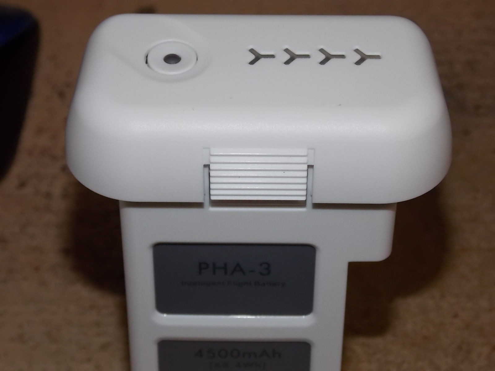

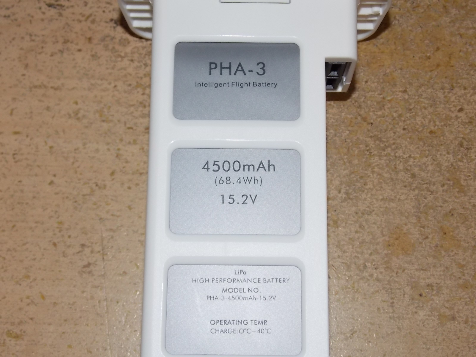

View attachment 46737 View attachment 46738 View attachment 46739
I'd just send them a video like what they're asking for.
Get an assistant to tape you while you show them the Banggood battery being inserted into the drone, power up everything, and attempt to start the motors. Make sure the camera can see the error pop up on the tablet as you do the CSC.
That would be a more compelling evidence than static pictures.
Reactions: Storm
No, they asked for a video OR photos showing what they are asking to see. I sent them. As for evidence, they themselves reply to a complaint on their site that batteries bought before March 8th to NOT get the latest version of the DJI-GO app. Well, I bought my battery end of February and never had the option of installing any other app than what was on the Google Play store.
The description said nothing about needing a specific app, only said that the battery was the same as the original and it is not, as evidenced by the pictures.
Thanks! Work like a charm! :)

***UPDATE***
The Bangood battery works IF and only IF, using the 'Litchi' app and NOT when using the DJI-GO app. At least, it doesn't shut down immediately after startup. In preliminary testing, there were no issues. When we go out to fly again in a few days, more comprehensive testing will be done.
So I have therefore notified Bangood as well as PayPal to fuggid about the refund, I already have a true DJI battery on its way. So I will have 3 batteries. The catch is, the Litchi app must be purchased at the cost of $20. And there goes any savings one might have enjoyed had the battery just worked as promised from the beginning. Had it been in the description that a different type of app is needed so it works, I would have continued my search for a cheap battery. Of course, the app only needs to be purchased once, so after the initial cost, the battery price is still the best I have seen.
