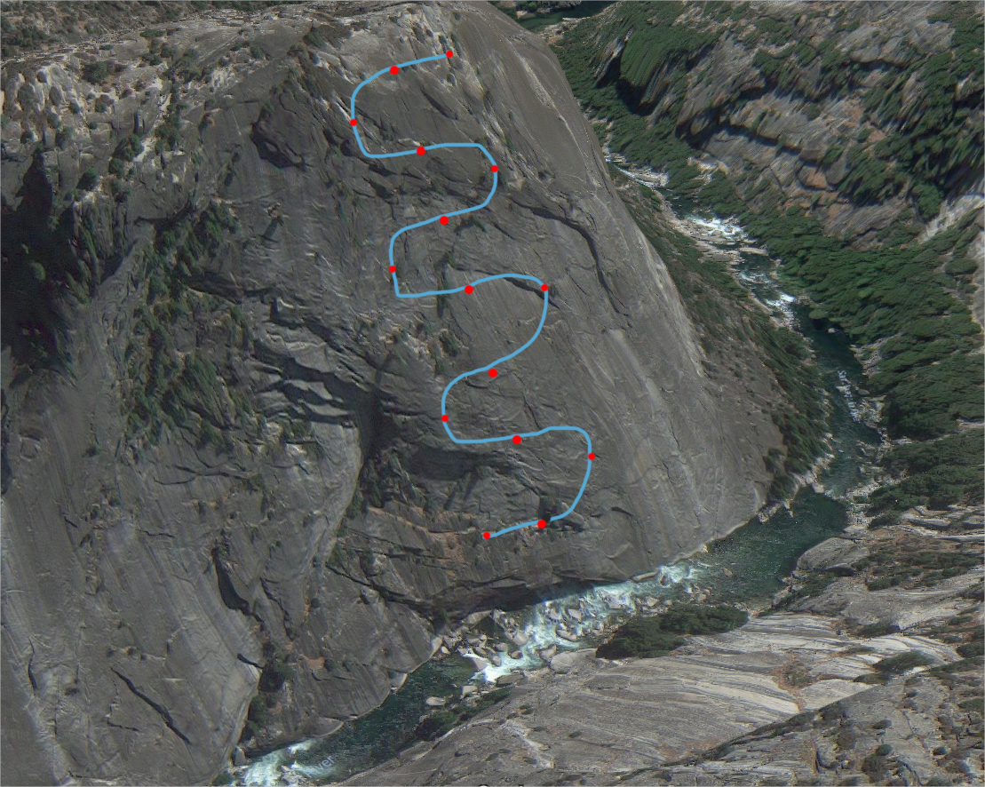

I'm getting into photogrammetry for CG and and thinking that drone flight would be a great option for those hard to reach projects. I know that several drones have a programmable flight path, but exactly how programmable is it?
In this image, if I wanted to take imagery of the particular section of a cliff face, would I be able to plot a flighpath in 3-dimensions (blue line)? I've seen 2d flight paths being plotted in youtube videos but I'm unsure about 3d.
Also, would I be able to programmatically control the roll/pitch/yaw of the camera along the path? Could I create focal points where the camera is always aiming at a specific area? Ideally, I'd pre-set a flight path (blue line) and a set of camera control points along that path (red line) and hit go.
Is something like this possible with professional-quality drones? Thanks so much for your help!

Sorry about that. I misunderstood your post. With autopilots like AutoFlightLogics Autopilot or Litchi, you can program in altitudes and camera angles for your waypoints so you can have as complete control as is possible. Keep in mind though that if you fly your route and record your waypoints or program it on a computer, the GPS of the drone is only accurate enough to put the drone somewhere inside a 10 foot sphere of the position of your waypoint. That is only an issue if you are trying to hit a specific mark with you camera. It’s the same reason that even flying the same flight plan the images/video will not align exactly with previous flights.
I’m not entirely sure of the information you are looking for, but it is easy enough to track in CG for visualizations or import texture details into CG. If you can be a little more specific, I might be able to help. I have been doing production work for 30 years.

There are several apps that help you to program flight paths for photogrammetry missions.
Look at DroneDeploy for starters.
Here it is flying a 32 acre site and collecting 245 images
Litchi is the app you want go and search YouTube you will find lots about it there
