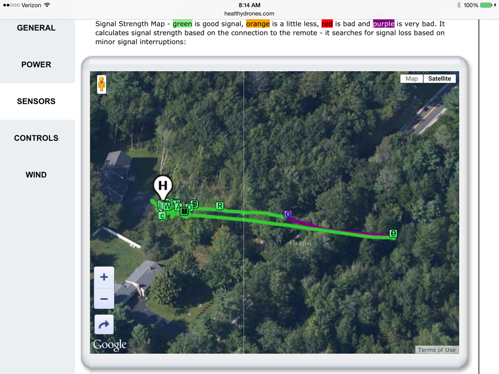

This is a very nice website. Thank you for creating it! Quick question, does the signal map show signal for video transmission, tx/rx control, or both? On my first flight after the firmware update on August 6th, I had a "lost connection" warning at only a few hundred feet out. I thought it would be interesting to look at that flight log on your site. Indeed, it shows a purple "flight leg" on the map. The alert also said "lost signal for 14.3 seconds." Here is a screenshot.View attachment 27722
Thanks. The signal in this map is a gap in telemetry data received by the remote.

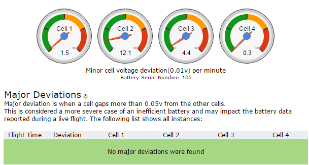

Im still showing some healthy battery data issues...View attachment 27760
What is the issue you are seeing? your battery looks very good to me :-) the lower the deviation value is, the better. Maybe I should add some clarifying text? A bad battery would have at least one cell going up to the orange zone, and will have major deviations recorded.
Well.. I guess I took this data as individual cell voltages.. 1.5v 12.1v 4.4v .3v
Maybe I was just looking at it wrong.
That's good feedback, thanks. I added a bit of clarification to the page. I do also want to add a page where it shows an animation of how the battery handles over the flight time, which is more like what you're describing.
