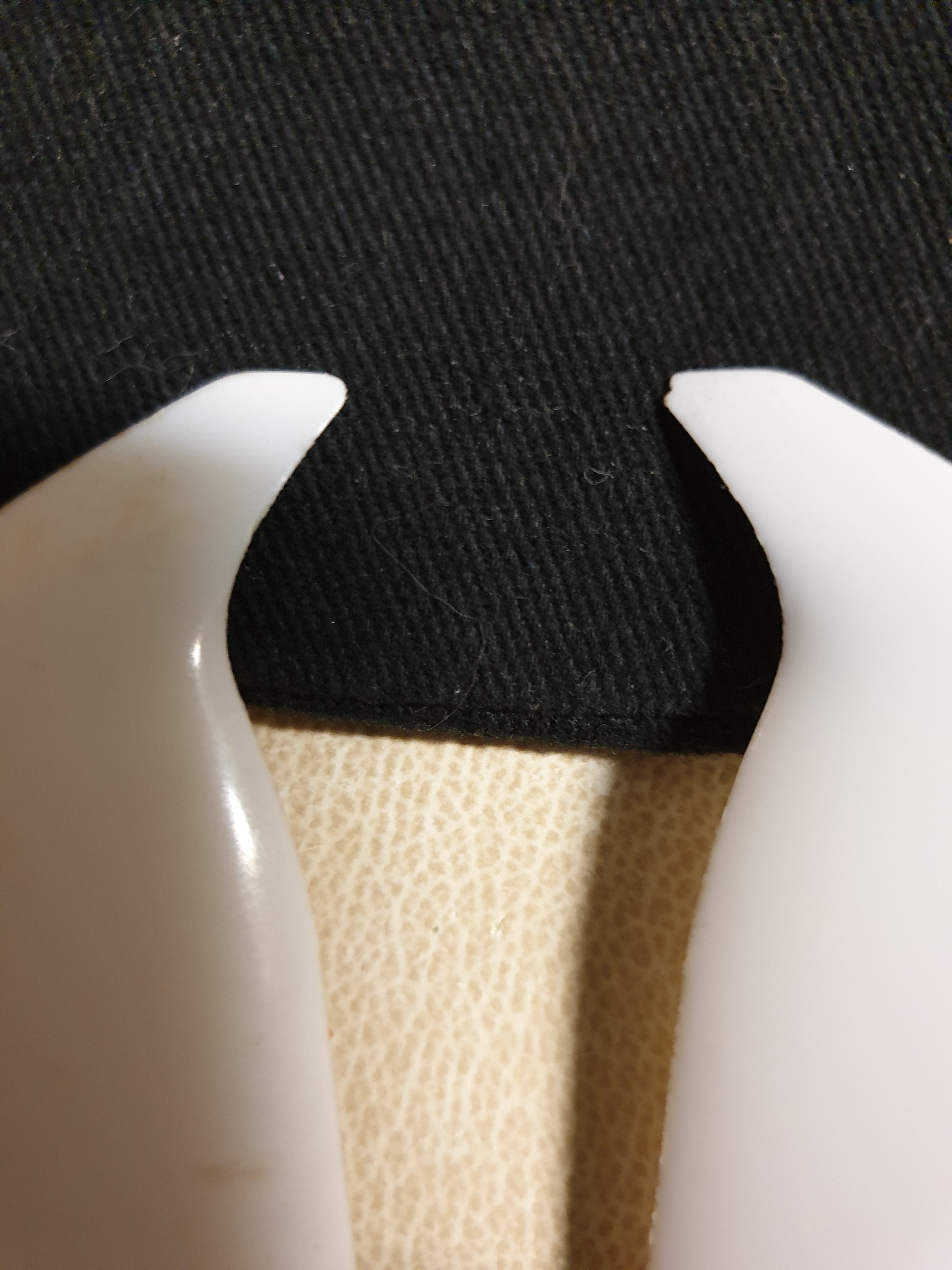

No idea, maybe all the pollution? Or me
Where do you think it is shaky 2edgesword, or do you think it is all shaky?
Yes, I was referring to the pans. It seemed to start and stop rather than be a smooth pan.
Even panning in tripod mode with the same settings produces a stutter but not every time. Yesterday I tried Attitude mode and there was not stutter or shaking at all.
After a few days of trying different solutions such as calibrating the gimbal and IMU and removing a Lume Cube I fly with I was about to give up and send the P4P back to DJI.
Then after a careful examination of the props I found a small nick at the end of one of the tips. I took off the other day in a bit of wind and the bird tipped over. I checked the props but did not see any thing. So I went and bought some new quiet props and boy are they hard to find in my city. The biggest electronic outlet stores do not have one Phantom or any parts! Anyway the stuttering while panning was halved. But there is still some shake while panning and I may have to send it back anyway, unless someone nicked props.jpg
can suggest what else it might be.
So check the tips of your quite P4P props.
