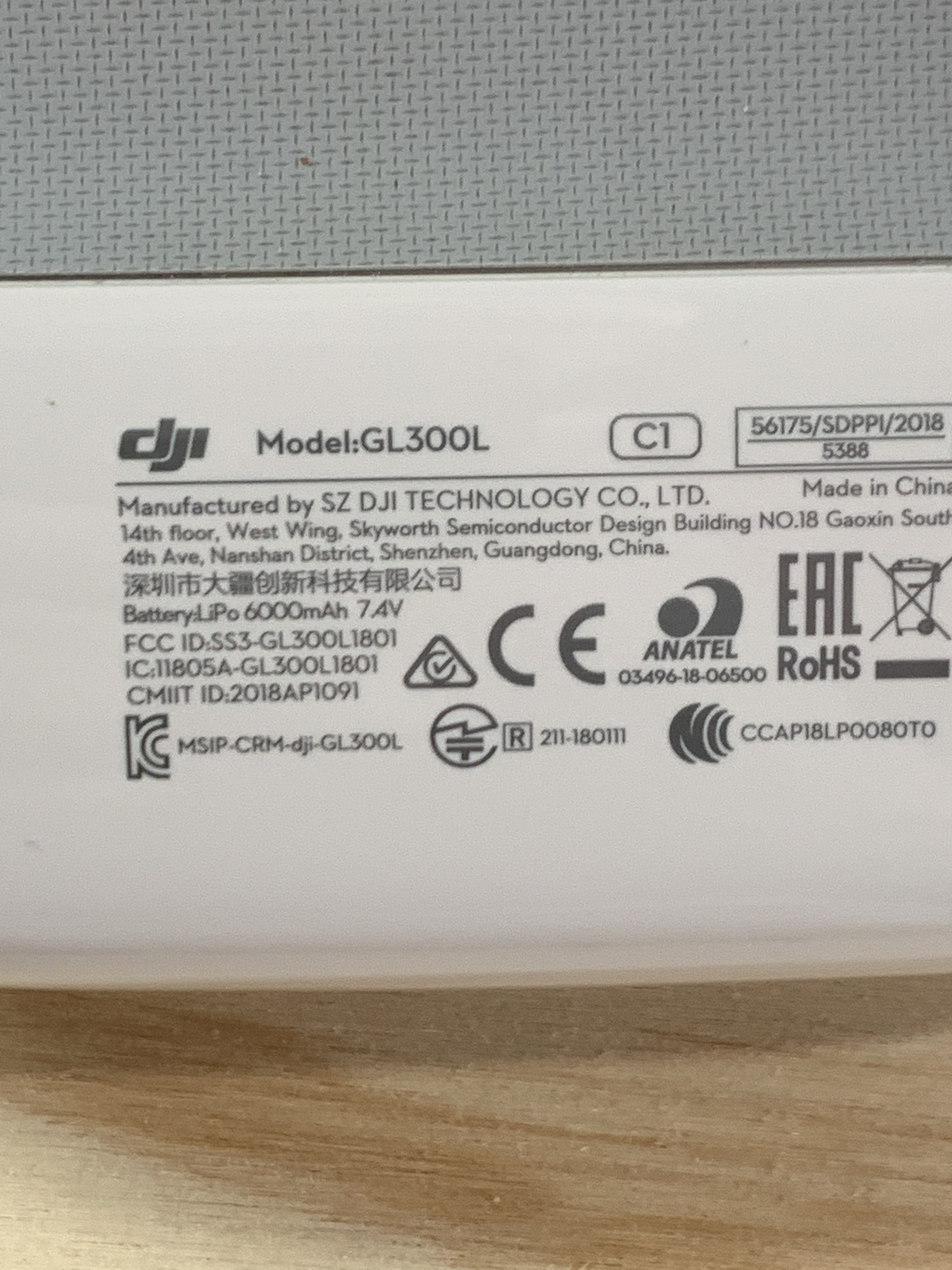

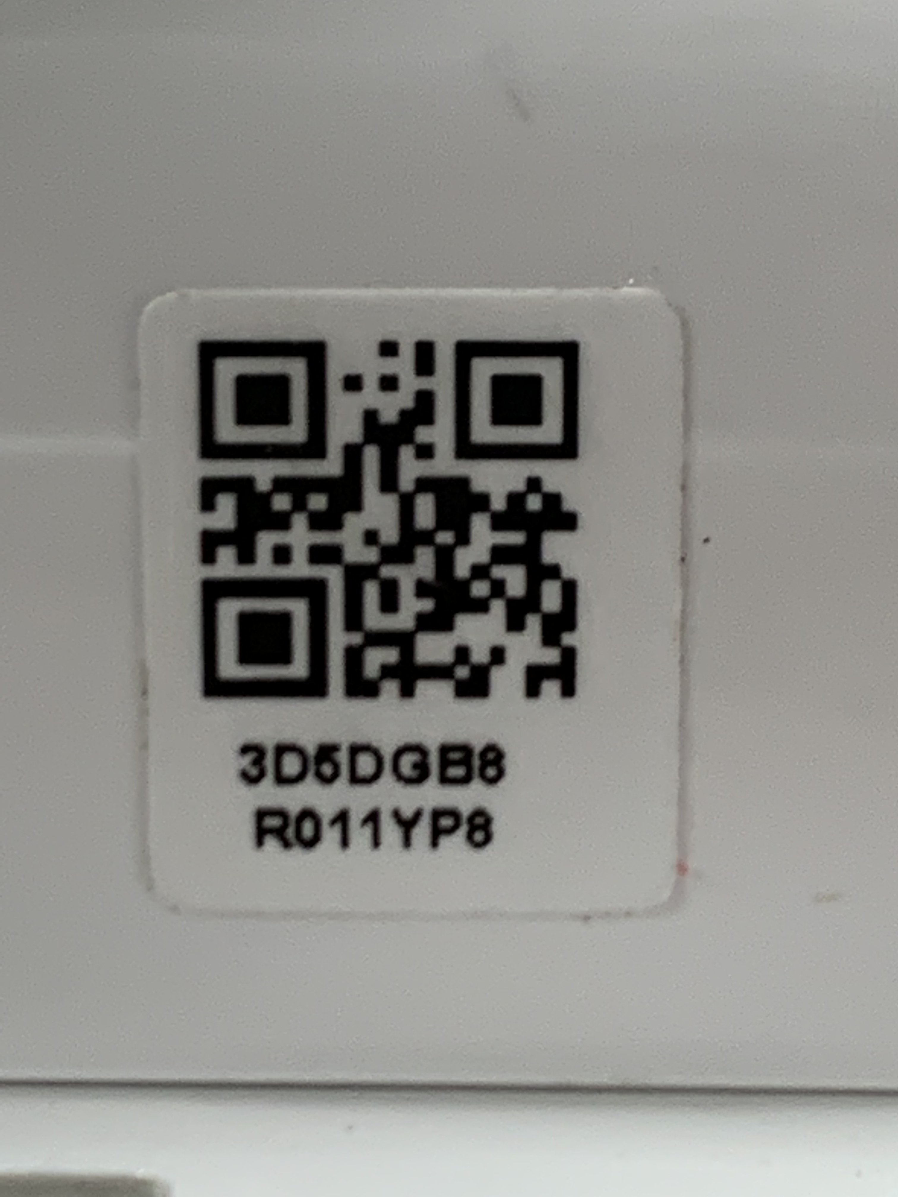

Just ran into this. The GL300L is the model, but it must be factory loaded with the firmware. The difference is a little logo on the front. I now have a spare controller I can’t use with my 4PM. See attached
Someone correct me if I am wrong.

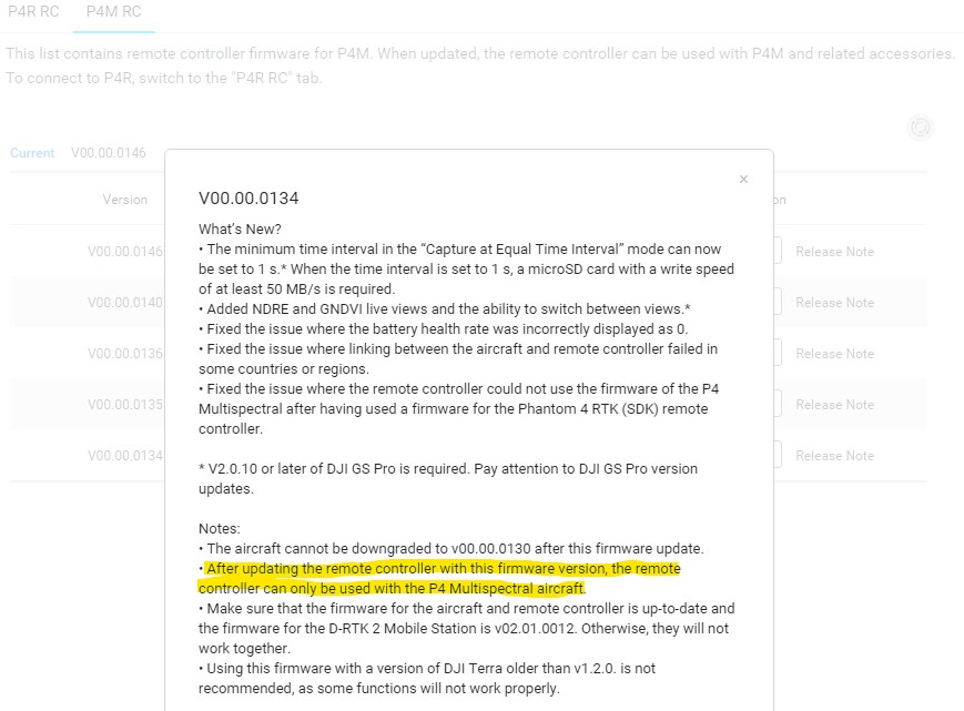

Hi all, thanks for the reply and yes, I can confirm now, too. A GL300L belonging to P4Pv2 is not compatible with a enterprise product like the P4RTK. It is confusing, because DJI uses the same model name (GL300L) in both cases... But only a GL300L that was bought together with a P4RTK or is specifically built for that (and has the little logo mentioned in L D&Ds post), will be compatible. I am using now a GL300L controller belonging to a P4M with the P4RTK. That works even tough in the release notes of the GL300L firmware updates it says that this is not possible (see picture attached).
I think DJI really made a mess regarding controller compatibility or at least is failing to provide clear information about that.
Many greetings and thanks again!
