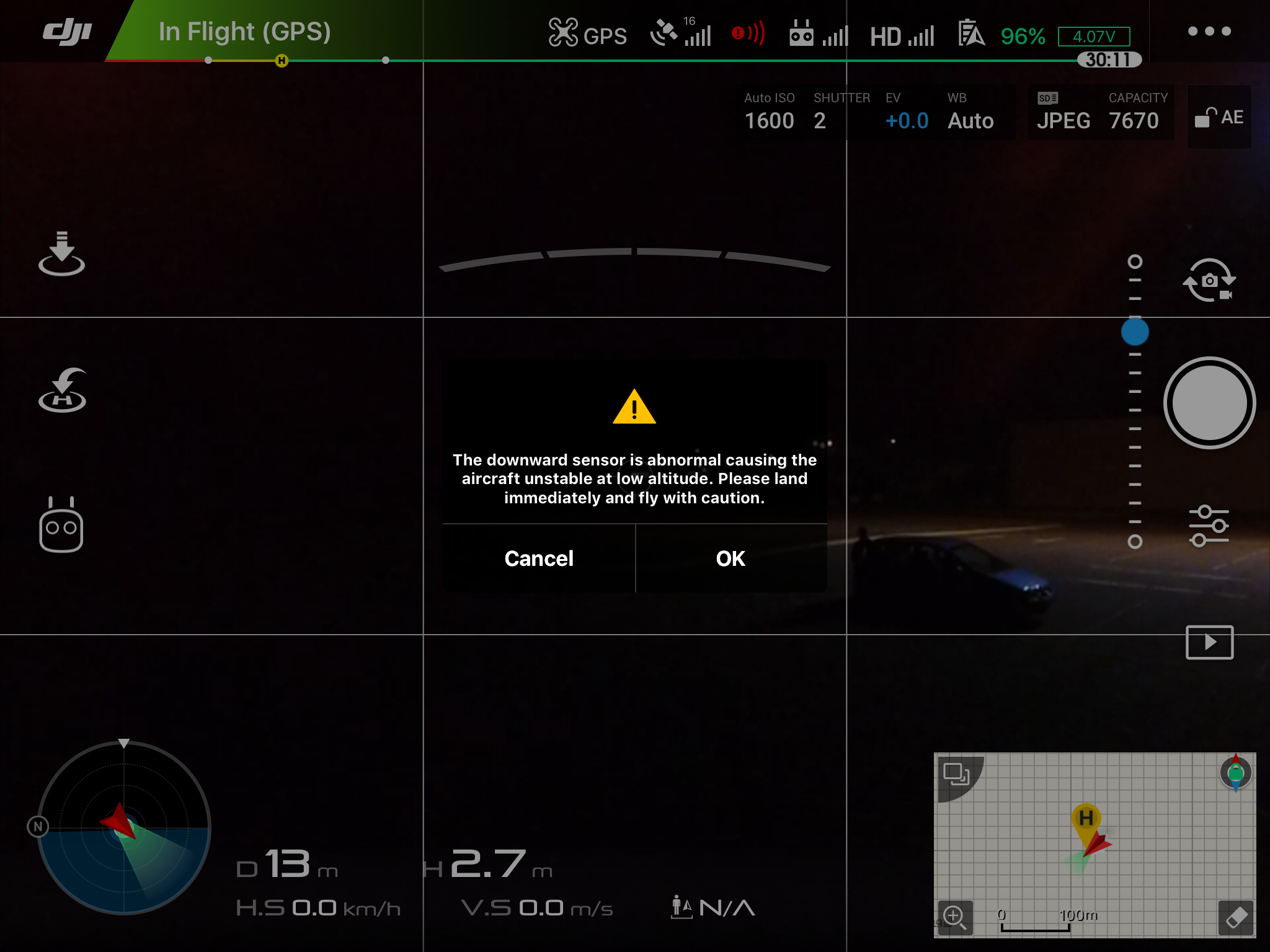

View attachment 99293 I had this come up on my P4 after doing the lastest update, a tried doing an IMU calibration but did not fix. Any other pilots out there ever had this message come up and what you did to fix?
If you have anything partially blocking your downward facing sensors, you will get problems like this.I added the landing gear stiffener and got the same error, if you don’t have anything on your gear interfering, try a blast from a “can of air” duster or soft brush on the sensor.
