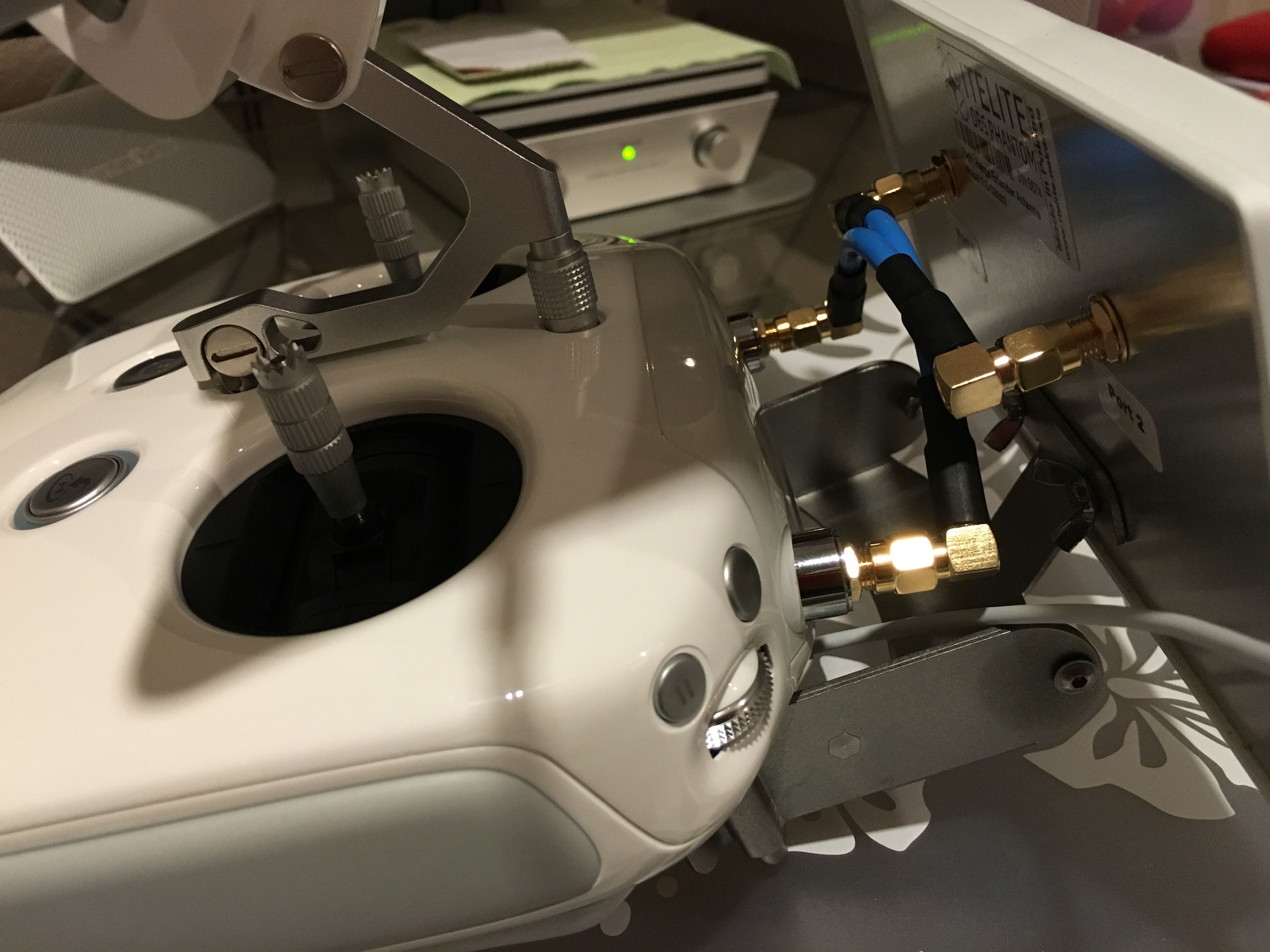

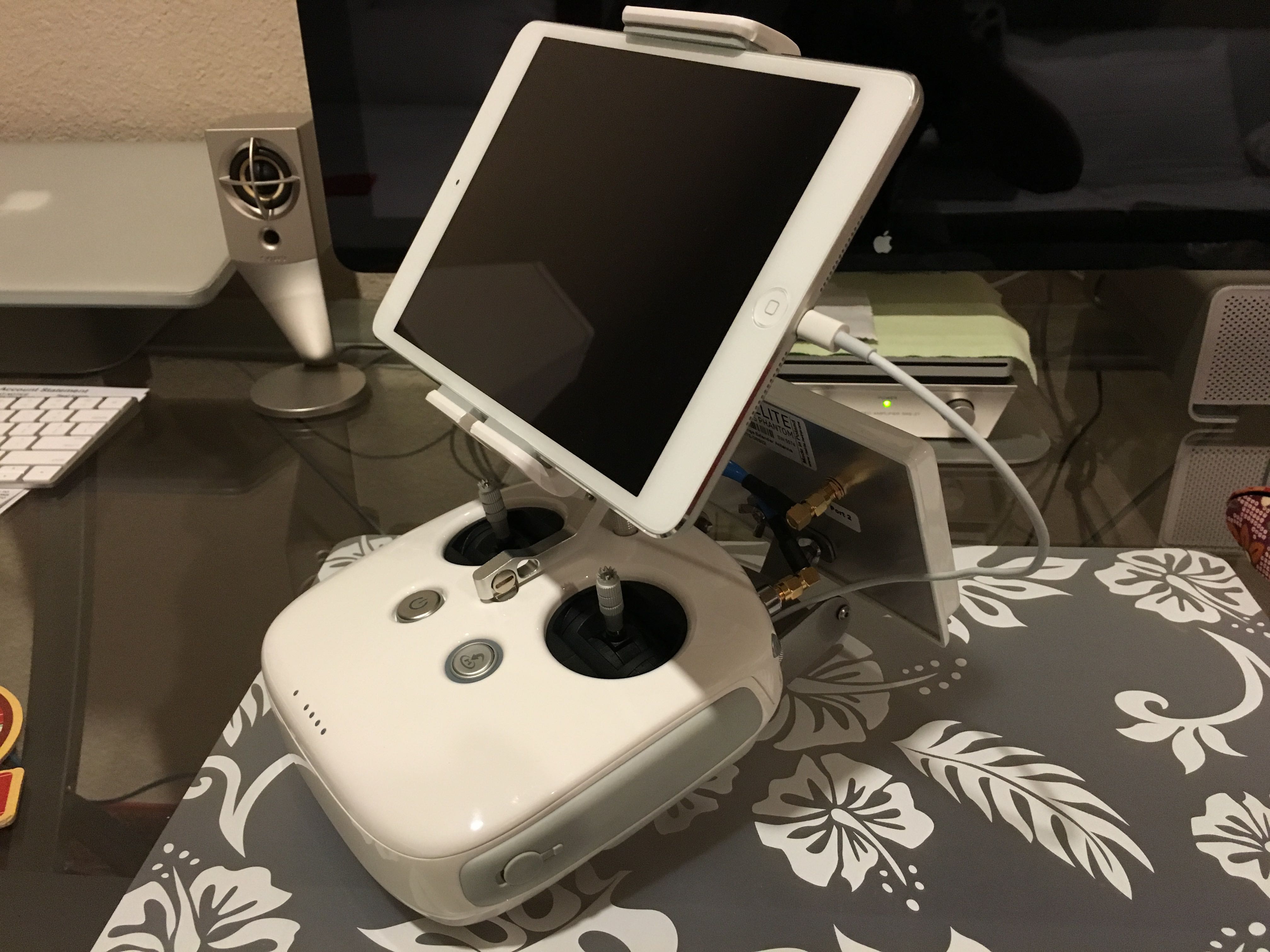

Jake, the clean install went flawlessly! Thanks for putting up the install video. It was a tremendous help. Check out the post surgical upgrade on my P4 Controller! Waiting for the second kit to do more surgery on the P3P Controller.
Reactions: JakeMaxxUAV
Yep just like mine! Just need a iPad Pro 12" on there!
