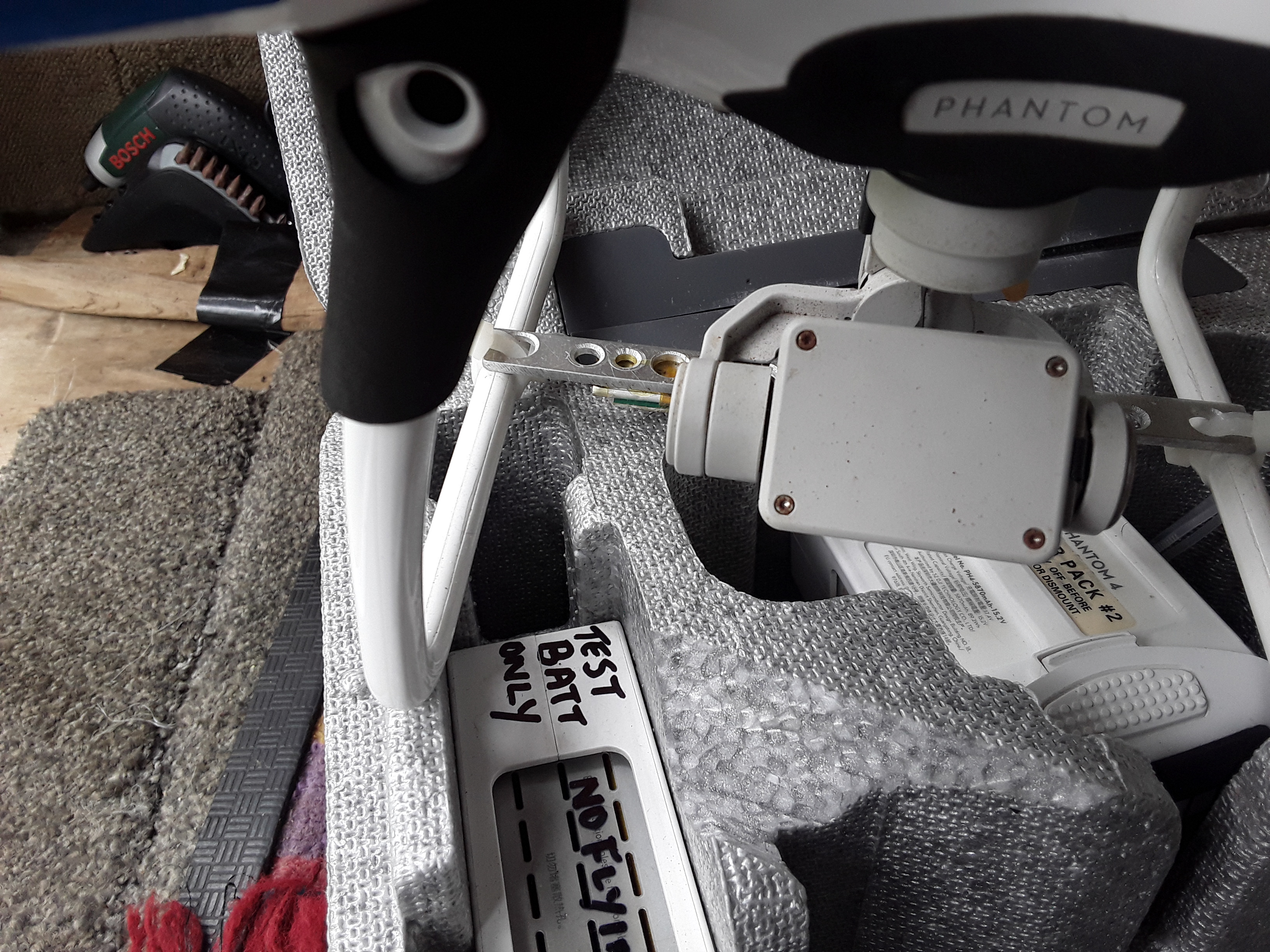

Yeh I'm getting to that stage with a fairly new p4 just from flying our coast and out over water,,screws on back of my camera are going rusty,I hate to think what's on the inside,I might use one called WD40 or mayby a silicon spray to help repel any salts and just looking that time be very soon or I wont be able to undo a screw cause its getting bad
Yeh I'm getting to that stage with a fairly new p4 just from flying our coast and out over water,,screws on back of my camera are going rusty,I hate to think what's on the inside,I might use one called WD40 or mayby a silicon spray to help repel any salts and just looking that time be very soon or I wont be able to undo a screw cause its getting badView attachment 116956
Ian you might want to replace those screws before they get any worse if you can find any around still wont help if any moisture is getting inside
Yes agree the whole thing needs good clean after further inspection, I got grit and dirt in everywhere,its been busy lately ,the coast is hard wearing on these all the dirt and salts in the air..lucky I have dead p4 I can get some off

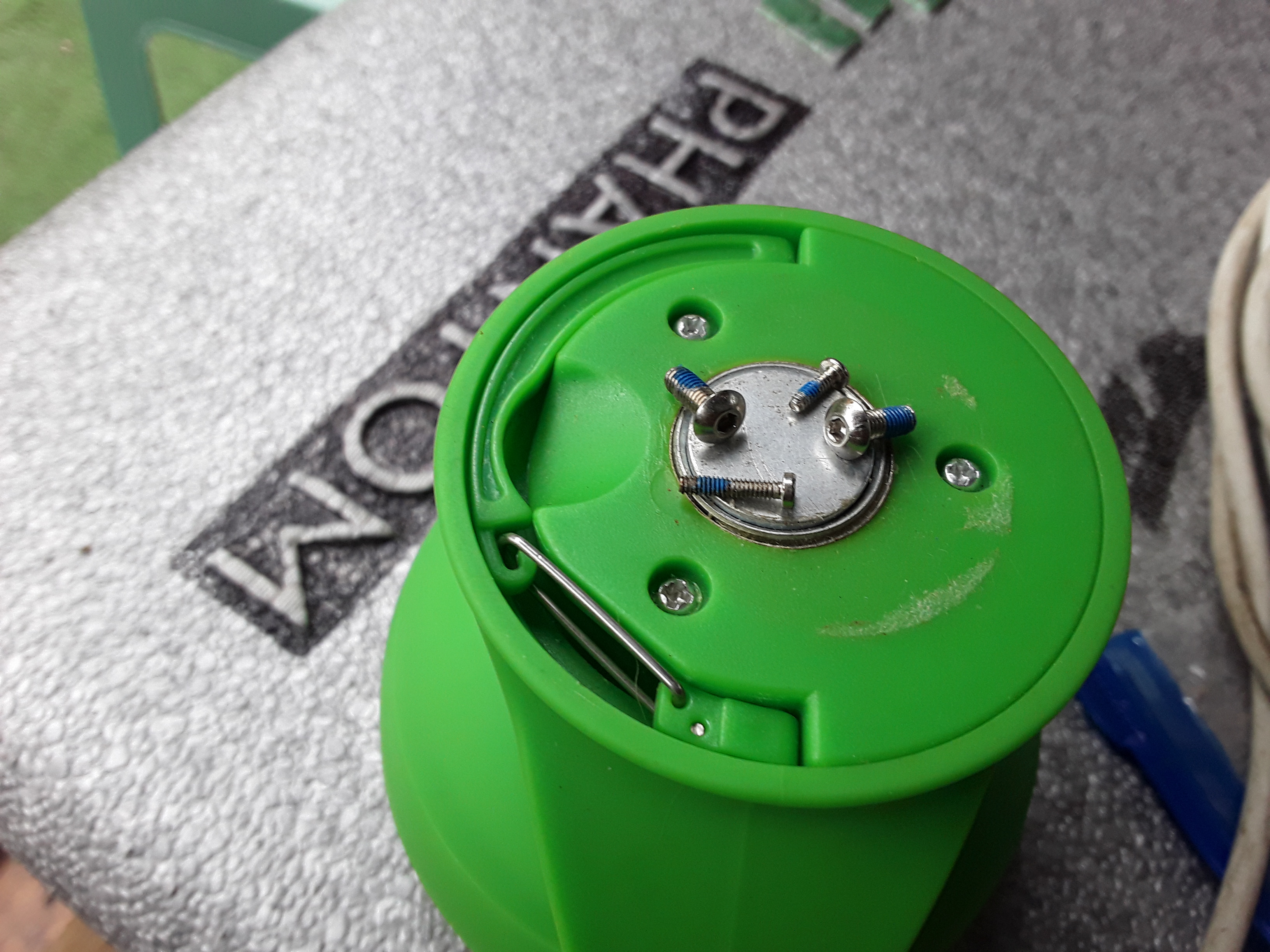

I do have some other from another p4...all phantom screws look chrome plated and are highly magnetic not stainless,,presume it keeps the cost of production down View attachment 116959
They are stainless but a low grade with lots of carbon and not a lot of nickel. Even my stainless fishing knives are magnetic. I also replaced the camera screws but the insides were fine. At least you got the wetsuits.
Are these screws zinc plated or are they stainless?
They are cheap, Chinese stainless. (less chromium). A salt air environment is hard on delicate electronics. Haagar13 is spot on. I worked in the marine industry for 30 years and learned how to defend equipment from the harsh salt water elements. Many years ago I took my Yamaha 250 Enduro to the beach for a "play day". After I got it home I had mild rust stains on EVERYTHING, plastic and all.
When I check out a camera to purchase on eBay, I do NOT even consider water damaged units, no matter how cheap they might be. It just ain't worth it.
