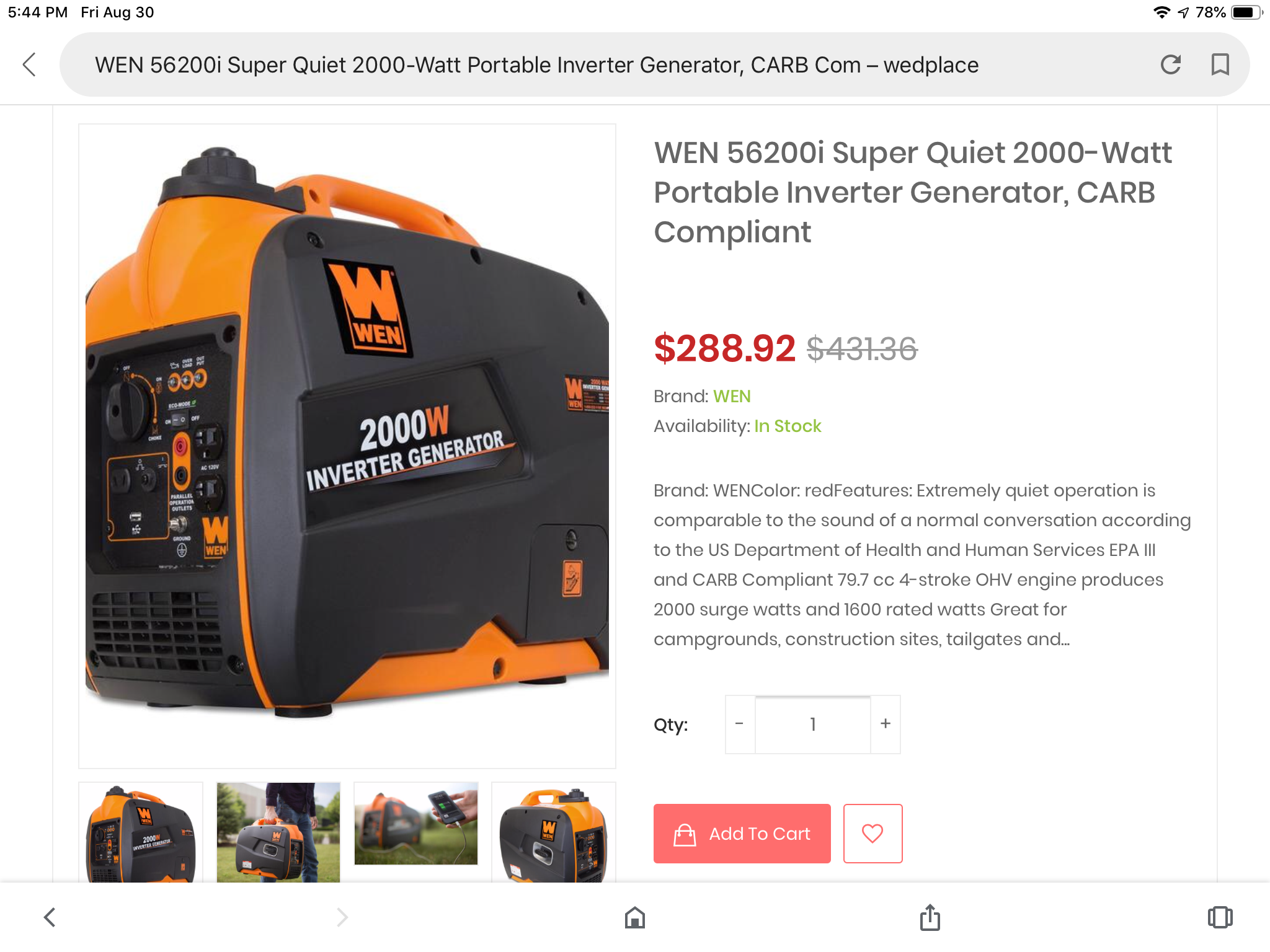

Could Not pass up this deal. WEN 56200i 2000W for $288.92 Shipped!
I know it’s bigger than needed, And will arrive too late for this hurricane. But it’s $50 less than the 1250W and $150 less than the regular price at most sites.
The 2000W is 8lb heavier than the 1250W but it will get used at home and on the road. ??? 1250W sold out even from factory. Hurricane watch.

Wow Capt! where did you score this deal?
Harbor Freight. Done. You're welcome. ;)
