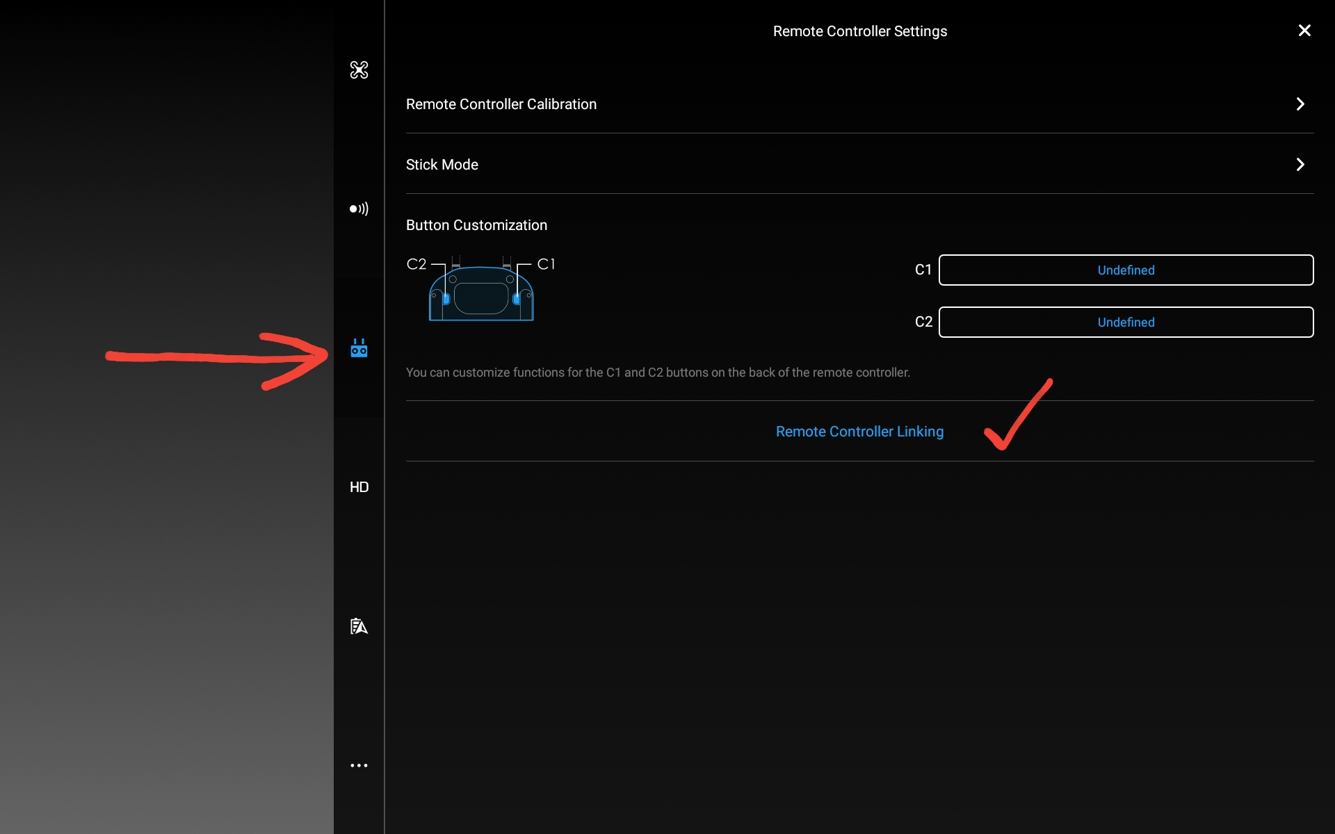

Ok losing signal as in RTH happens or still have control but live transmission is lost,,see if relink will bring it right,
Did relinking help ,,this makes sure it paired nicely,,what onscreen prompt do you get when it happens,,aircraft disconnected,,
Really sorry to sound like a massive novice here, I guess I am though. But can you please describe relinking to me, and how you do it etc
Ok power all up,,go into general settings under the RC logo,,once you press link rc it will star beeping till you press the flashing link light bottom of drone,,it gives you 60 sec to do this or it times out and you have to start again,,,,follow prompts it's very easy and I been here for while and still learning so dont be shy with any questions

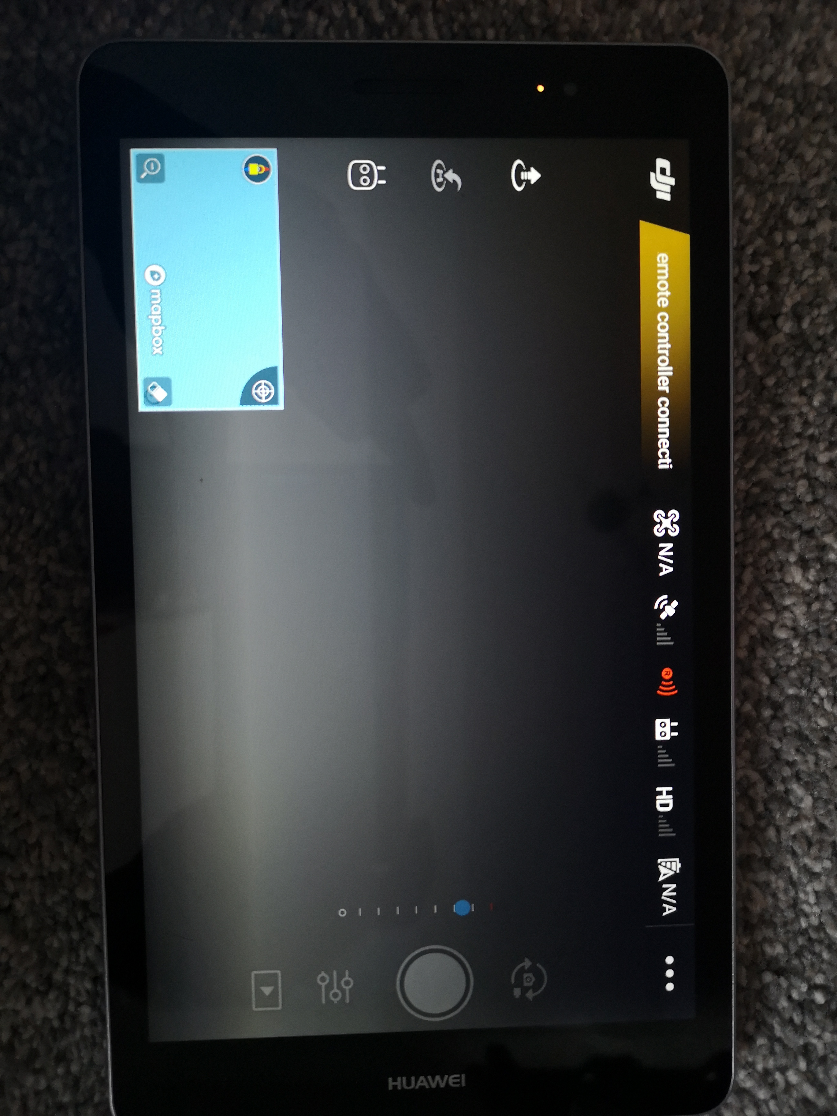

Now I am getting remote controller connection error.
It also won't let me do the linking until I confirm frequency settings and I don't even know what that means.
Any suggestions?

So to update: I updated the firmware, relinked the control and drone, oriented the aerials better and tried it in a wide open space. I periodically got weak signal above 200m, and aircraft disconnected completely just before 300m. Improvement, but I believe less than its supposed to be
