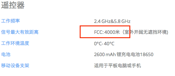

The SE is not officially sold or supported outside China. The power level from factory is outside CE and FCC limits.
Nope, that's incorrect.
The power level is FCC. (On it's website, the Chinese specs says "Remote Control -> Range: FCC 4000 Meters"
(source:Phantom 3 SE - DJI大疆创新)

Silly ***** .... you clipped the actual statement !
It says :
working frequency 2.4 GHz & 5.8 GHz
The maximum effective distance of the signal FCC: 4000 m (outdoor unobstructed environment)
FCC in fact does not stipulate distance so the addition of FCC to the sentence is worthless.
What it does NOT say is Power Level DBi which FCC sets... which all others do such as P3S ....

According to DJI's P3SE user manual (page 48):
https://dl.djicdn.com/downloads/phantom_3_se/Phantom+3+SE+用户手册+V1.0.pdf
  • Remote Control Tx Power (EIRP) FCC: 19 dBm; CE: 14 dBm
  • WiFi Video Tx Power (EIRP) FCC: 27 dBm; CE: 20 dBm
As you can see the power outputs are exactly the same as P3S.
The only difference is P3SE has the same landing skid antennas as P3P, and the range is boosted to 4000m. Of course, the 802.11 Wi-Fi reconnect is much slower than the proprietary lightbridge version, and you don't have access to the 32-channel hack.
