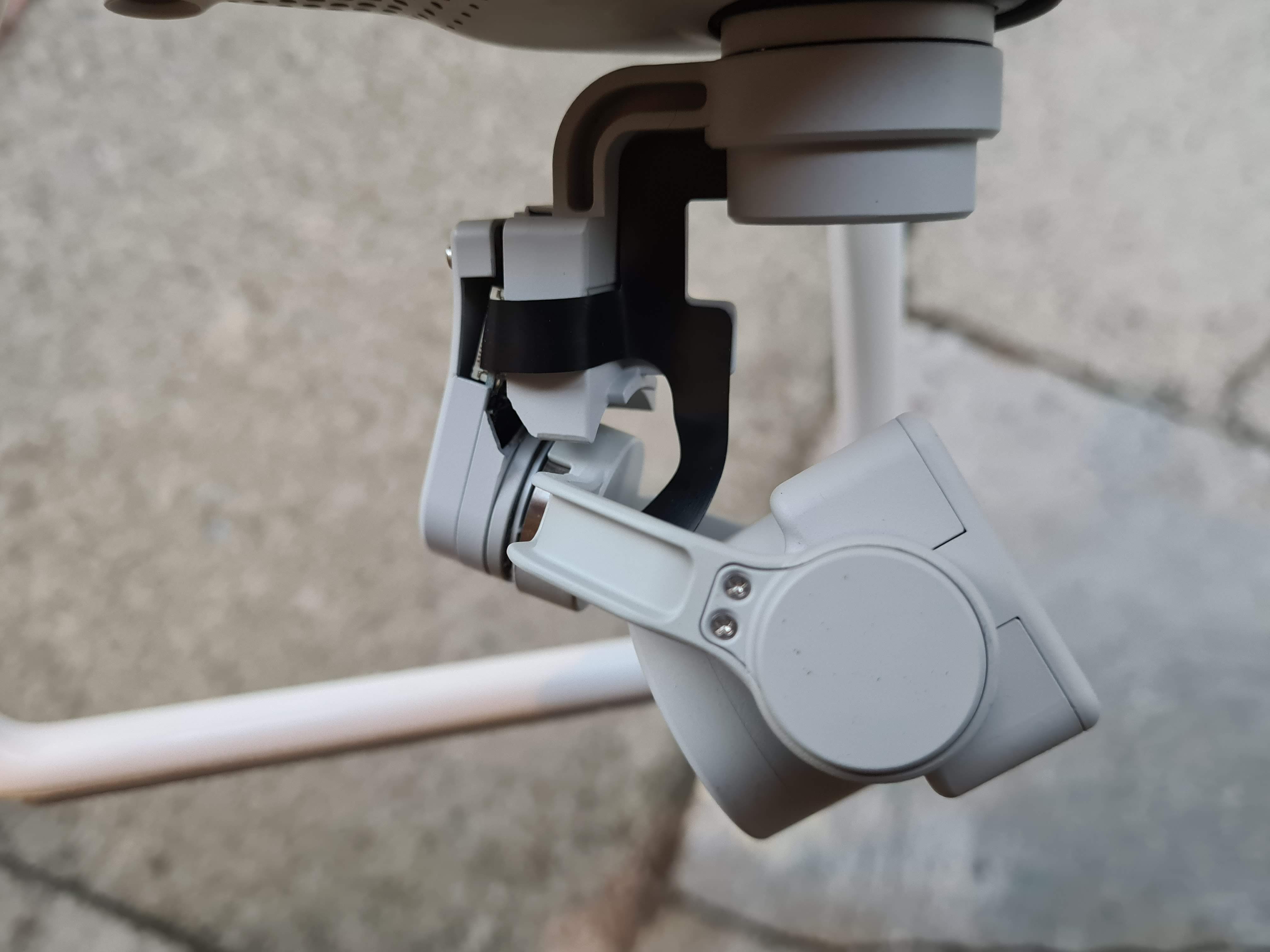

Hello all I am new here, I have Phantom 4 which was damaged, the battery was dead and a gimble frame had a crack.
I have now replace both of these, and I can now fly the phantom 4. taking it out for the first time, I noticed that picture shakes.
any advice and what this could be?
Test flight link here
Motor and this bracket.

Could you explain to me which one is the roll motor or is there a link to replacement of one?

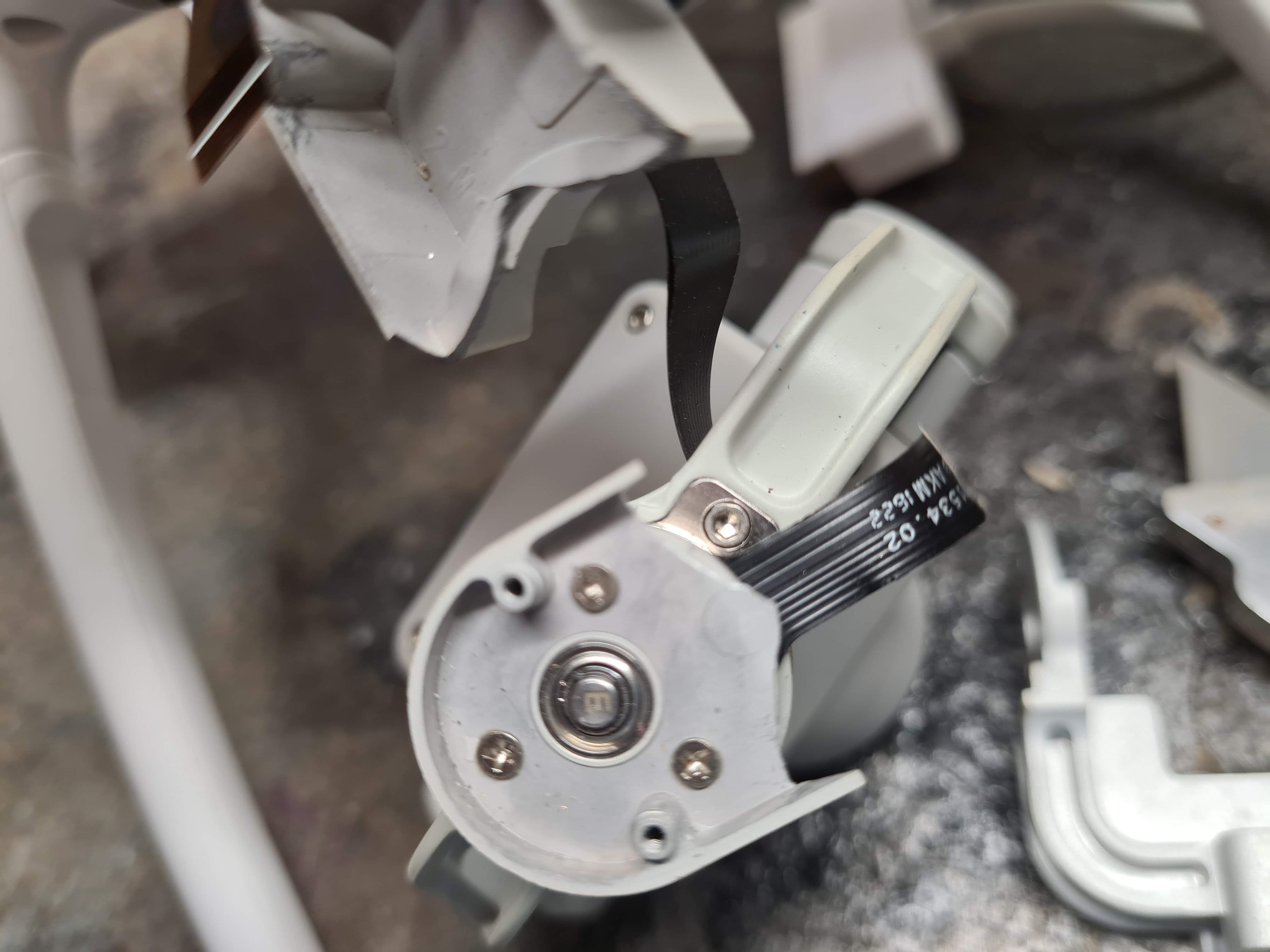

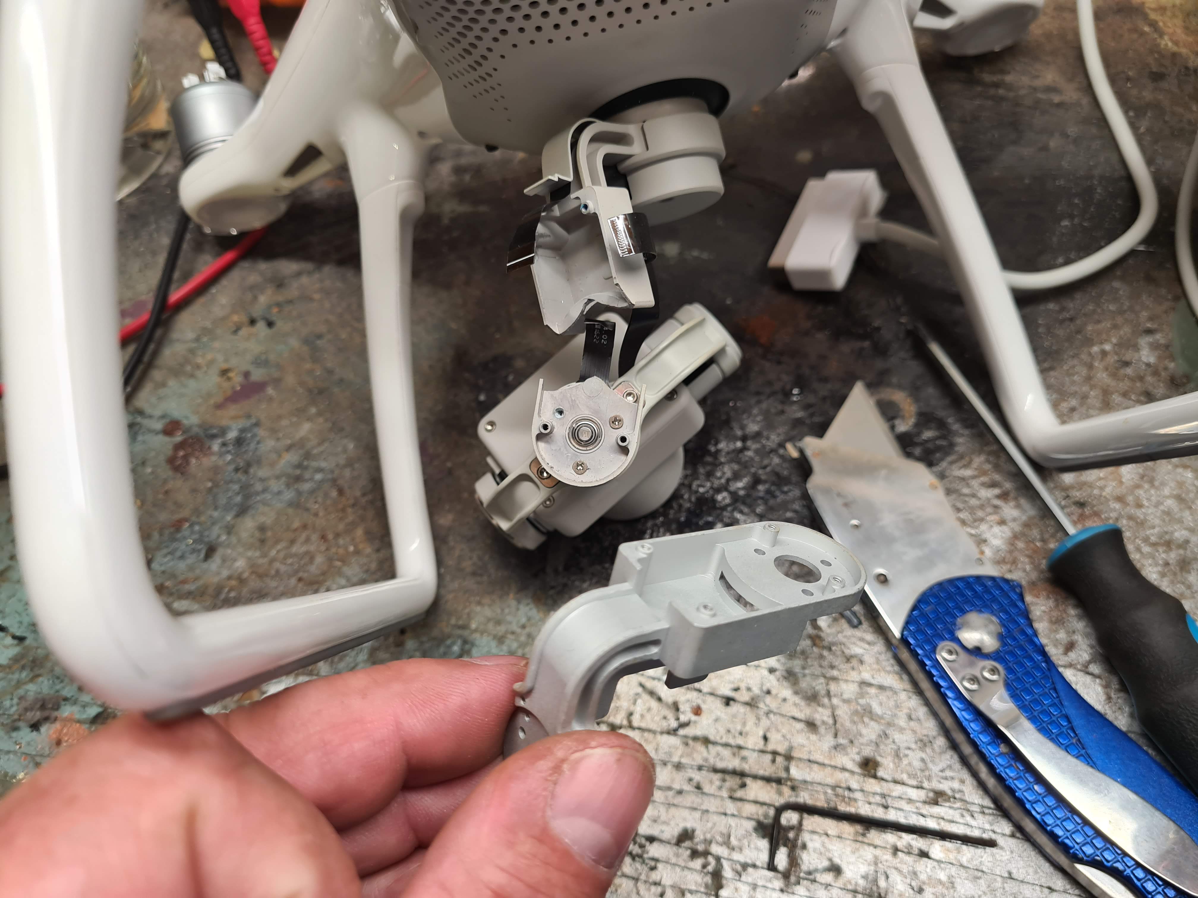

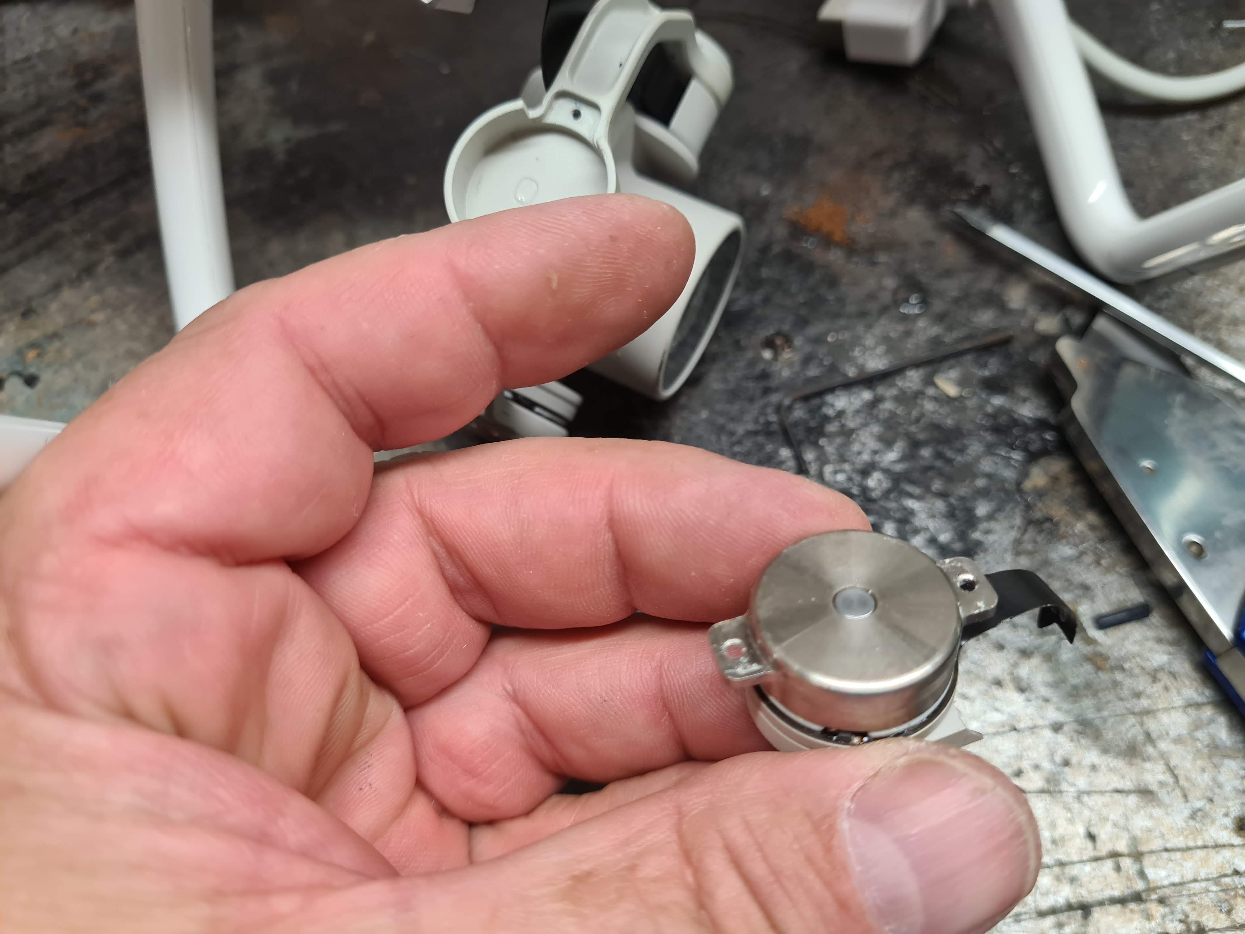

There is a good chance if your Gimbal took that much of an impact your yaw motor, which the Gimbal literally hangs off will have sensor damage. I had a heavy landing and my Gimbal just rocked gently from side to side. It wouldn't calibrate all the way through it's cycle. I replaced the Gimbal Yaw motor, but used the old outer casing which is calibrated by DJI. Sorted for around £35.
Theres a good video on replacing the Yaw motor on YouTube which explains about swapping old onto new. I looked at my damaged Yaw motor with a USB microscope and could actually see where the forward impact had forced the outer casing into the armature and chipped a piece of off the tiny position sensor, result, the motor couldn't find it's centre position and just rocked back and fourth hunting for the damaged sensor.

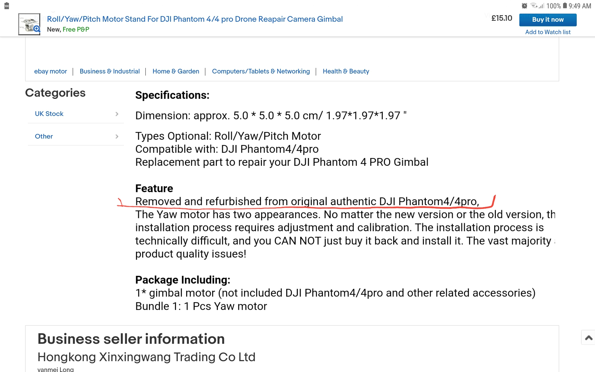

This appears to be a P3. are you sure the motors are compatible with a P4
After reading this says it came off a p4 ,,,,what country you in,,,I'll see if I still have my old p4 ones,,,I can mail it out if you are unable to get one local,,maybe someone closer than NZ will help you out with one,,if not and if mine looks ok I'll send it at no charge,,I dont have p4 at the moment but happy to help
I agree that it says it came off of a P4. but the photo in the ad showing a P3 would concern me. Maybe DroneTed or another expert can verify whether the motors in a P3 and a P4 gimbal are interchangeable, or that the picture of just the motor is a correct P4 motor.
I just worry when I see an incorrect photo.
Ha I did read before I had bit of a look at picture,,wonder why they do that,,easy enough to take photo of p4 gimble,,typical Ebay add,,,,!,

I am now going to replace the Yaw motor on my P4
I was looking on e-bay at these two and note that the numbers on the ribbon are different, how do i know i am getting the correct one or do i need to strip my own down first
