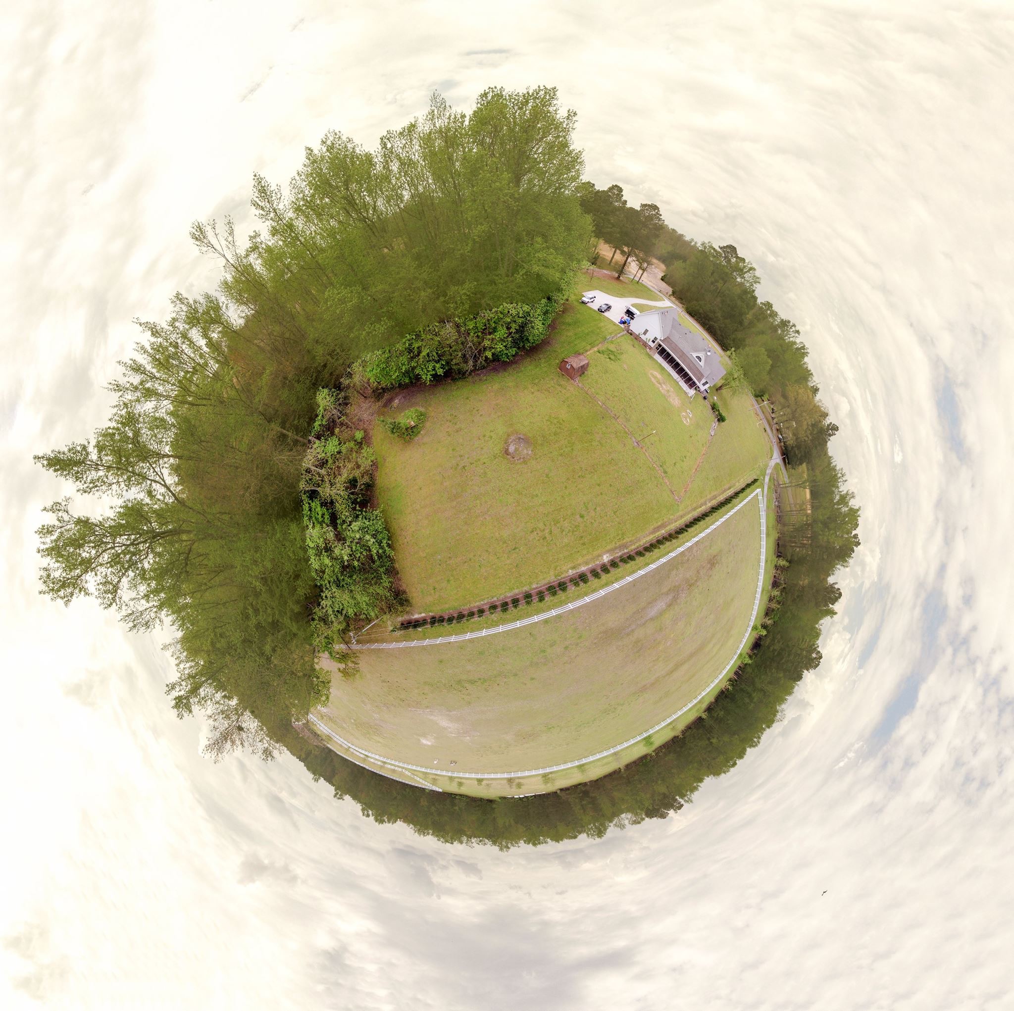

Ok so here is a LIttle Planet I just did. I used ICE to stitch it all together and used lightroom 6 to edit it. If you take a look around the entire tree line its look very fuzzy and the bottoms of the trees look perfect can someone explain this thank you.
Reactions: Richard Gozinya
View attachment 51468 Ok so here is a LIttle Planet I just did. I used ICE to stitch it all together and used lightroom 6 to edit it. If you take a look around the entire tree line its look very fuzzy and the bottoms of the trees look perfect can someone explain this thank you.
Do your still pics look fuzzy at same locations? How many pics and rows?

The tops do look fuzzy in the still pics but its not as noticeable as it is in this pano. It was a bit breezy when I decided to do this Pano maybe the breeze threw it off. not sure how many rows but its a total of 25 pics using DronePan to take this pics.
When you take panorama photos, try to avoid movement. Any movement between shots will become blurry because the stitching software will have to blend the differences.

I took another panoramic this morning using dronepan and ICE to stitch the 25 photos together. 0 wind and a beautiful morning and I got the same results as yesterday. Here is the photo. I took the photo in almost the same exact spot to replicate yesterday's photos
