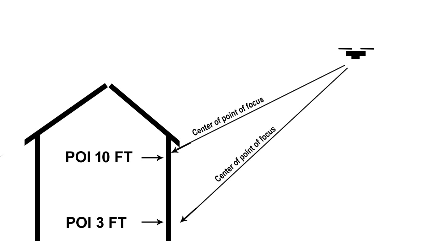

Thanks Steve, i have been trying in videos but so far no luck as to the explanation of what the altitude on a POI does? I'm confusing it with the Attitude of the waypoint, the way point makes sense but what does the Altitude of the poi do?

Think of the POI altitude like this: There’s a fencepost with a pumpkin on top of it. You want the camera to aim at the pumpkin. If the pumpkin on the post is six feet off the ground, set the POI altitude to 6 feet. If the pumpkin’s 30 feet off the ground, set the POI altitude to 30 ft. (This is, of course, assuming your flying over level ground).

ok setting the POI Altitude, whats the effect then? say i have a house, i want to set it to the height of the hose? and if i set it to only 3 ft what would the effect be?

The focus point of the camera would be a spot three feet up the wall (assuming level ground, etc.). I’ll try to post a diagram shortly.
